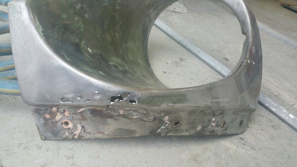

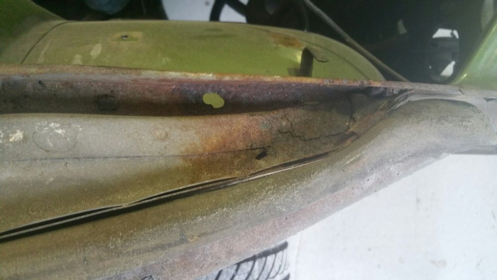

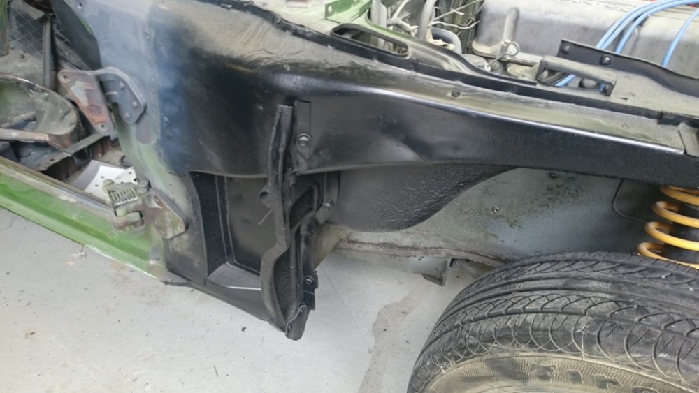

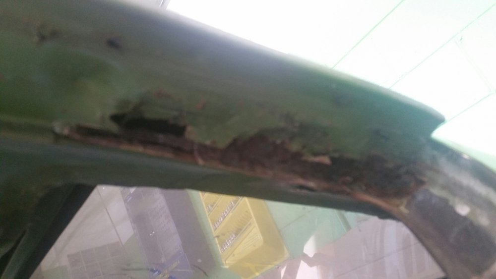

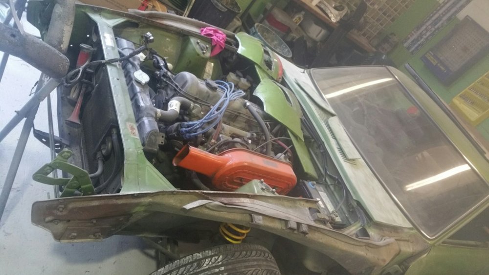

andyk_79 Posted December 2, 2015 Author Posted December 2, 2015 Paint is coming off and the first batch of photos has been emailed to me. Must say I'm disappointed at how it looks underneath, given it didn't look too bad and was sold to me as having good body, but feeling much more that I made the right decision. Glad I didn't just finish off the minor stuff only for this to start coming through........... Quote

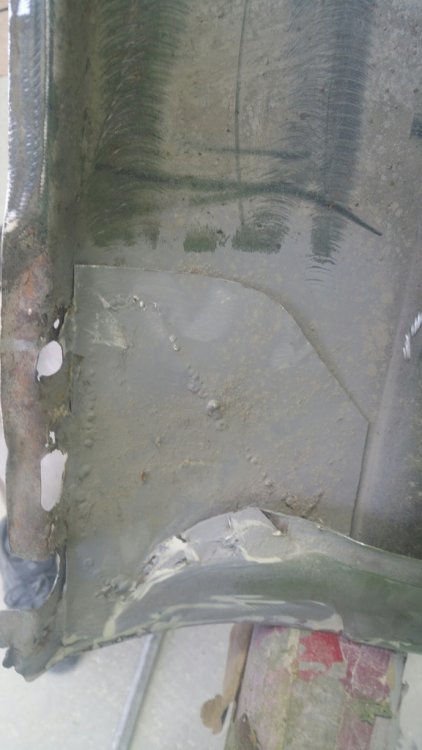

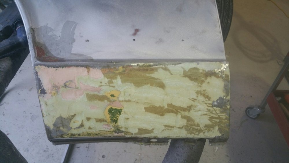

Administrators gav240z Posted December 2, 2015 Administrators Posted December 2, 2015 Must say I'm disappointed at how it looks underneath, given it didn't look too bad and was sold to me as having good body, butfeeling much more that I made the right decision. Ummm that is a good body on an S30z lol...Sugar scoops are dirt cheap to replace compared with other panels. So I wouldn't be too worried about that. It also explains why the paint wasn't good on those areas. Is that last photo the lower valance at the front? People get awfully creative with bog. It always makes me wonder, using a hammer and dolly isn't that hard after all.. Front end looks very straight, I'd be happy about that! Quote

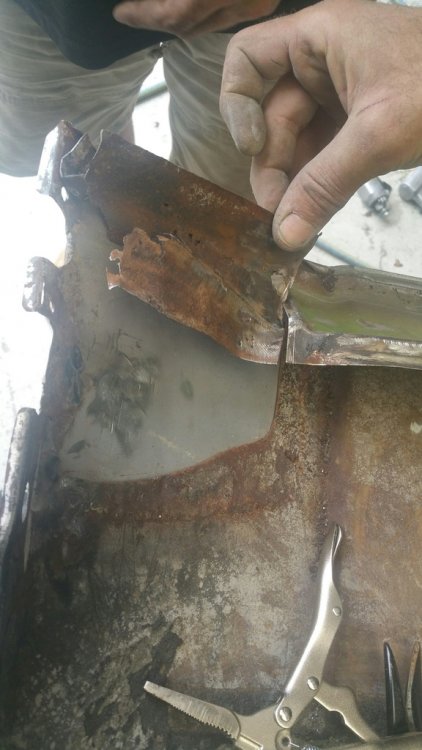

andyk_79 Posted December 2, 2015 Author Posted December 2, 2015 There's some more photos I'll put up later with some more rust but yeah I've seen worse. Was just disappointed from what the car was sold to me as. Not sure what bit the bog moulding job was on. Hopefully seeing in person on Friday if I can swing it with work. Quote
Administrators gav240z Posted December 2, 2015 Administrators Posted December 2, 2015 All part of the learning experience mate, it's just how it is with these cars or any classic car really. That's why a "properly" restored 240z is worth good money to the right person. Because from experience we know the difference between a quick fix and a proper restoration. I still think you got a good car for the money you paid for it and it could be a whole lot worse. Expect to find a few more spots here and there, but honestly the body doesn't look that bad so far. Quote
dat240z Posted December 2, 2015 Posted December 2, 2015 As Gav has said, its not too bad at all mate. Much much worse out there!! Quote

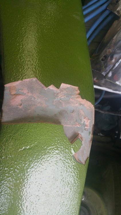

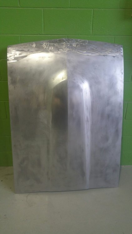

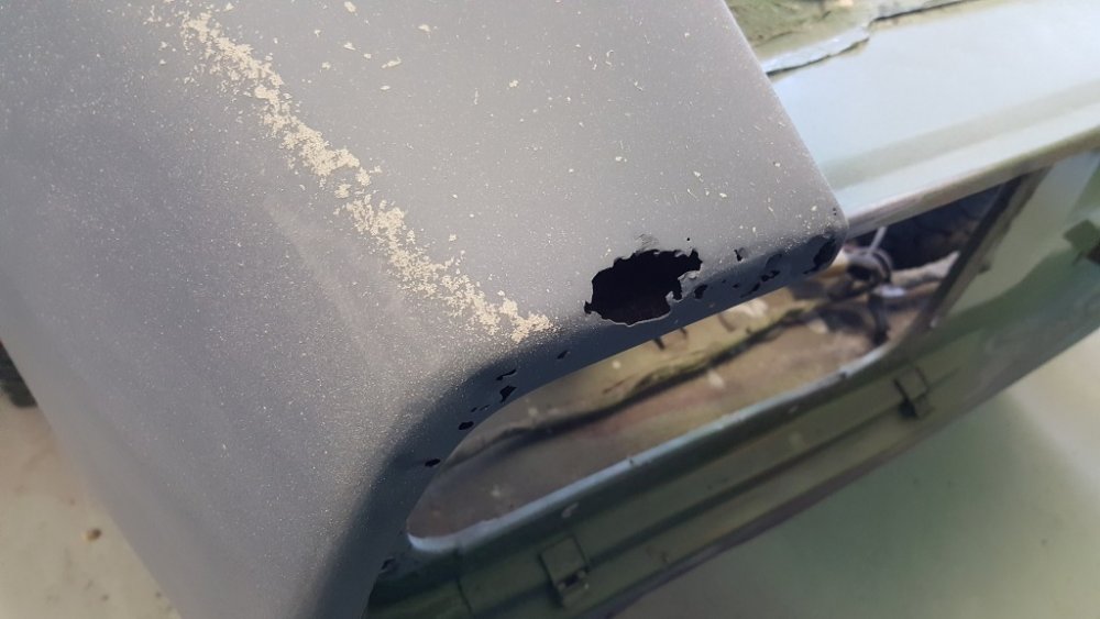

andyk_79 Posted December 2, 2015 Author Posted December 2, 2015 Some more: The bonnet however looks schmick: Quote
Administrators gav240z Posted December 2, 2015 Administrators Posted December 2, 2015 LOL @ the lower fender section. It's actually not that bad compared to what i've seen, why weld when you can super glue eh? You can order that section from Rare Spares or just fabricate it, 1 of the easier sections to fix. The roof will be the trickiest section to repair. Quote

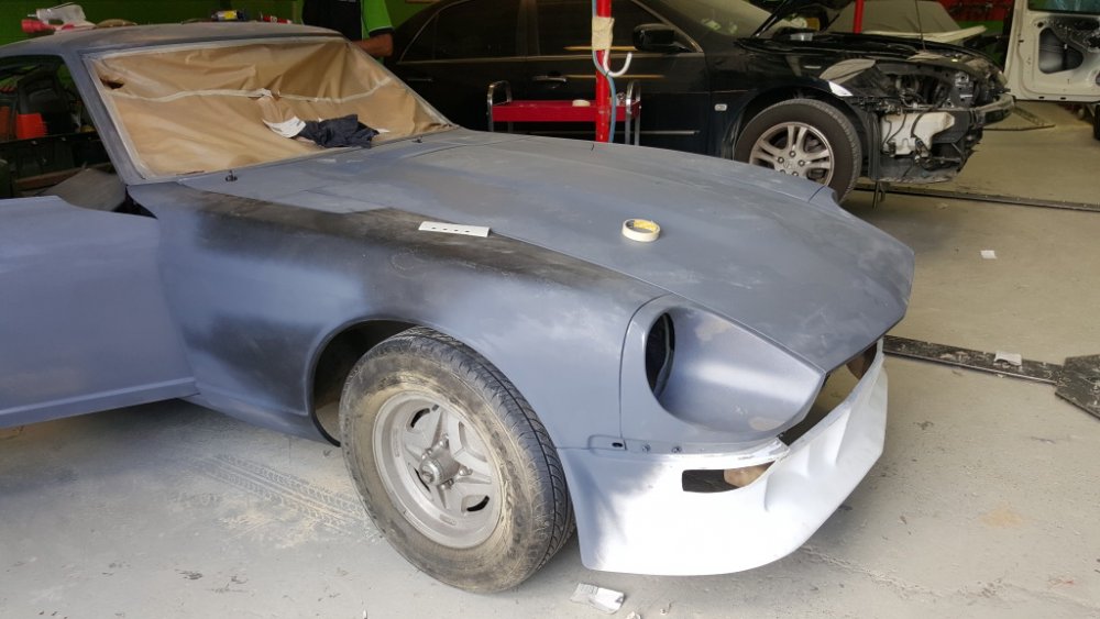

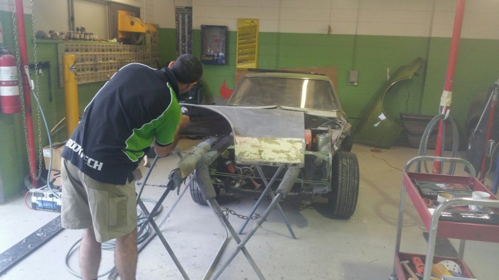

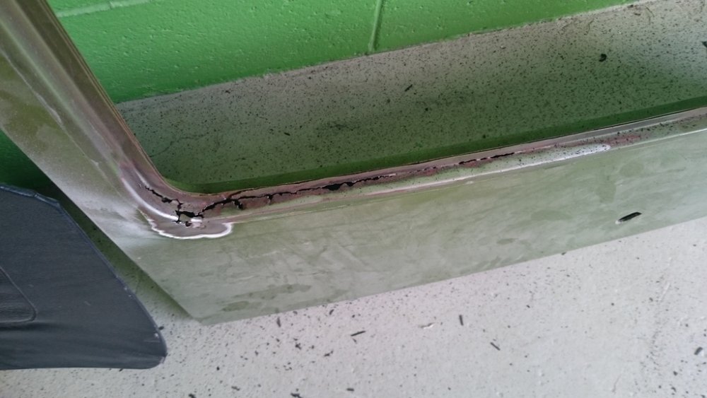

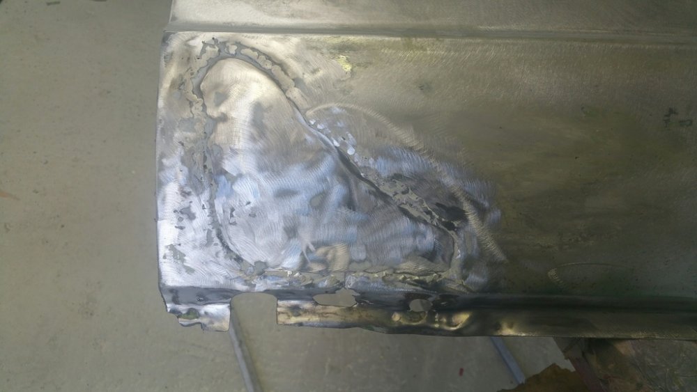

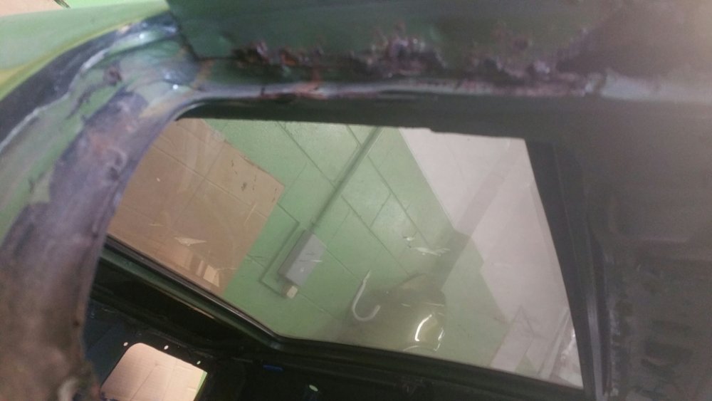

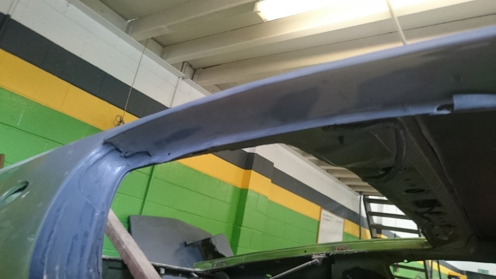

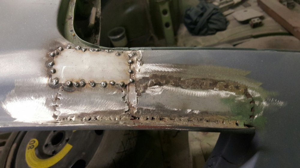

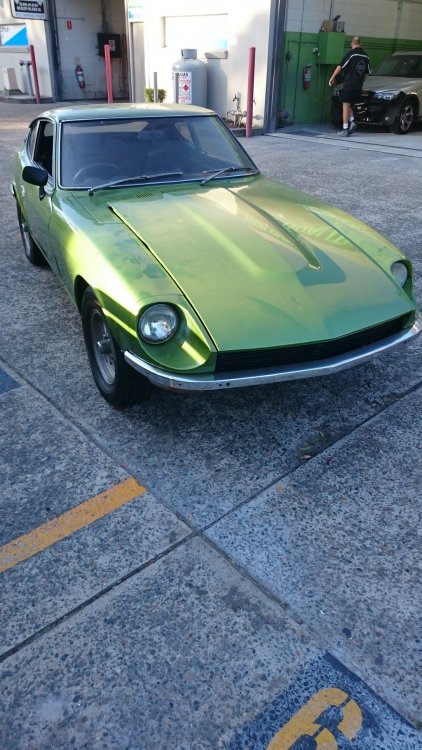

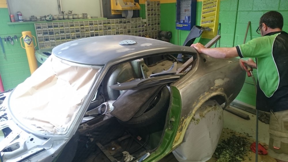

andyk_79 Posted January 15, 2016 Author Posted January 15, 2016 A quick visit to the panel beaters today to check progress, drop off a part (thanks again Matt) and pick some other parts up. Was excited to see progress being made. Doors repaired - I didn't get photos but one door had been gouged previously and seriously had been patched up with about 30mm of bog!! The guys were looking at the cost of replacement door skins but ended up doing the work to repair it rather an replace. They did a good job and were happy to sow m both sides of the skin. Repairs on front now finished and sealed: Shocking rust holes in quarter window frame had new metal welded in and primed: roof repaired and back half of car being worked on: Some interesting ventilation in the hatch: Interior work to start soon. My daughter recently: Do you miss Fern Daddy ? Me, choking back tears (not really ): A little darling...... Quote

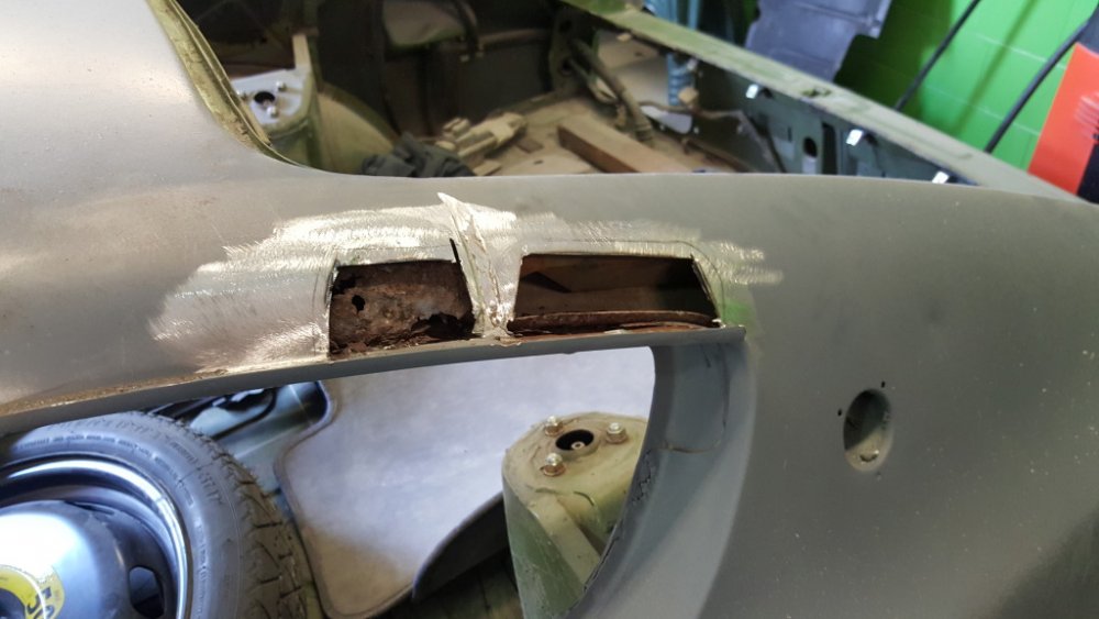

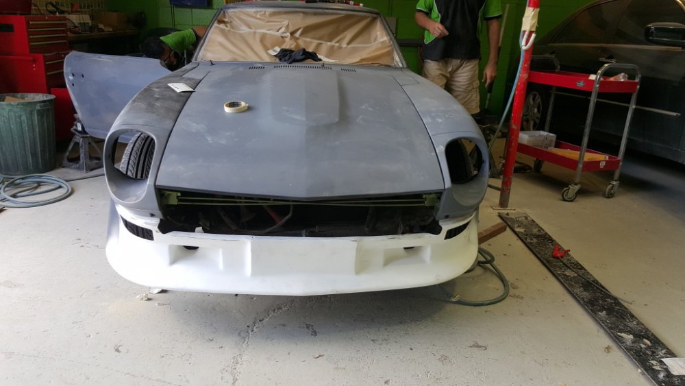

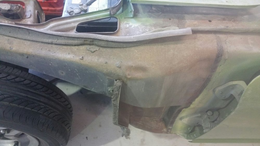

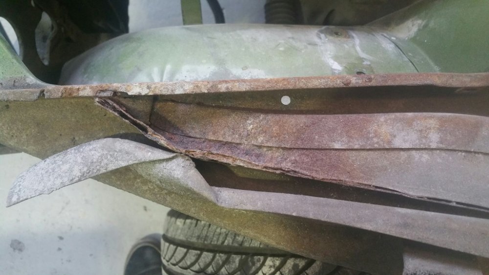

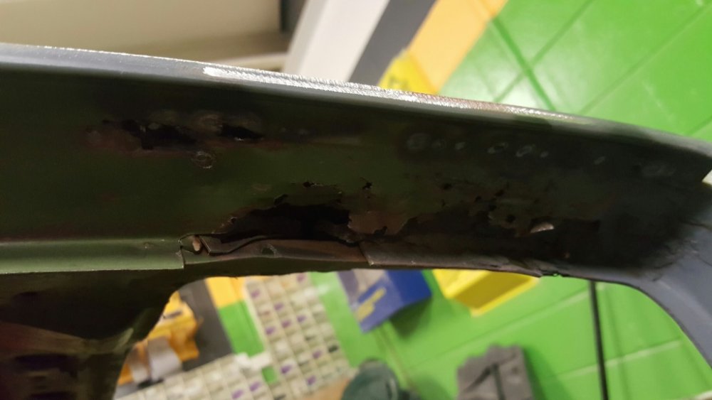

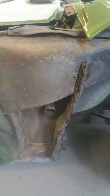

andyk_79 Posted January 21, 2016 Author Posted January 21, 2016 Car is getting high fill early next week and then knock back and paint booth the following week. Brake line issues getting fixed while the high fill sets. Panel Beater has sent me some more of the photos I hadn't seen: This one I think is the worst bit of the car I've seen : Under side of the same spot (I think): That's looking better: New front lip trial fitted. I know it is "boy racer" style, but it is my one concession to teenage me who fell in love with 240Zs and wanted one with the full flares etc: Superior ventilation around the tail lights: Quote
