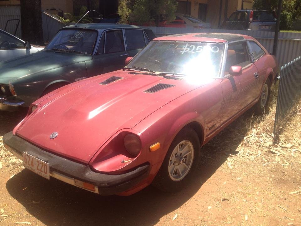

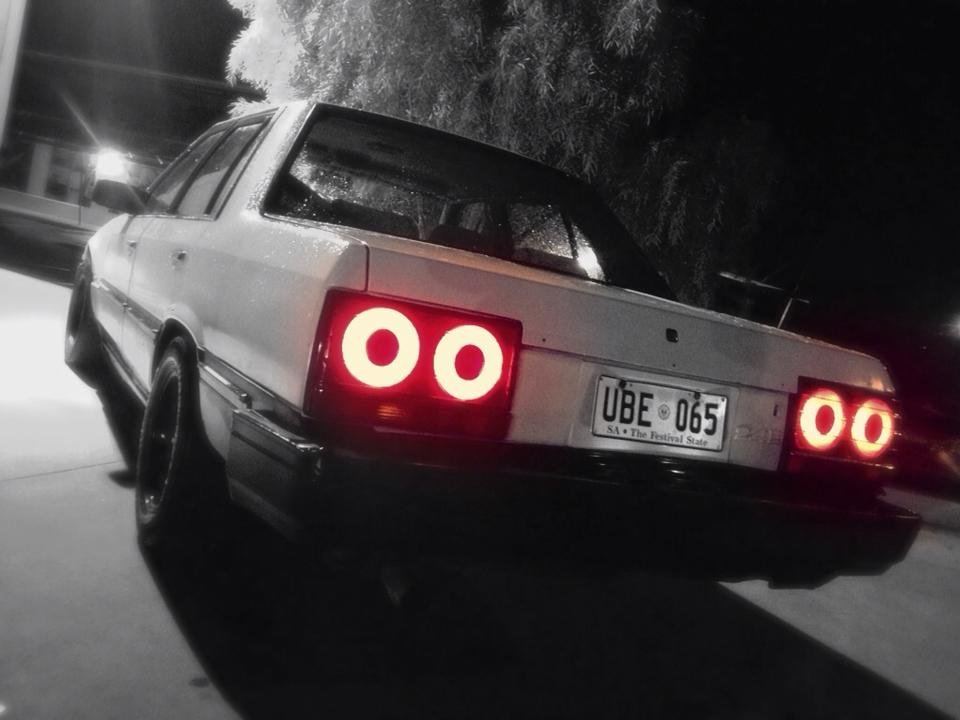

Jasonisa Posted March 28, 2014 Author Posted March 28, 2014 also for those interested this is the 280zx and my R30 Skyline when i got it all looks stripped now though Quote
