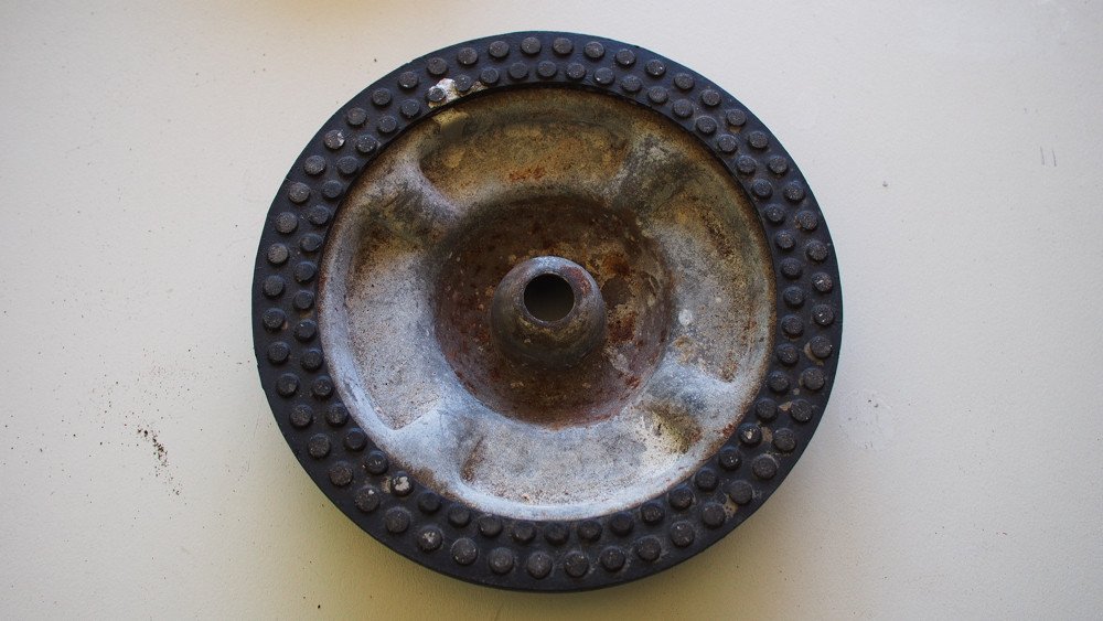

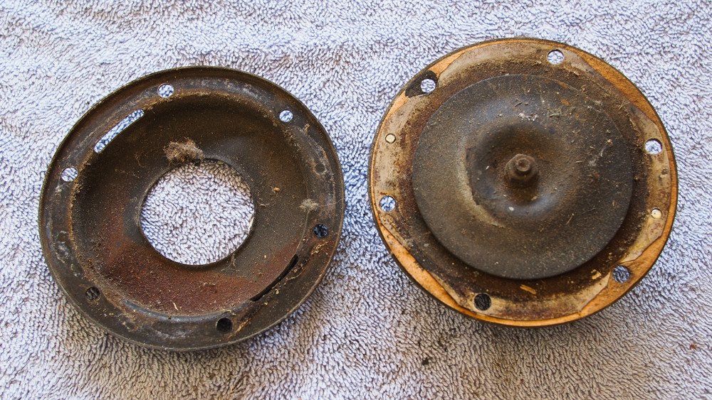

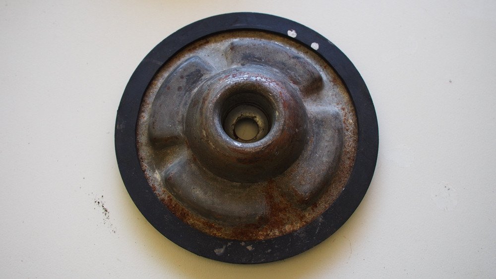

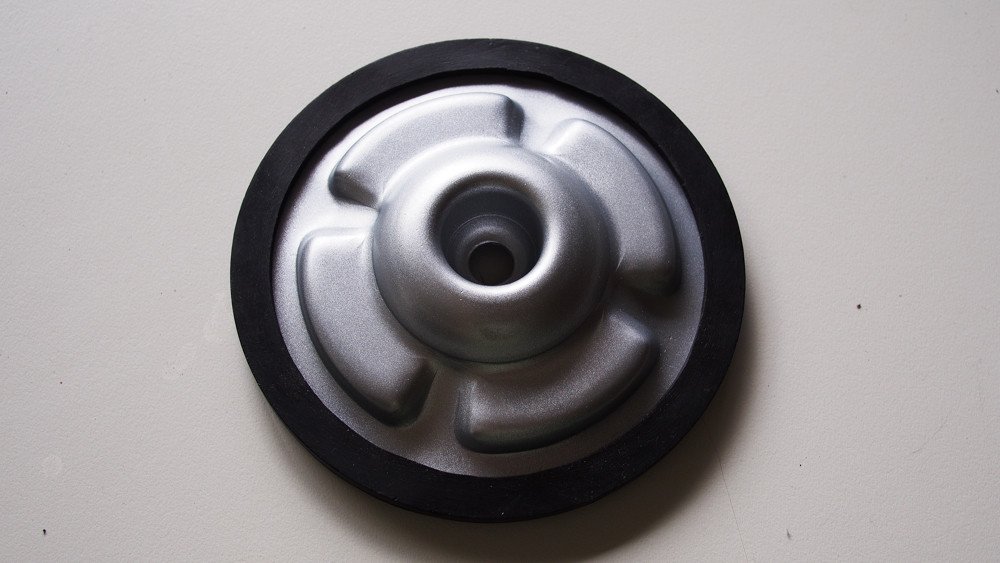

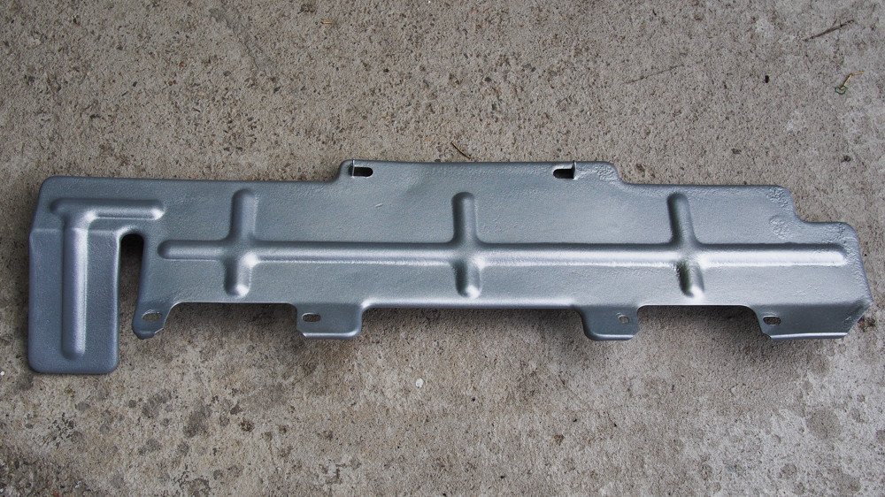

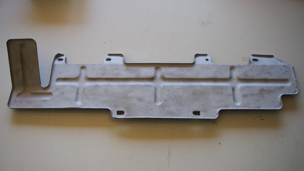

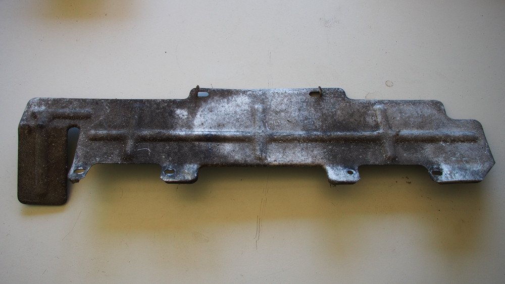

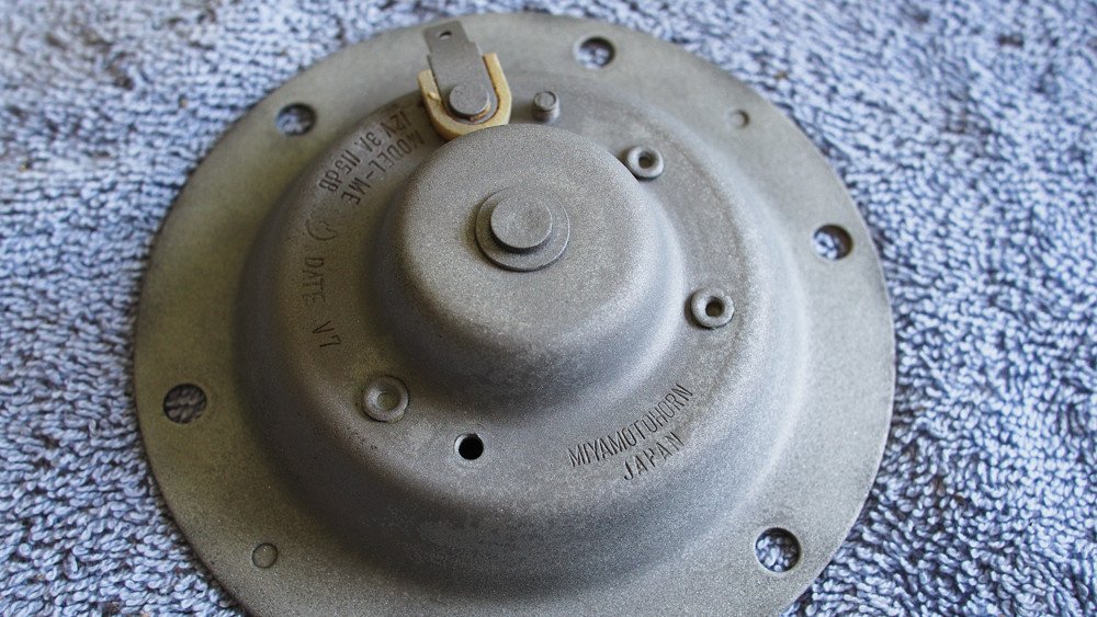

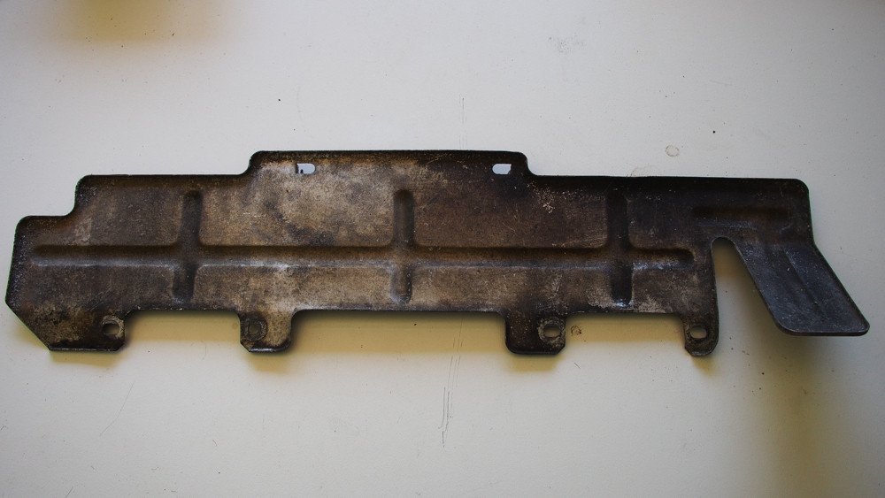

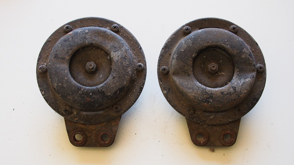

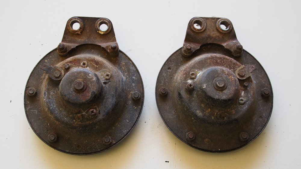

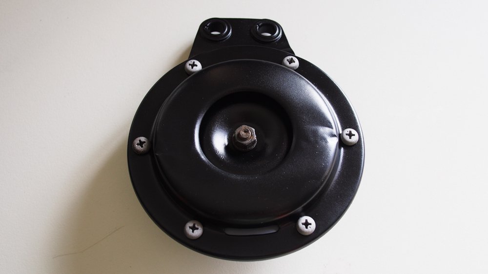

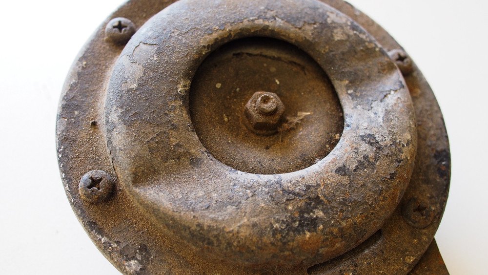

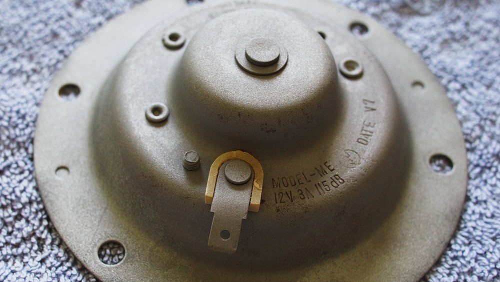

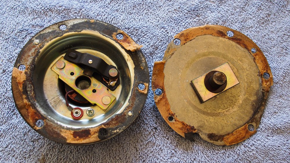

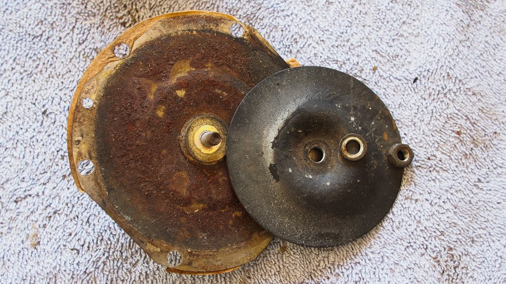

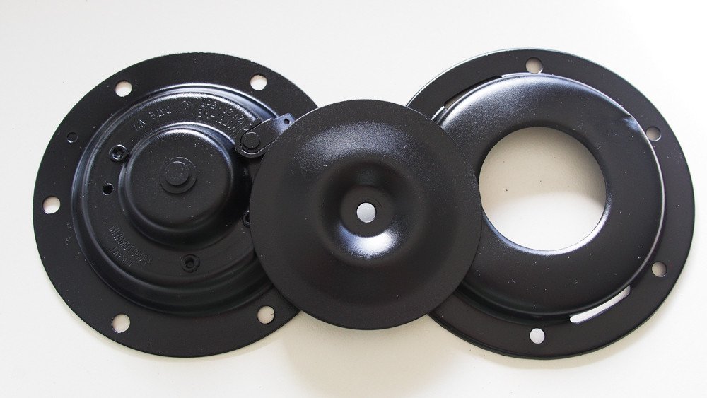

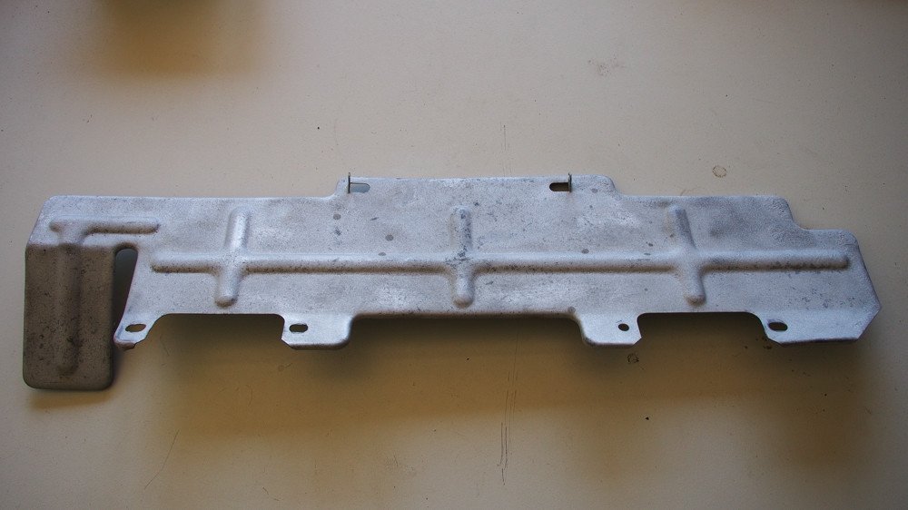

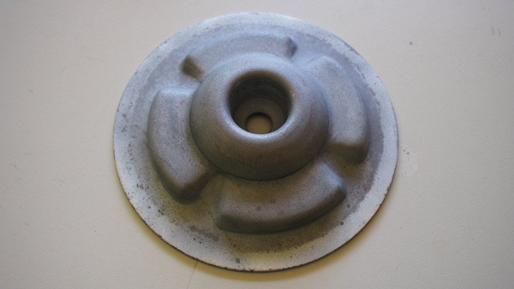

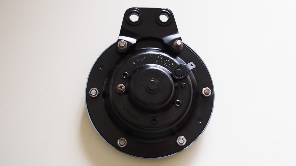

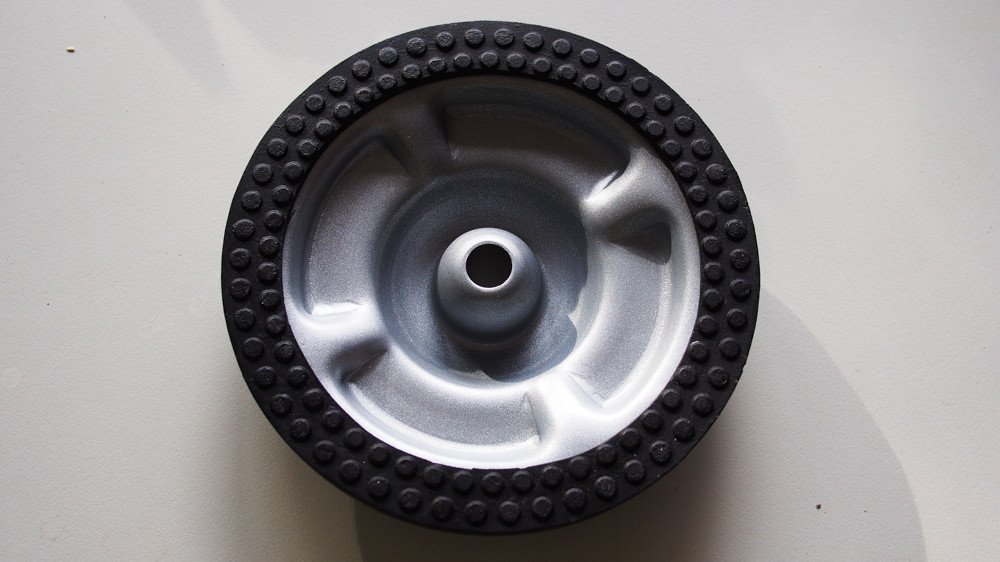

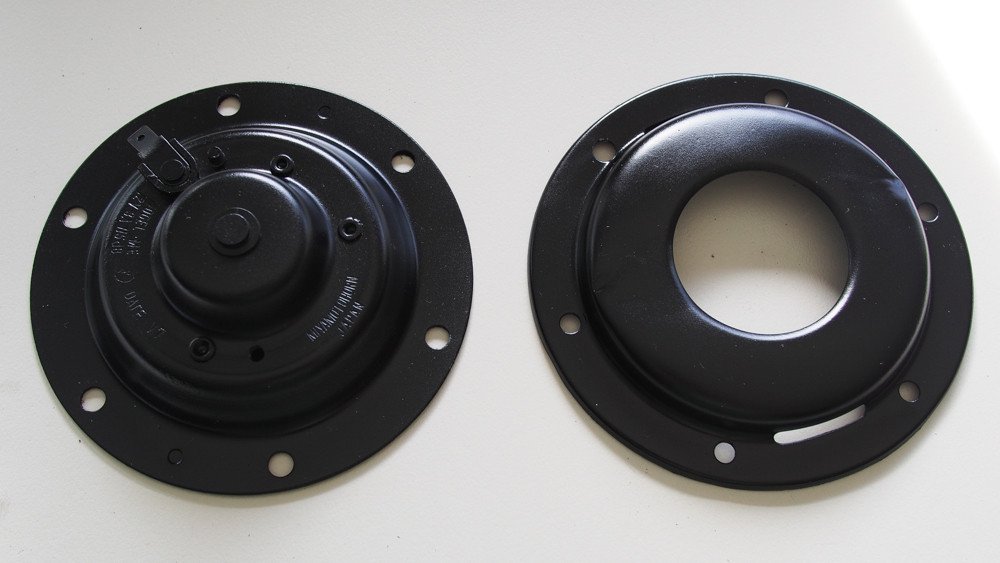

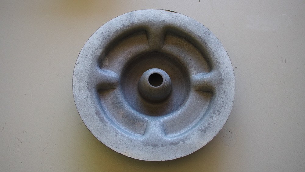

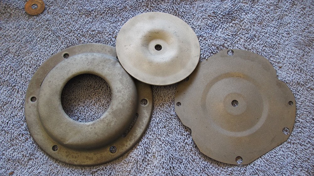

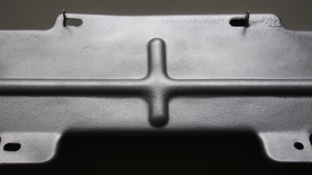

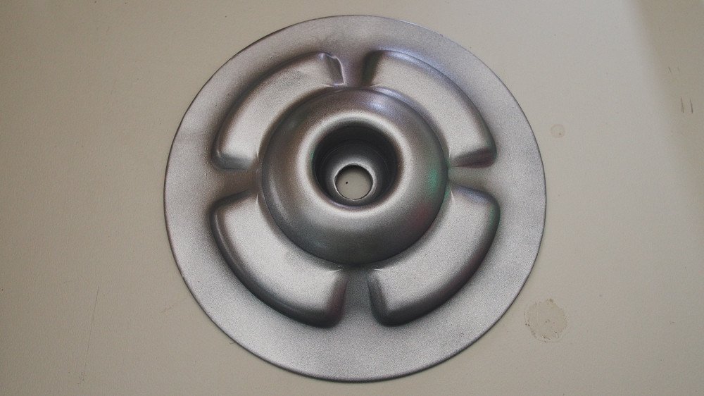

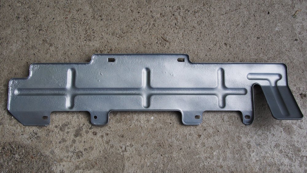

George Posted November 9, 2014 Author Posted November 9, 2014 Finally I've started playing around with some parts. Spare Tyre Clamp Pretty rough looking but the rubber is in good shape After a sandblast 2 coats of VHT primer and 2 coats of VHT Engine Enamel Aluminium I'm sure the 500+ f. heat resistance will come in handy here... Heat Shield Again, very rough looking Mostly just grease and grime However, not all is rosy under all that grime Not pleased with the finish but it'll have to do The paint however is excellent Horns I thought I'd tackle the horns as well. They look rough and they are! They do however work and as everything on these cars they are serviceable, I just had to work out how they toot! Bit banged up so I roughly hammered them back in to place This is where I'll have to do some more work. There is a paper insulator (my best guess) which has deteriorated. I need to source a replacement material. Sandblasted. The part on the right was plated. I have hit it with a primer for now. Not sure if that will affect the performance of the horn but I can always go back and plate it later. More of that VHT in satin black. I bought it for other parts so I thought why the hell not. I'm not quite there yet with the horns. I've only done 1 and I still need to fine tune it but it does emit a sound. It's nothing like a proper horn though and I'm guessing it's got to do with the insulator mentioned earlier and also because I didn't have everything tight due to still drying paint. The fasteners need to be plated or replaced as well. Quote

George Posted November 9, 2014 Author Posted November 9, 2014 It's satisfying seeing them come back to life and it serves as good practise for skills that will be required later on when we get to some of the more expensive/rare items. It's all fun Yes, I bought one a couple of weeks ago and just started using it this weekend; basically learning on these parts. Quote

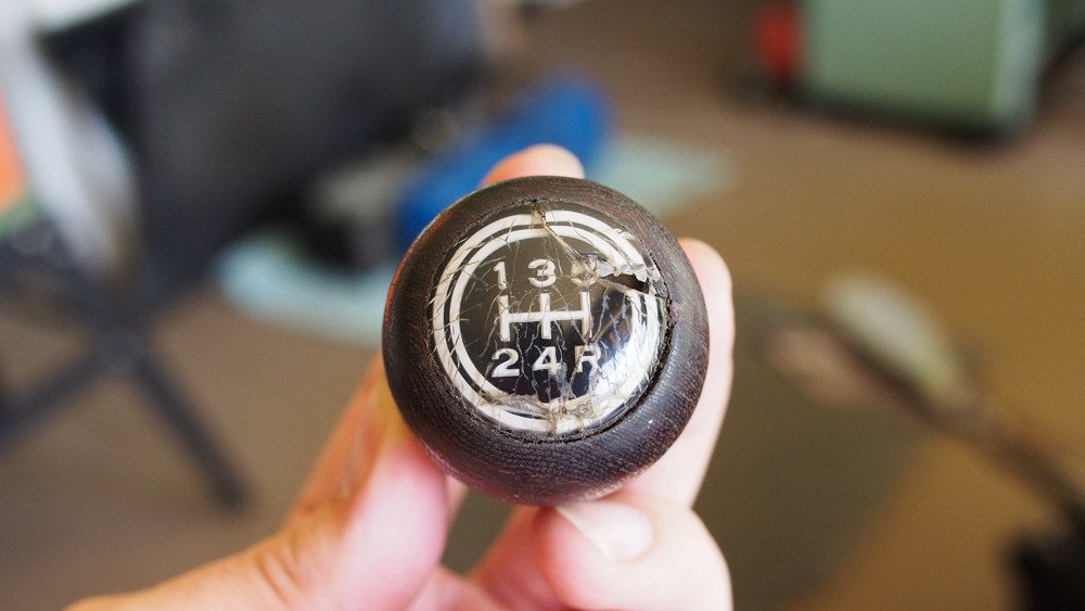

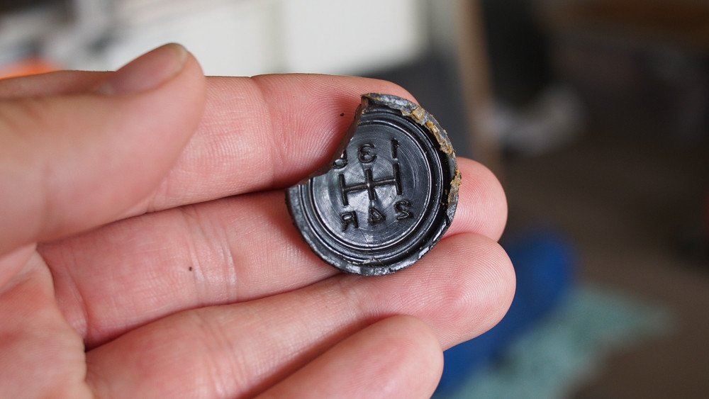

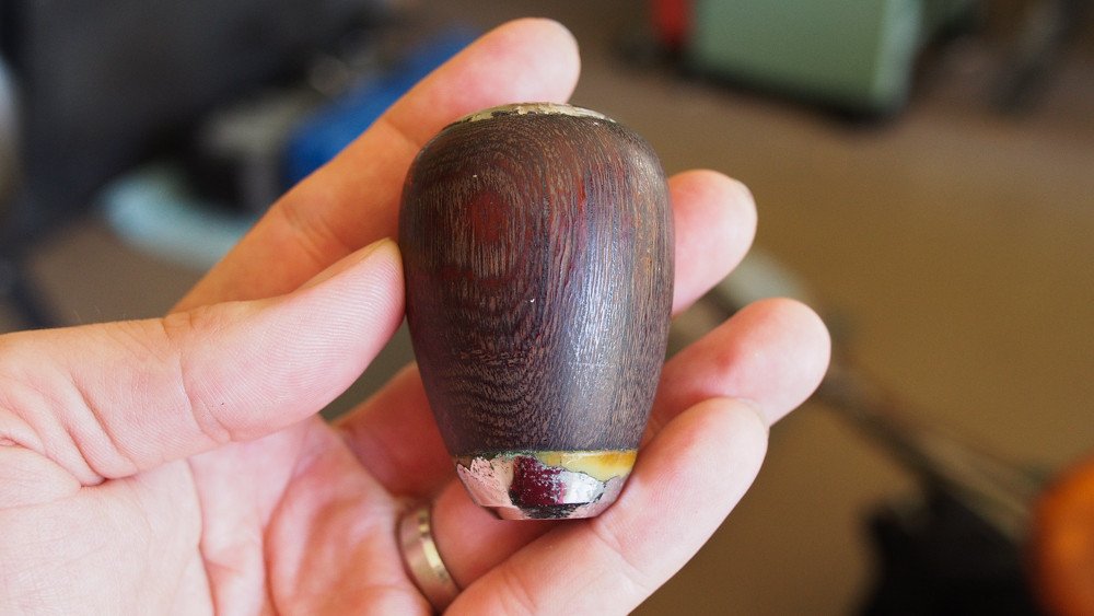

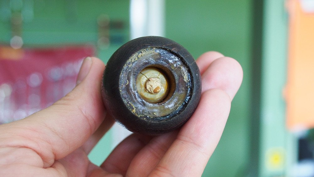

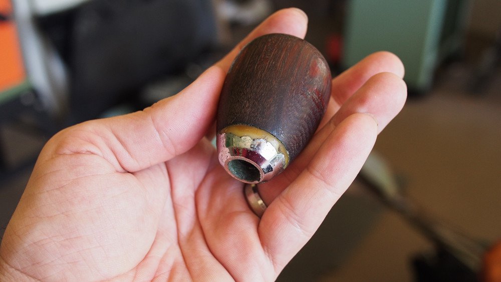

George Posted November 22, 2014 Author Posted November 22, 2014 Thanks to Peter for giving me his knob. Every time I touch it I'll think of you... Gav, or anyone else, how do you get the plastic collar off? Also, is there anyone making exact replicas of the button? Quote
Administrators gav240z Posted November 22, 2014 Administrators Posted November 22, 2014 You can remove the bottom half as far as I'm aware. I wouldn't try as you'll damage it. You should be able to rechrome it though. I'd refresh the wood grain first. In terms of the button I'll send a PM. Quote

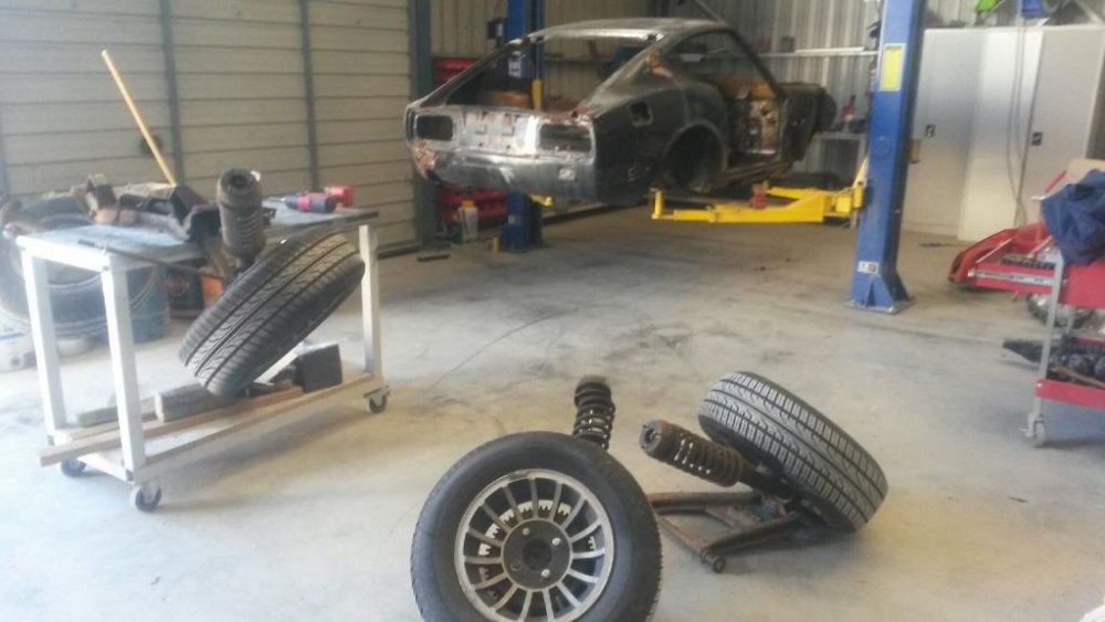

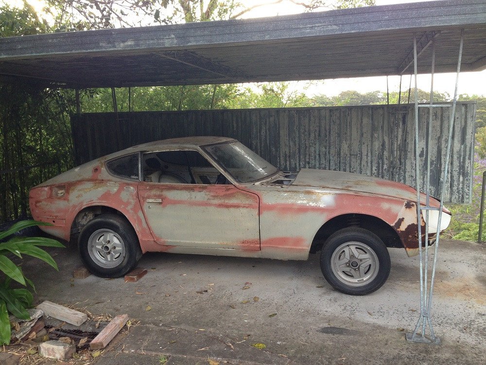

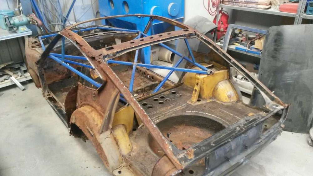

George Posted December 30, 2014 Author Posted December 30, 2014 Just received a report from Paul. The car is almost finished and by almost I mean he has made a start today. Here we go... Quote
zed74 Posted December 30, 2014 Posted December 30, 2014 Just received a report from Paul. The car is almost finished and by almost I mean he has made a start today. Here we go... In the right hands for the kind of work required Its great to see another zed saved & returned to how they were... Well done George Quote
Administrators gav240z Posted December 31, 2014 Administrators Posted December 31, 2014 Looking forward to seeing the pro at work on this car. Quote
Moderators PB260Z Posted December 31, 2014 Moderators Posted December 31, 2014 I agree with Gav it will great to watch this rare car come to life with Paul's expert work. Lots of photo's please. Quote

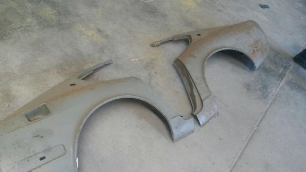

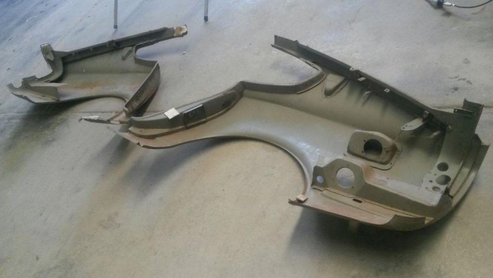

George Posted January 20, 2015 Author Posted January 20, 2015 Paul has made some progress in between sitting in his Hako while making race-car noises. We're hoping it returns from the blasters with... well, just hoping it returns... NOS quarters fell in our lap... Quote
zzzzed Posted January 20, 2015 Posted January 20, 2015 I saw your car at Paul's the other week. It made me feel better about doing mine as mine is in a similar state. I can't wait to see this one all done. Quote
Administrators gav240z Posted January 20, 2015 Administrators Posted January 20, 2015 Nice work on getting the NOS 1/4 panels that should take care of 20% of your problems . Where did you source them? Should I even ask about cost? Although probably still cheaper than fabricating new ones or restoring what you had. It's good to see your car making progress, it motivates me to work on mine. Since we are having a race after all, aren't we? Quote
zed74 Posted January 20, 2015 Posted January 20, 2015 ummm Be afraid - very afraid! Sandblasting or soda may not leave you with much... :'( I agree this shell will have to be completely "unpicked & reconstructed" to ensure it really survives in the long term. Don't want to be totally negative - but this project is ONLY a job for a professional body/panel tradesman (Ledge or equally skilled). Must also say - "what price are you prepared to pay" to save this early chassis? :-\ I commend your preservation aspirations - but reality of $ required on this one is going to hurt - BIG TIME. Only my thoughts & I like your concept/commitment to preserving an early chassis. Good luck with bringing her back to life Again - I say well done for your level of commitment to save this early chassis Wow - I am surprised NOS 1/4 panels were an option - I am also interested in where these sourced?? Quote
George Posted January 20, 2015 Author Posted January 20, 2015 It was just fortunate timing with the quarters. Someone approached Paul and he offered them to me. I don't know who it is but they had been sitting on them for a number of years, as I understand it, and they have my thanks for passing them on. Quote
