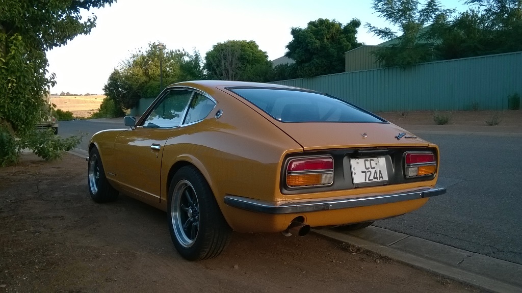

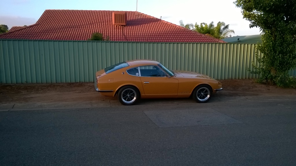

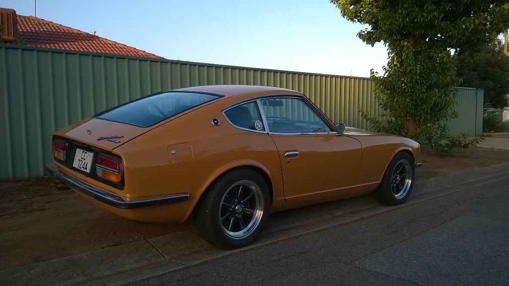

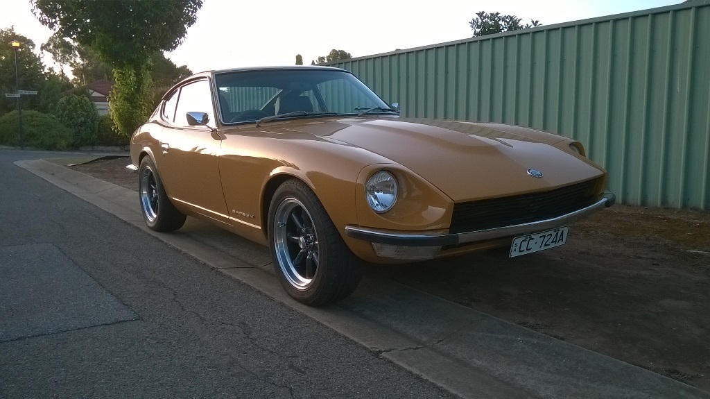

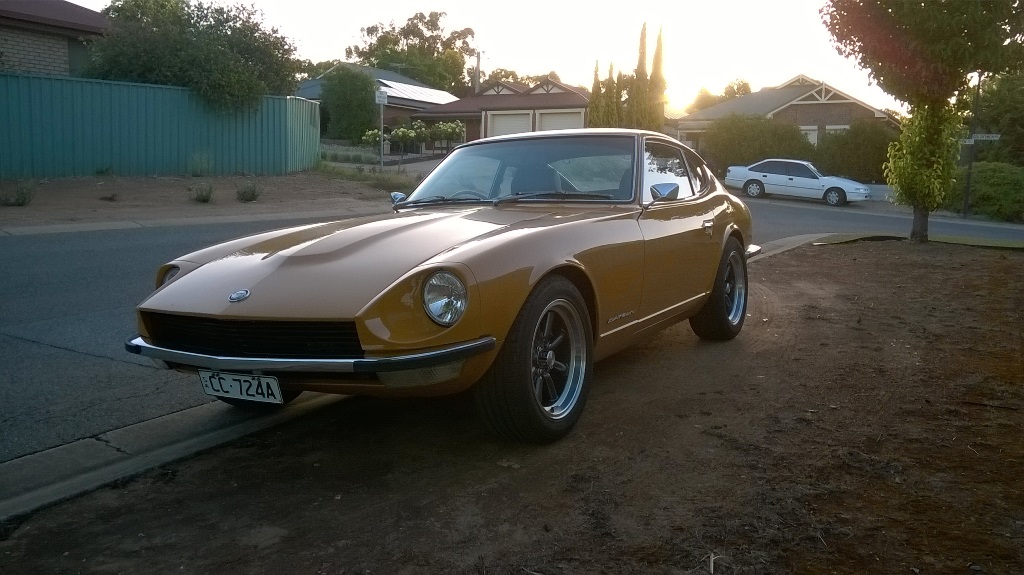

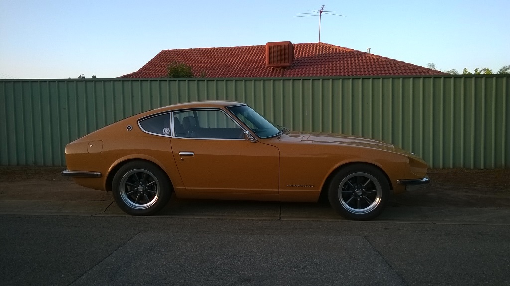

Hi Guys. Vaughn's mate Jeff here. Vaughn dropped by this afternoon to give me a quick drive of the 240Z. Thanks Vaughn, it was fantastic to drive a Zed again, helps keep the motivation up when mine is in the roti. See the Youtube link for a video I took as Vaughn drove off. It is only a short Video, however should provide "Proof of Life". I hope it is to your satisfaction George. Also a few pics attached.
Wow, that is a very tidy looking Z.
Great to see it on tbe road - enjoy.
PB
The view count on that video is 10 views. 9 of them were mine haha.
A big thanks to you all for kind remarks. A a bigger thanks to Jeff and Derek for helping me get my car on the road. It would not of happened without their help.  Derek did an amazing job with the body and paint and in my dads words made a silk purse from a pigs ear. Jeff was a big help with the electrics  and coming around to help when I just couldn't find a solution to what ever problem I had that night or day. When I started this 4 years ago I knew it would be hard, but it was heaps harder than I thought. I did manage to stay within budget give or take a few grand. The support form all the club members has been outstanding and really helped to keep my motivation up. I still have a few bugs to sort out, but now it's time to enjoy the car for now, and save some money to sort some things out over winter. I also now want to help Jeff with his 240 and my wife has 4 years worth of jobs around the house saved up. Thanks again to all I will try and take some "good" pictures with something other than my phone in some good light to show the car in detail a bit better. I know the car will never be finished but now I can enjoy it.
