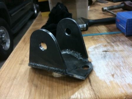

Riceburner Posted June 13, 2013 Posted June 13, 2013 I had one of the solid aluminium ones, was $50+post IIRC. I run the techno versions mount witt the red top mount only, I shaved it slightly to get the correct diff angle. It's great and a lot quiter than the solid mount, absolute prick to fit though! Like Jason says, If your on track only and noise is no problem solid wins everytime. Here's pics of the Stewart Wilkins style captive mount, pretty easy and cheap to make if your handy with a welder. I'll try to make one of these when my current type gets tired. $300 is getting high, but I guess your paying for the crossmember and all the modifications and the OEM rubber bush. If it's done on an exchange basis I'd say it's too exspensive. Quote

dat2kman Posted June 14, 2013 Posted June 14, 2013 I had one of the solid aluminium ones, was $50+post IIRC. I run the techno versions mount witt the red top mount only, I shaved it slightly to get the correct diff angle. It's great and a lot quiter than the solid mount, absolute sharp object to fit though! Like Jason says, If your on track only and noise is no problem solid wins everytime. Here's pics of the Stewart Wilkins style captive mount, pretty easy and cheap to make if your handy with a welder. I'll try to make one of these when my current type gets tired. $300 is getting high, but I guess your paying for the crossmember and all the modifications and the OEM rubber bush. If it's done on an exchange basis I'd say it's too exspensive. Pic of the bit that connects mount to diff is clear, can you put up more pics of the bit that bolts to the body? Thanks Quote
