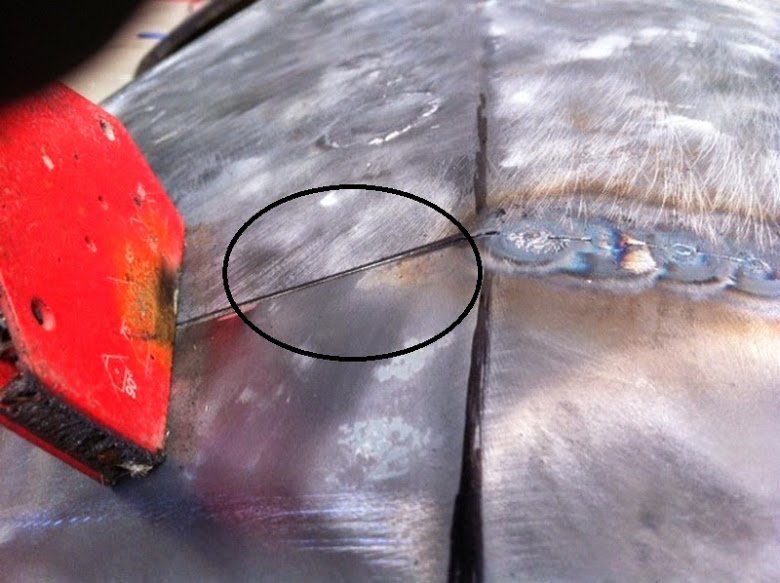

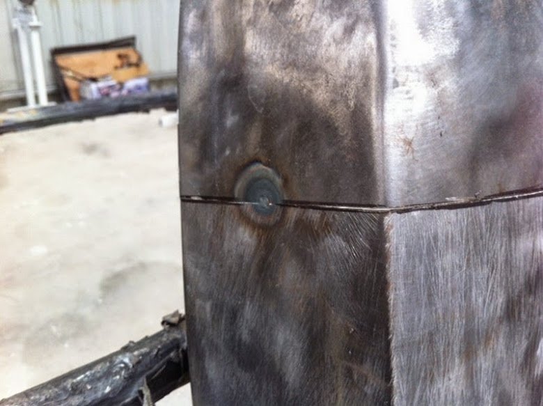

When Oxy welding in replacement sections the better you can get the join the easier it will be, spend a bit
more time getting a perfect fit and it will save you time. Not crucial however.
I normally use a .6 tip in the Oxy but i couldn't find it so had to use a .8.
Use a couple of magnets or clamps to hold you panel in place while you start.

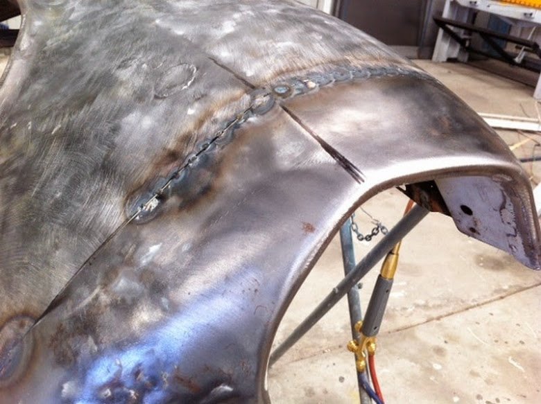

I find it best to start up one end and work towards the other, in this case i started on the top of the guard
as this is the most important part to get spot on. This is something you will pick up the more you do it.

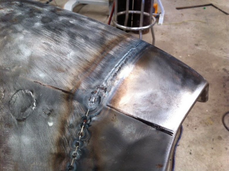

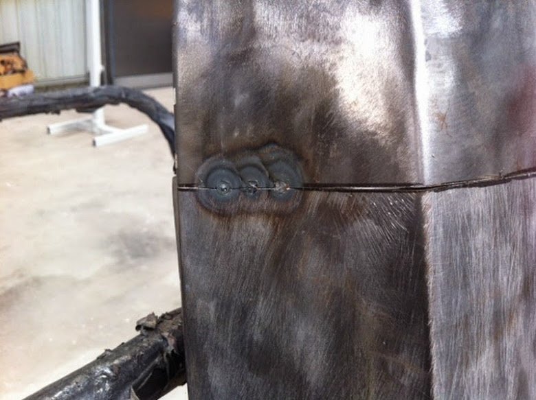

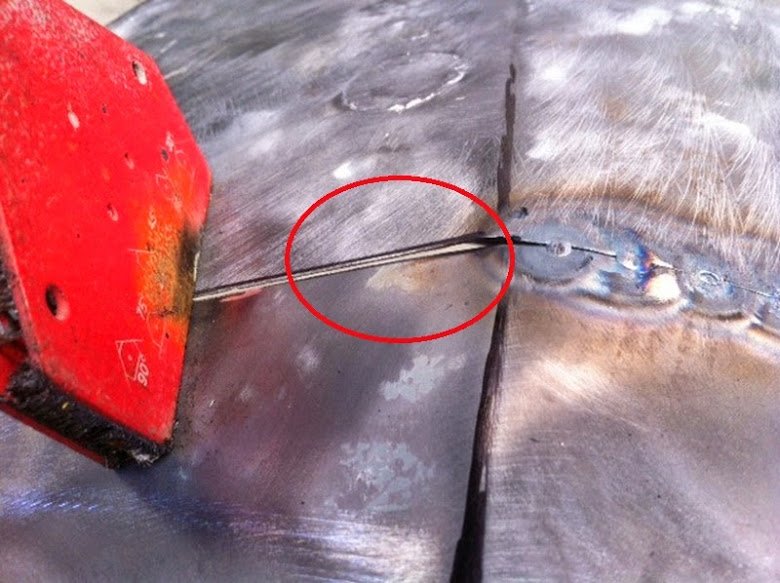

Start with one tack. You must let it cool to the point where you can touch it.
If it moves make sure you hammer and dolly it back to alignment before you do the next tack.
One at a time following the same process do another tack on the heat ring of the previous weld.
This takes time, Don't rush it and LET IT COOL between tacks and also get the panels aligned after every tack.
Panels will either go UP, Down, Tight or Loose. But you should only hit the WELD.
A couple of gentle taps with the hammer and dolly on the weld will pull the alignment back.

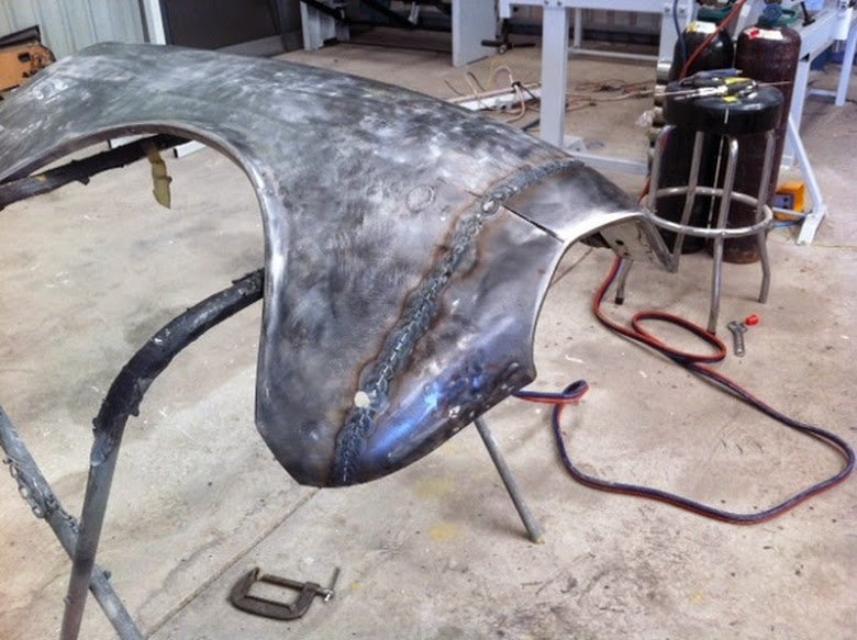

Continue until the whole section is tacked in place.

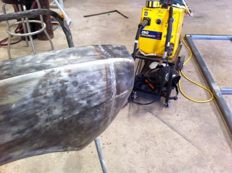

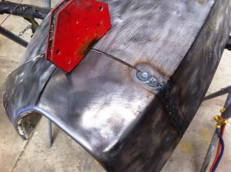

Once you have Oxy tack welded the panel in place it is crucial to get it all back in the right spot.
If you want to neaten up some messy tacks then go for it, just make sure the panel is lined up.

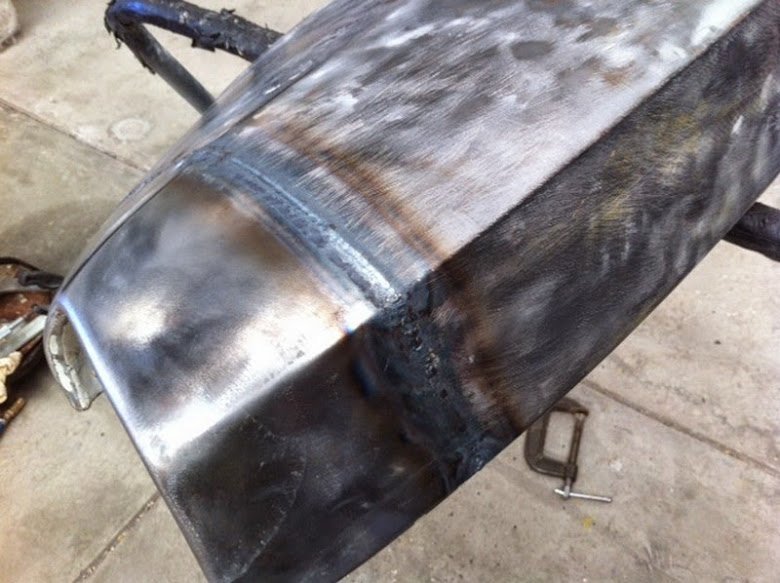

As this is a guard it has basically 3 separate runs with the Oxy.
Start at one end and this is where you can save some time if your join has no gap, Fusion the two panels together
if you need to use filler rod that's fine too.I just do one pass. no need to stop and move around to keep the panel cool.
After each run let the panel cool

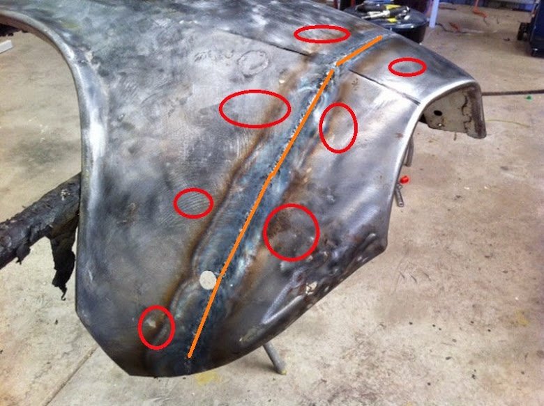

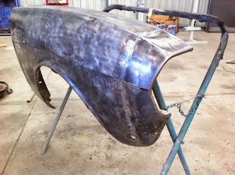

Once you have welded the whole panel. LET IT COOL. Don't worry that it has gone a bit out of shape. Trust me.
Now that the panel has cooled you can straighten it up. you will only need to hit the WELD LINE.
Do not hit anywhere else, Work your way along the weld line with your hammer and dolly and it will
go back into shape. IT WILL.
When you have it close gently grind off any lumpy welds on both the front and back if any.
Then continue to plannish it off until its perfect.

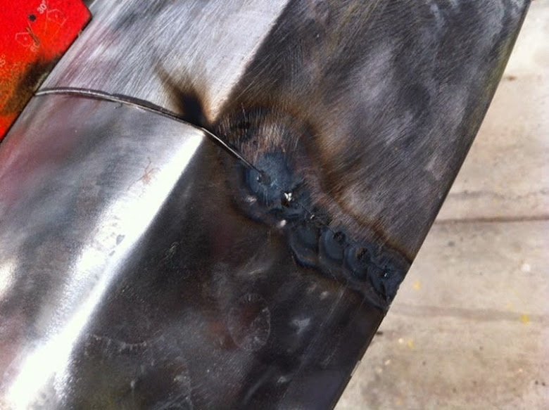

Now if you have got the Oxy setup right and welded thoroughly
the weld should look the same on both sides, If you see a line or gaps
on the back you haven't let the pool go deep enough.
The joy of Oxy welding is that you can still work it.
If you need to do a heat shrink on the weld you can.
You can move it around without cracking.
This process takes 3 times longer than MIG but
its the only way to metal finish perfectly.
I will Oxy weld 90% of all panels i do. Make sure you can get behind it.
Or make your replacement sections in a way where you can get behind them.

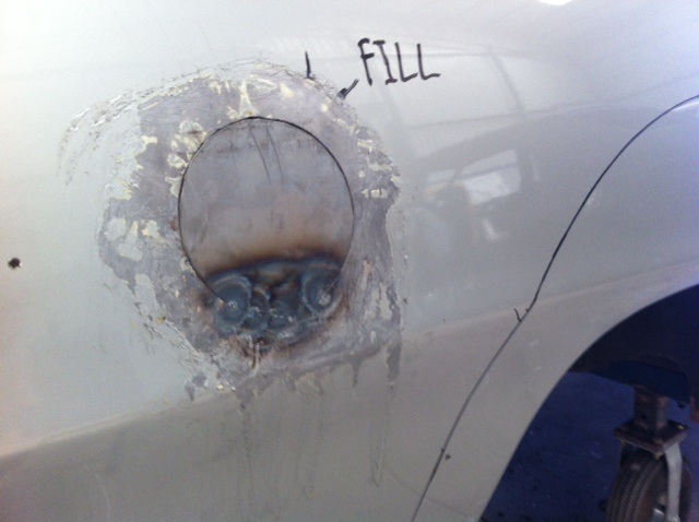

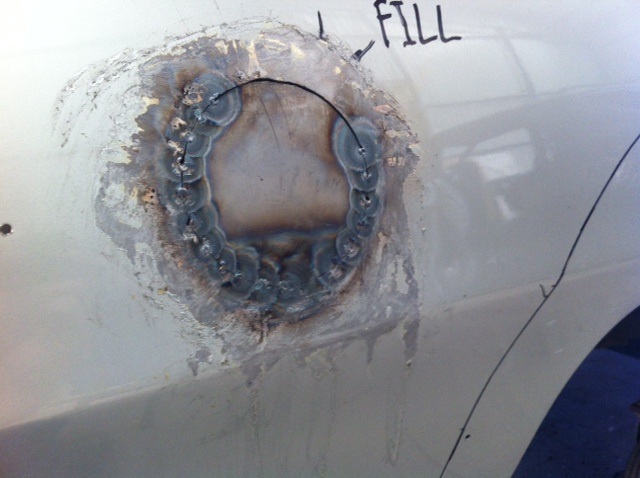

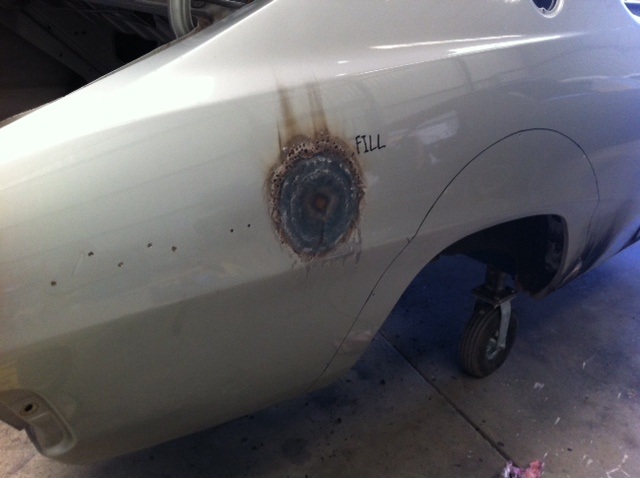

OK Lads,
Here is another example,
Oxy welding up the gas filler hole in the rear 1/4 of the KGC110.
Yep rear 1/4 and Oxy.
No guts no glory.  (it fine Shane get off the floor) ha ha.
Still needs a bit of dressing up after sand blasting but all the unwanted
holes are now filled
Paul

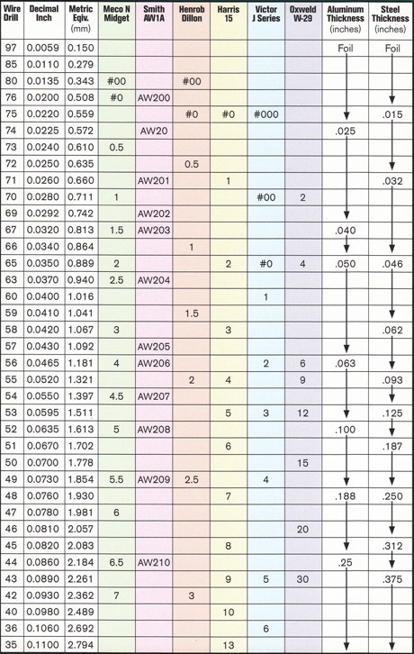

I would like to try gas welding body panels but have one question Ledge says to use a .6 tip but when I looked up a welding tip chart the sizes are different for different brands.
I know this is an old post but does anyone know what size that would be on this chart.
