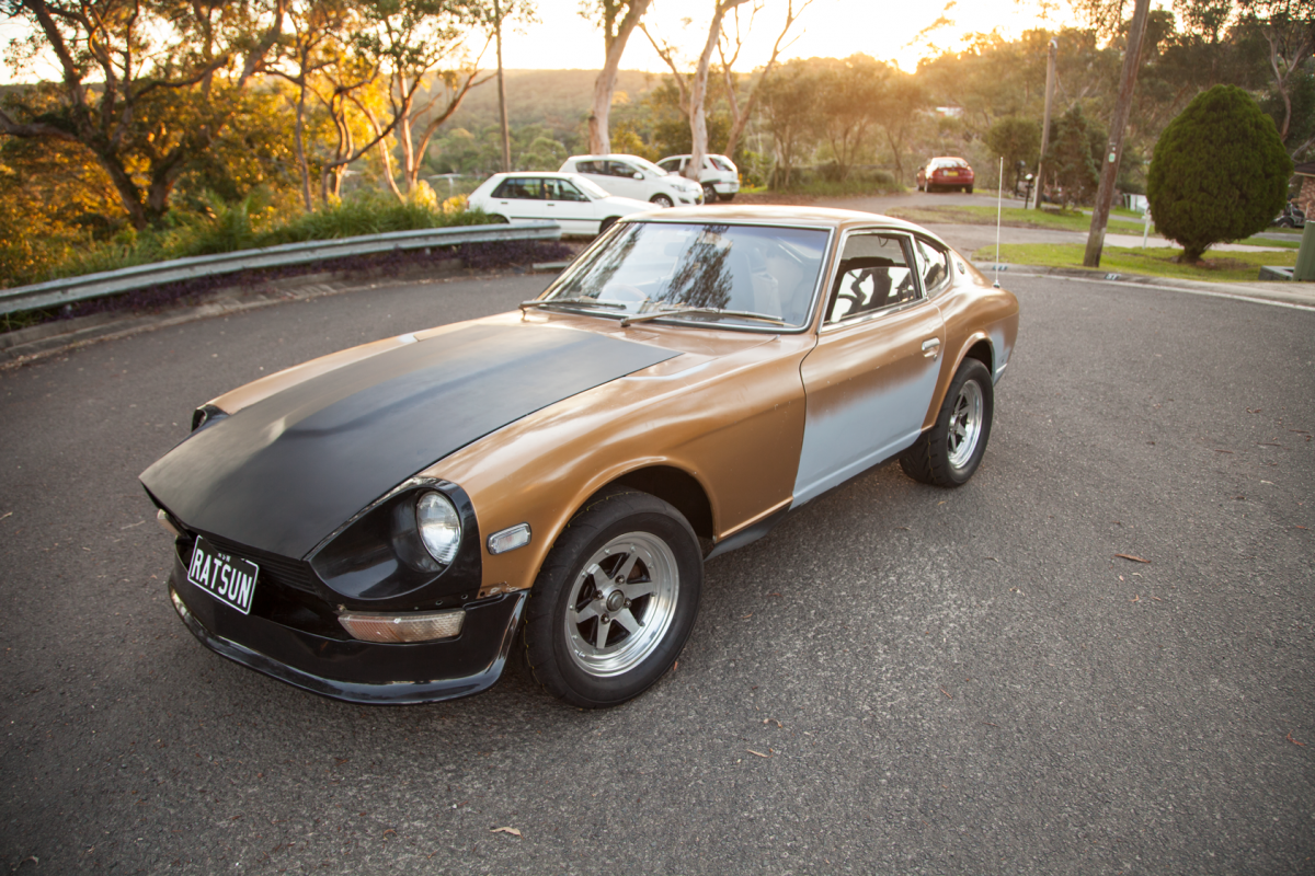

  16. Hello everyone! I've been a long time reader of these forums but first time poster! I've recently been able to register my project Datsun and have since been pointed in the direction of this cruise. I'm pretty local to loftus and also pretty keen on the idea of joining you guys on the cruise although work will deteremine whether i'll be able to make it on the day. Here's a photo of my 76' 260z Hope to meet up with you guys soon! Sandy.

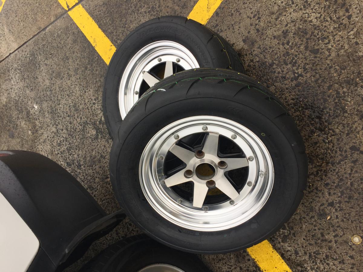

  17. Blair's tyres in sydney. that was the only shop that i could get the R888's in 50r15 sizes. initially i was after 225, but they only could get 235... lol

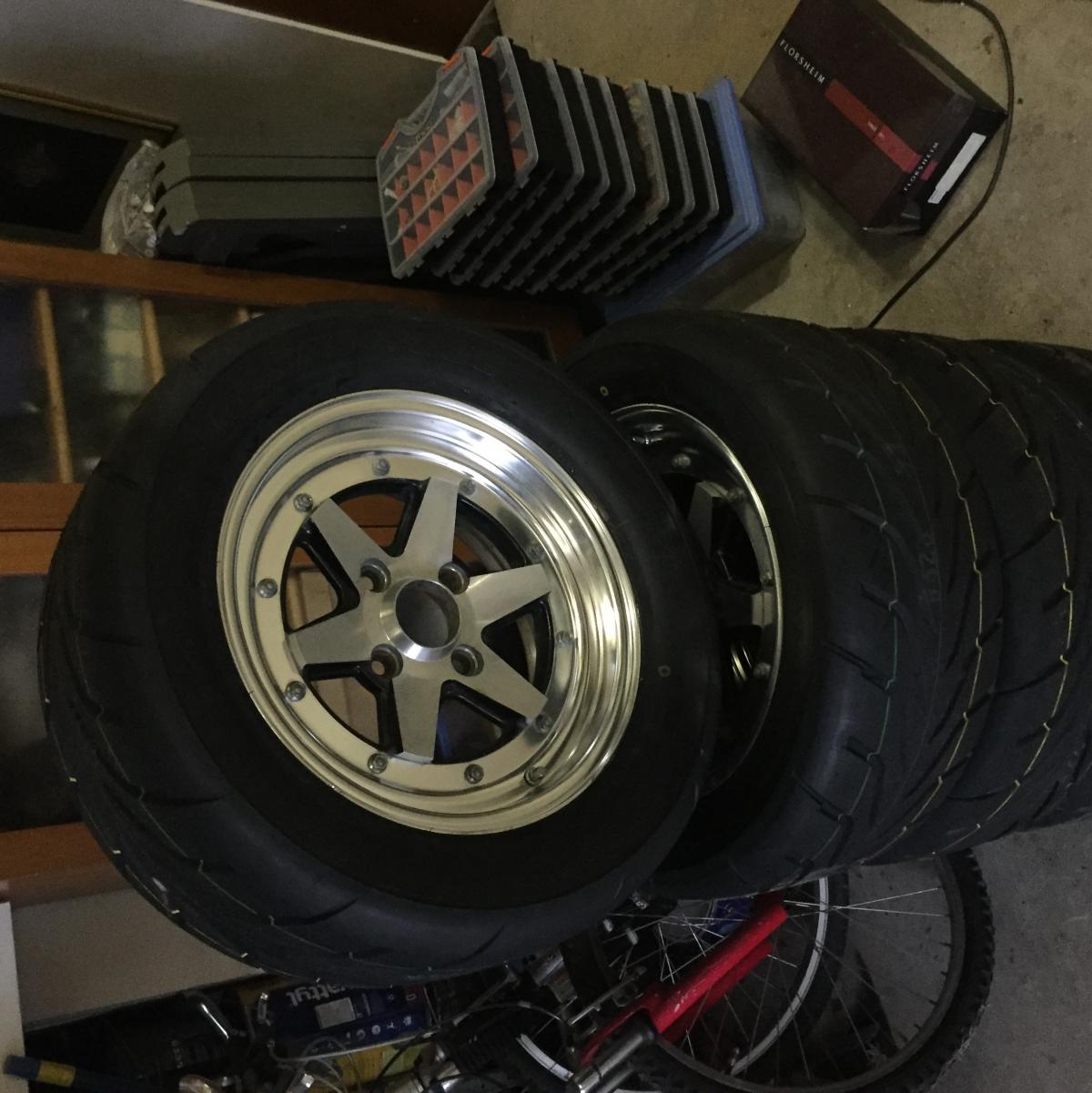

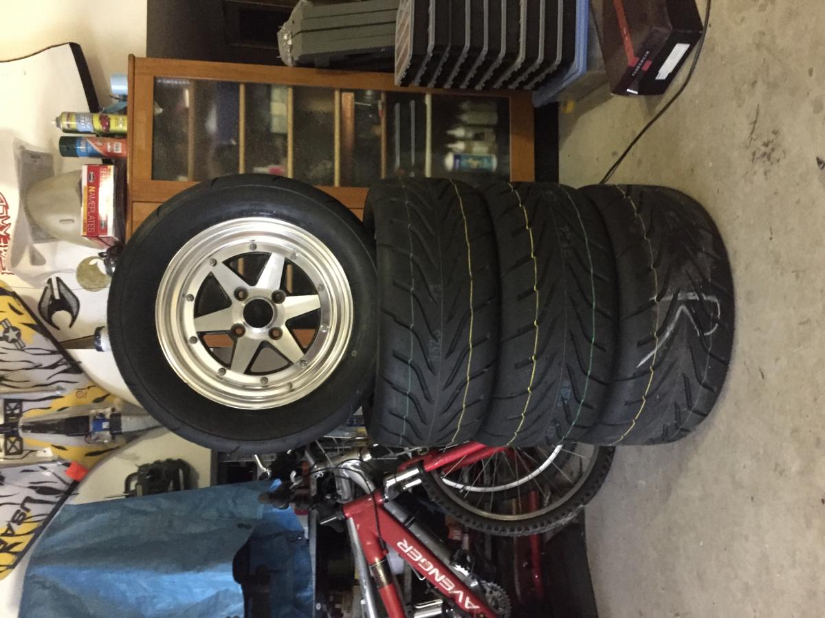

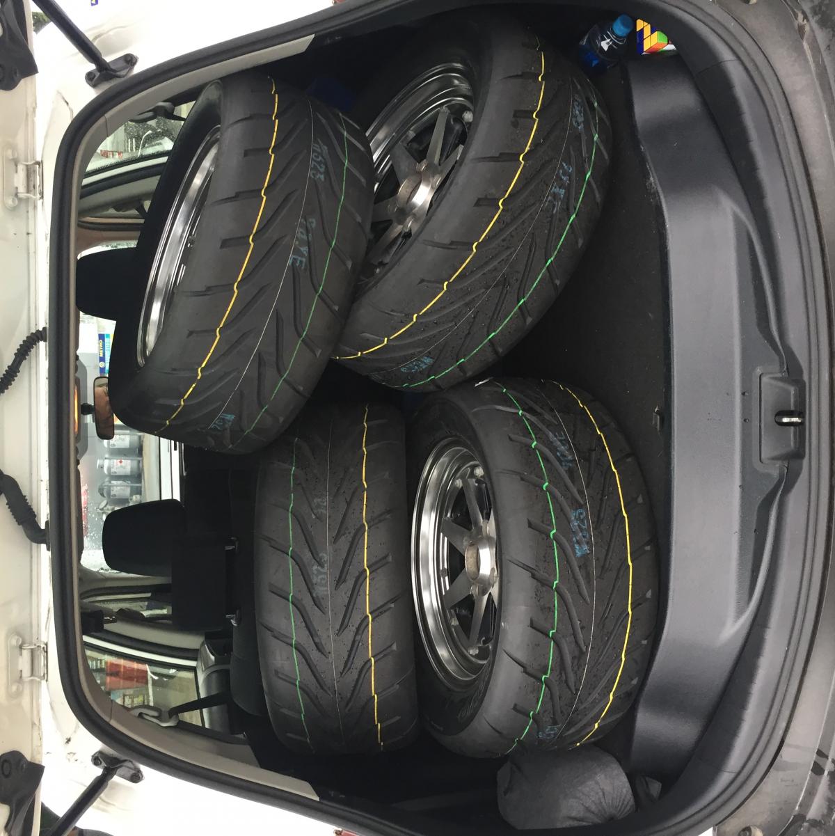

  18. i recently got 15x6.5 +13 SSR longchamps ended up fitting a set of 235/50R15, Toyo R888's because that was the closest size i could find!! they look really aggressive. I'm not too sure how they handle yet.
