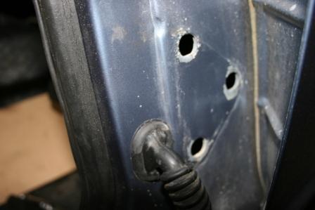

Thankyou John....the job only took about an hour, and sorted out a problem that's plagued stereo installations on Z's forever...I glassed up the speaker mount today as well, so I will have some pics of the whole lot installed sans trimming by tomorrow afternoon. Having looked at your project post and the HUGE mods you are doing, I imagine you will be thinking of power windows and those door locks that pull themselves closed!....I sure admire your desire to create a different car altogether. Anyway, you can now route the wires nice and neatly, and you saw it first here on Auszcar!!!! Cheers Jamo

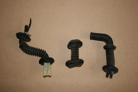

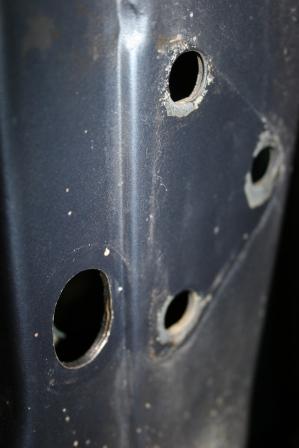

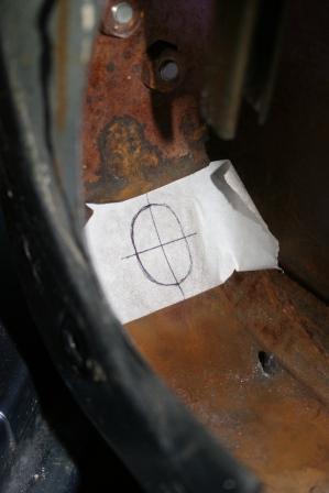

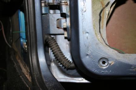

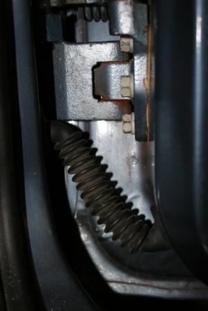

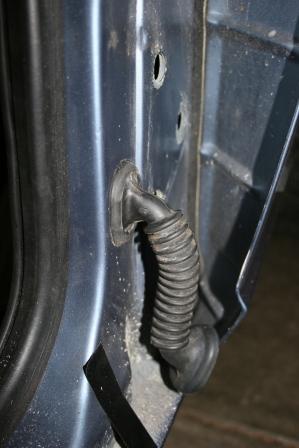

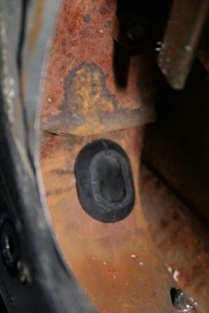

OK ladies....here is a photo expozay on how to put the rubber belows in your doors for speaker wiring. I fiddled around for a while to come up with a good combo, but I think this one works. The part i ended up using was the one off the 2000 Daewoo Lanos (No. 1 in the picture from the last post). THis one had the right angles and length, and I did end up fitting the body end into the area that is reinforced, but there is a 20mm hole in the reinforcement that you can slightly elongate to allow the grommet to fit. The dimension of the hole at both the body and door ends is 22 x 31mm. You have to remove the door and lower hinge to complete the job. Cheers lads Jamo

Hey Gents I made a visit to pick-a-part today to check out a few cable conduits to route the speaker cables through. I have included a picture for your viewing pleasure. The three parts in the picture, from left to right, come from: 1. (LHS of pic) - 2000 Daewoo Lanos sedan (front doors) 2. 1998 Daewoo Nubira sedan (rear doors) 3. (RHS of pic) - 1995 Hyundai Excel (front doors) I had originally intended to position the conduit between the two hinges, which is a peachey spot for it, except there is too much reinforcement in the door and A-pillar assemblies to go through here, given I do not want to interfere with the reinforcement (I imagine this would be a no-no from an engineering approval perspective, as the door mounting system forms part of the intrusion protection system). So, I am now fiddling with the conduit mounted at the curve at the bottom/front of the door...this area is where the reinforcement ends, and there is a small area on the A-pillar where the other end can go...I just have to get the two positions spot on so the two ends dón't foul each other when the door shuts. At this stage, conduit number 2 is looking the goods. I will post some more pics of it all in-situ when I have it done. Although the position is a bit unconventional, it does have the advantage of bringing the cables through near the bottom of the door, well away from the window mechanism, and actually quite close to where the the speaker actually is. The parts cost me $8 a pair from Imlach's in Centre Rd, Clayton. Cheers lads Jamo

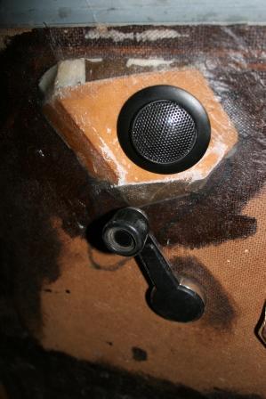

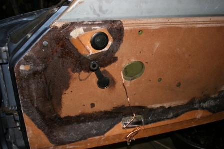

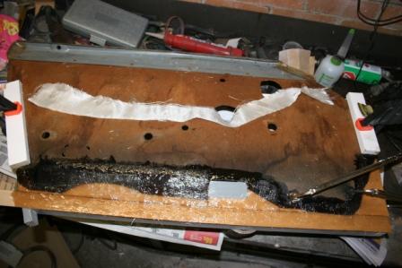

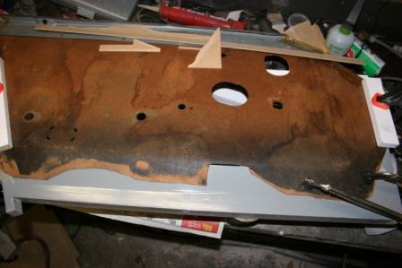

OK gents...tweeter location got sorted overnight, and here are a few pics to give you an idea...it is kind aimed up and back, although the pics don't really show that depth. I am going to put the mid-range speaker down lower and forward, where they always go on Z's. I was going to mount it on the door frame and have the speaker poke through, but given how the stiff the door card has turned out with the fibreglass reinforcement, I am now considering glassing the mount into the door card, and coming up with something other than the round grill over the speaker...I will have a hunt around at pick a part and see if anything appeals! I think I will add an extra door trim clip or two in the area between the speaker and the window winder, as it needs a bit more support with the extra weight it will be carrying. Final job is to line the door skin and frame with dynamat...really improves the sound quality of the finished product. Cheers Jamo

No worries Mick...I am leaning toward the rear door conduit from a VT-VZ Commodore. Unless you have a contact at a OEM harness maker (like Australian Arrow), you need to go to pick-a-part, as the mainstream wreckers don't want you to ruin a harness to get them. I will do some pics and keep you posted on the one that fits best. CHeers Jamo

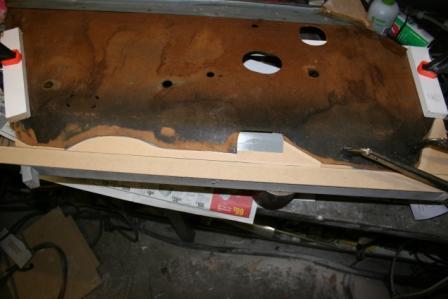

Why thankyou for the kind comments Dave...it's nice to have your work independently assessed!! On to other things though...with the mechanical work mostly done except for a few tidy-ups, it's time to sort out the interior. I have settled on door mounted speakers, so I have been working on grafting a Commodore cable grommet/conduit (the one that goes between the A-pillar and the door, through which the cables go), into the car. At the same time, I decided to go with tweeters as high as I can in the door panel, and mid-range speakers lower in the door. I may install a sub later if i decide it needs it. Given I decided both to cut up the door card as well as re-trim it, I decided it was a waste to buy new door trims just to cut them up, so I repaired the old one in preparation for the mods. I will mount the tweeter in the door card itself, because it is light enought to do that, but the mid-range speakers are too heavy, so I will glass up a mount to angle them up and back as far as possible. The mount will be fixed to the inner door panel, and I will put a hole in the door trim to let it poke through. I will then glass a corresponding shape in the door card which I can trim around, and finish it with a mesh panel built into the door trim, rather than the clip on 6" diameter ones that look a bit 80's these days. Here are some pics of the door card restoration. I made a jig up to clamp the card to, with the shape of the lower area built in to it. I then fitted up 3mm MDF which I then glassed in place. I prefer MDF over masonite as it tolerates water better, but can still be stapled when you re-trim it. The jig is finished in spray putty and waxed with releasing compound so that the glass resin won't stick. CHeers, Jamo
