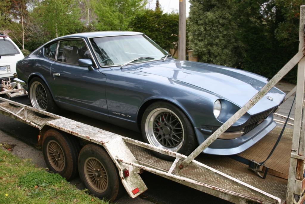

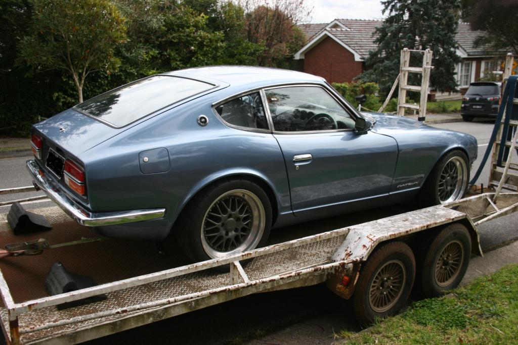

  11. Hey guys...here are a couple of pics of the car on the trailer. Dimitri...do you know which Skyline the smaller slave is off? Kato: Yes...I have fiddled with clutch ratios over the years myself and it can get tricky. The R33 Skyline actually has a spring assisted pedal, so that's how they dealt with high efforts. For that reason I am not wild about increasing the master or decreasing the slave, but I will have to do one or the other (or get a different pressure plate configuration) to deal with the issue. The clutch at present is not super heavy, but it will be at the heavier end if I have to move 1/16" on diameter...might have to see if i can integrate the spring assisted R33 pedal box?! Gareth: I will do a video of the dyno run if I am there when they do it (we didn't do it today, just shook it down to get it ready to rumble!). It is a L series shifter. It was not a straight swap...i actually took the RB shifter and cut if off then cut the piece left (that goes into the gearbox) longitudinally. I took the L series shifter and did the same, but with the bit you hang on to...picture the cut looking like an inch-long semi-circle in section. I then vise-gripped the two together and set up the angle to the shifter so that it was at the height and position i wanted it to be. I then TIG welded it together, and then linished and polished it until it looked like one-piece. Then I had it re-chromed so it looks like a standard L-series....Voila!!!

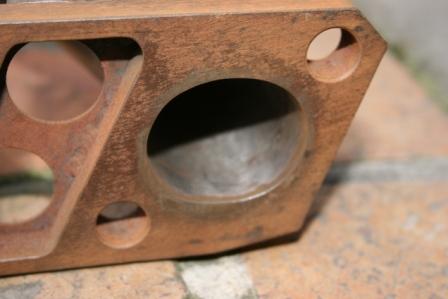

  21. Gents The exhaust header I put on my other clearing sale generated a bit of interest, so I thought I would do a separate entry for it. It is an original Nismo header from when I worked at Gibsons. These were the factory header that was put on the 800 cars Nissan built for Group A homologation. I can't recall whether this header came out of a donor car or off a donor engine before it got turned into a race engine. It actually looks like it was brought in as a spare part, as it looks like it never got used...there is no evidence of old gasket, carbon in the ports or nut/washer marks...so it probably never got put on an engine once we started using the Facey race headers. Anyway...it would suit any R31 Skyline owner who wanted to build up an authentic GTS-R car with the red-top RB20. I also have an RB20 cylinder head and inlet manifold if that's any use to you! Let me know if you're interested! Jamo

  24. Gents...for clarification, the manifold is a Nismo R31 Skyline GTS-R factory manifold...one of the ones that came out on the 800 factory R31's for Grp A homologation.
