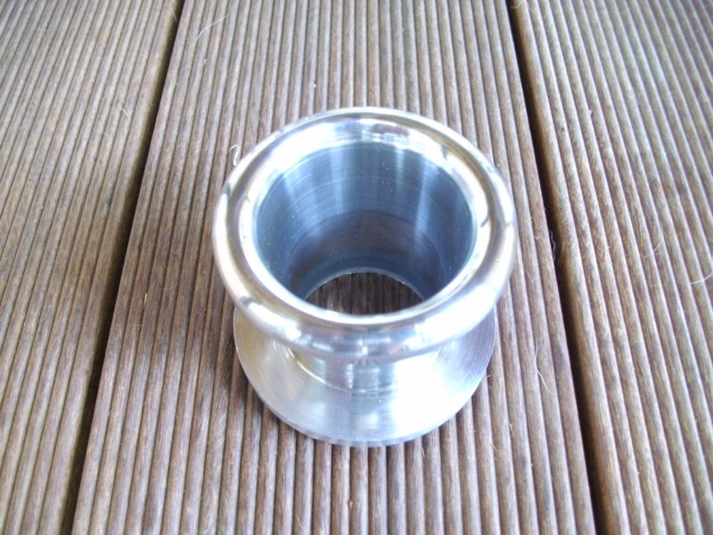

I did a fair bit of reading my self, when i had to figure out the air horns for my engine, i can't remember ½ of it, what i remember is: 25-30 millimeter from bell mouth to filter. Stacks like Ramflo should be best. Total length from head to bell mouth is the most important. And bla. bla. bla. I ended up in doing my own design based on collected information from the net. Full radius bell mouth, 50 m.m. bore at bell mouth, camfering in at 30 degrees for best airflow ect. these are for 40 Dels and the picture is of my proto type. This is from when the mounting ears wasn't milled out, all i can say is they work very very well. Chris

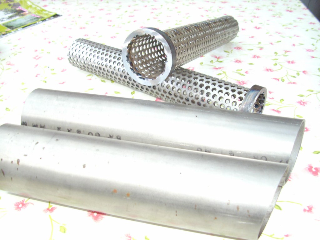

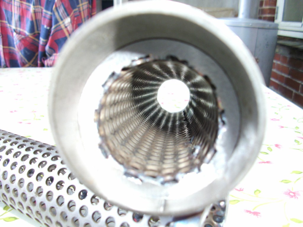

Cheating my butt mate, no way, it's a dual 1.75 inch system, two small mufflers in the mittle and two hot dogs as you call them at the end. I made some tips of some 2.5 inch stainless, made some perforated pipe and put inside the tips. At idle and cruise the sound is moderate byt at WOT it get's LOUD, i wish i could find some small resonators to put in the back and then put the hot dogs in the middle, just to turn the sound down a bit, then it would be easier to here my triples growl -
