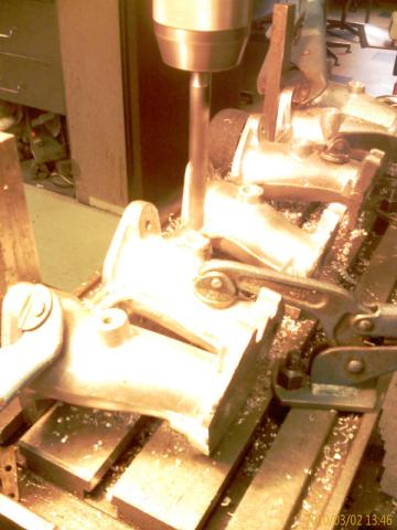

Here is a little update, bungs have been milled, drilled and tapped, sorry for the crappy phone pics. Chris

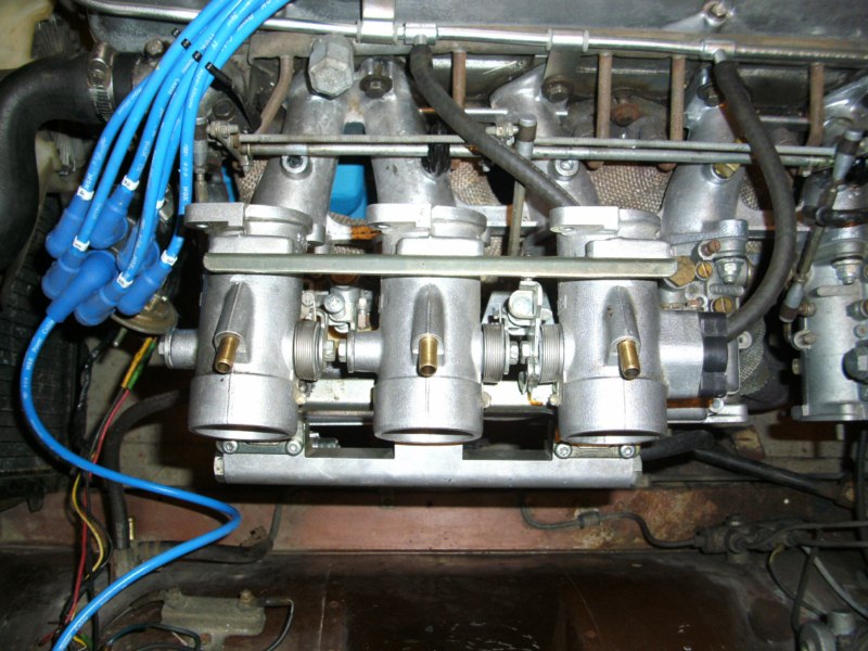

Nope, they are not upside down, the aluminium bar below is the fuel rail, the pipes you see sticking out on the upper side is for a stepper motor to control idle, throttle bore size is 43 millimeter and they have a center to center distance of 89 millimeter, so i'm planning on making a adaptor plate so i can bolt them on to my "exclusive" Lynx manifold Chris

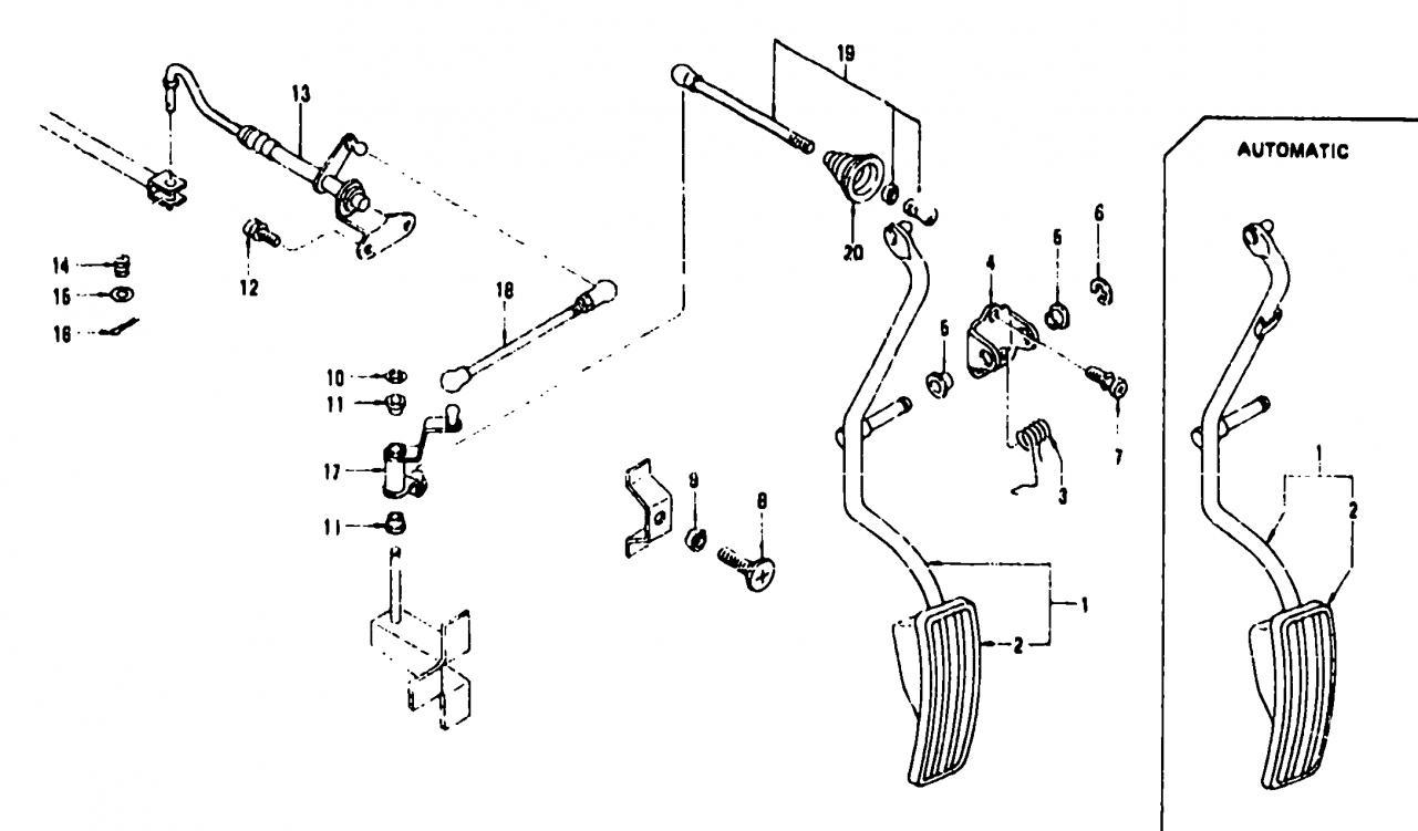

Thanks for the pics Now let me update, i went to my car today and pulled the carbs, on my way back home, i went to a shop where i know the owner, (he makes dental equipment) we cut of 3 pieces of 3/4 inch aluminium for the towers, they need to milled a bit but no more time today, we had a look at the manifold and came up with a plan, the stock bungs will be used to attach a hollow aluminium bar, it will be attached with banjo bolts, so it will work as a balance bar, i might get the best out of it. About the fire wall linkage issue, i think the dog bone linkage should sit below the bell crank that goes to the manifold, that will make it more straight, the tower that is welded on to the fire wall, can not be swapped around, it's not similar to the photo posted above, the one above is actually from a later model, look at the attached photos, 74 - 78 US model. Chris
RB30x that manifold is not similar to mine, with those threated holes you have at the left, nearest to your RB throttle bodies, it will line up fine, i don't have those, mine is located as the other set of holes you have. Zedman, yes i'm avare of that and have a spare rod just for the same, 5/16 or 3/8 it is very close to 10 milimeter, maybe i can drill and tab it to 10 millimeter. NZeder, i will try to move the fire wall linkage a bit around and see how it lines up. After a bit of consideration, i have decided that i'm going to have welded 3 aluminimun towers on for the rose joints, that will solve my problem, would it be an idea to use the six threated holes for a balance tube ?, i think it is doable, using a hollow aluminimum bar and banjo bolts. Chris

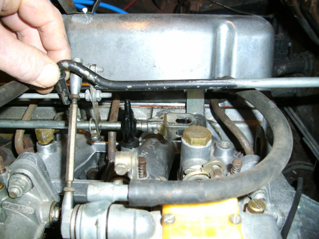

Nice looking engine bay, that's for sure. First thing first, those pipes are US smog pipes, they are going to come off, but i forgot the plugs i have at home. I can clearly see your point, sharp eye, but the rod aligns up with the SU's, if you take a closer look, you will see that on the right side of that dog bone, mine looks different than the one in the photo you posted, it came like this, my car is a -73 240Z US model, can the earlier models be different or can this intake be from a Skyline model ? I'm not in to getting another intake, so please no more comments like that, i like to get this running with what i have and yes i will swap those crappy rose joints, found some with bronze liner in UK, less than 5£ each, just need to know what thread size and pitch there is in the manifold, this is a retro mod, to my matching numbers engine, when i get to build my L28, it will be with ITB, crank triggered ignition and Megasquirt, but that's a whole other story. NZeder, thasnks so far. Chris
Okay, here is some photos, as you can see the manifold linkage sits way lower and towards the valve cover, about 50 millimeter to low and 30 millimeter toward valvecover. Lurch, in the manifold is cast Lynx and D240-260. Chris
