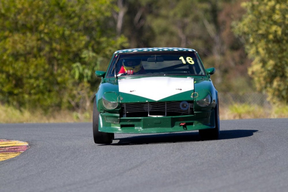

No problem running with a CIG locker, I did for many years with no problems. I just made sure my set up took that into account. Hopefully this post gives you a bit of a comparison and where you may head to in setting your car up. It seems like there is an inherent balance problem with the car that needs to be resolved first before you go looking at ARB adjustment. As Lurch stated, adjusting roll bars is the last step after everything has been sorted. I would be going back to basics and looking at the simple things, spring rates, dampers, wheel alignment and even bushes being used. It's been a long time since I had the green monster but here was the suspension set up it had from memory: Koni adjustable dampers Car 240Z built to CAMS 2B rules, track only running 18"x8" wheels with full slicks. Standard struts with spring perches dropped 2 inches to lower static height of car whilst retaining full spring and shock length. Rates - front 450lb/inch, rear 420lb/inch The front arms and location were standard, but the rear was played around with a little to try to get some anti-squat and anti-dive happening. Bushes were a mix of nolathane and rubber front and rear to tighten up the suspension on general, but let it move where it needed. Front bar was from memory one size up from standard, but hazy on that, and with no rear bar. Slicks were 240/640/18, it also ran 225/50/15 Toyo RA1's as wets or hillclimb tyres on the same set up. In the wet on the circuit it still worked very well, but you could overpower the rear tyres pretty easy. For hill climbs, I could light up the rears for first and second if I showed no symapthy, but a dry hill climb run was pretty predictable Power was 200rwhp and plenty of torque, 210 or so ftlb. The motor was a lazy truck motor, so didn;t rev hard, but pulled better than a 14 year old. In a car with a proper LSD it would be very oversteery, as it was set up to try to remove the understeer inherent with a locker. You could induce oversteer with hamfisted use of the throttle at corner exit, or if you jumped on the throttle too quick would induce understeer as the diff tried to push you straight ahead. Once we had the damper adjustments sorted and a preferred wheel alignment, basically as much castor as we could and as much front neg. camber we mainly played with front and rear toe, and I can't remember what we ended up with, but it was checked a couple of times a year and that was it, never touched it once we had it sorted. This picture shows the car at full suspension travel (droop on the front right, compression on the front left and just starting to apply throttle taking a very late apex for the run down the hill) at Eastern Loop at Lakeside. It was very stiff compared to most zeds when it was built.
