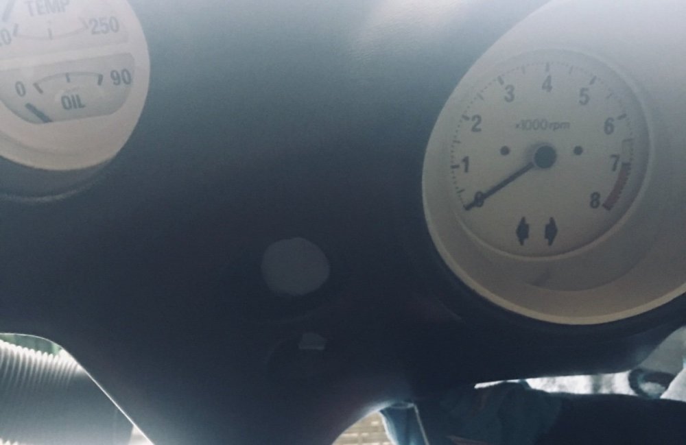

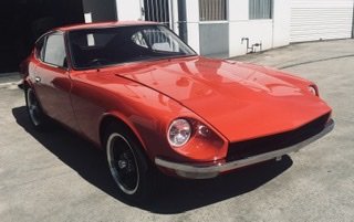

  7. Here’s the plates, and holes in the dash. Yep, 919 yellow from factory. I’ll add the hazard wiring to the dash wiring tidy up l’m completing now. I had no intermittent speed on the wipers when I purchased this Z, I changed it over to intermittent, then 2 more speeds. The colour got changed by the previous owners to diablo red I think. I Kept it diablo red. You can see it in the profile shot. Looks similar to sjcurtis post, on June 30, 2006. No writing near the glovebox. The dash was re-skinned before me in beige, then I dyed it back to black. Might be “abitza” Z, thanks for helping.
  8. A bit of back ground. When I bought the Z, it didn’t have a choke, had a destroyed console, peeling door skins, L28 motor, no hazard switch, tons of little problems, and rust through out the body. I drove it for four years, then stripped it completely. That was 18 years ago. Now almost completed the rebuild. I have the drive line, and running gear all sorted. I’m searching for info about the option this Z had, like hazards, three speed wipers or two speed. Is there an Aussie site to find out where this Z was bought from originally? There is no log book or similar with this Z.

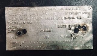

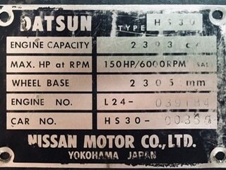

  10. This is just a reference another site used to tell the difference between the 240z badged 1/4s, with hatch vents, and the Z badged 1/4s, without hatch vents. I’ve read that this designed changed on June 1971. HS30-00866 (wrong number sent before).
  11. The date on the plate is 6/71. This is the change over between the so called series 1 and series 2, or so I’ve read.
  12. HS30-00899
