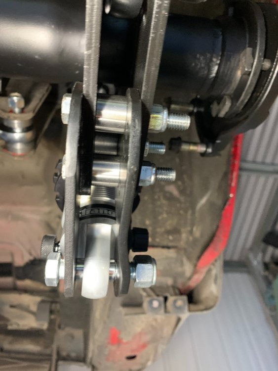

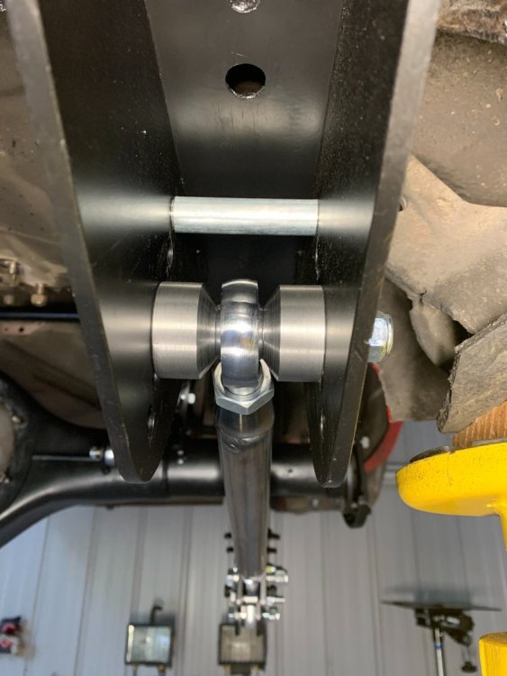

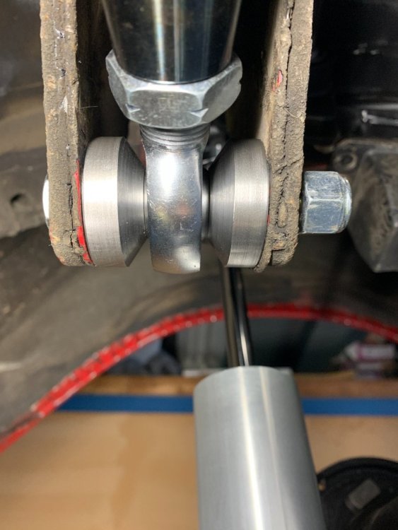

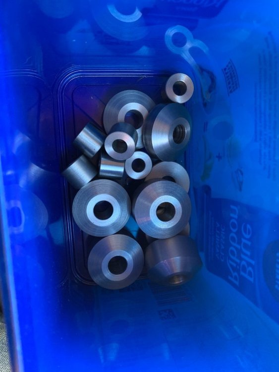

  2. Bit of a waiting game at the moment......turbo is ordered, pistons and rods ordered, 9" centre is ordered. Good news is that spacers for lower shock brackets, panhard rod and front 4 link mounts are done:
    1 point
