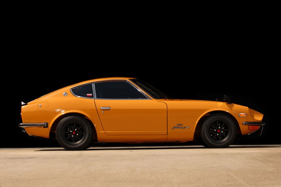

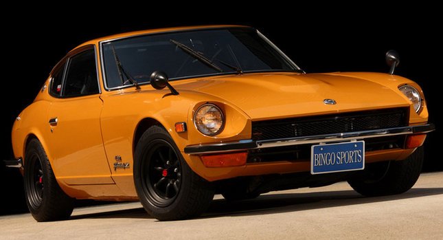

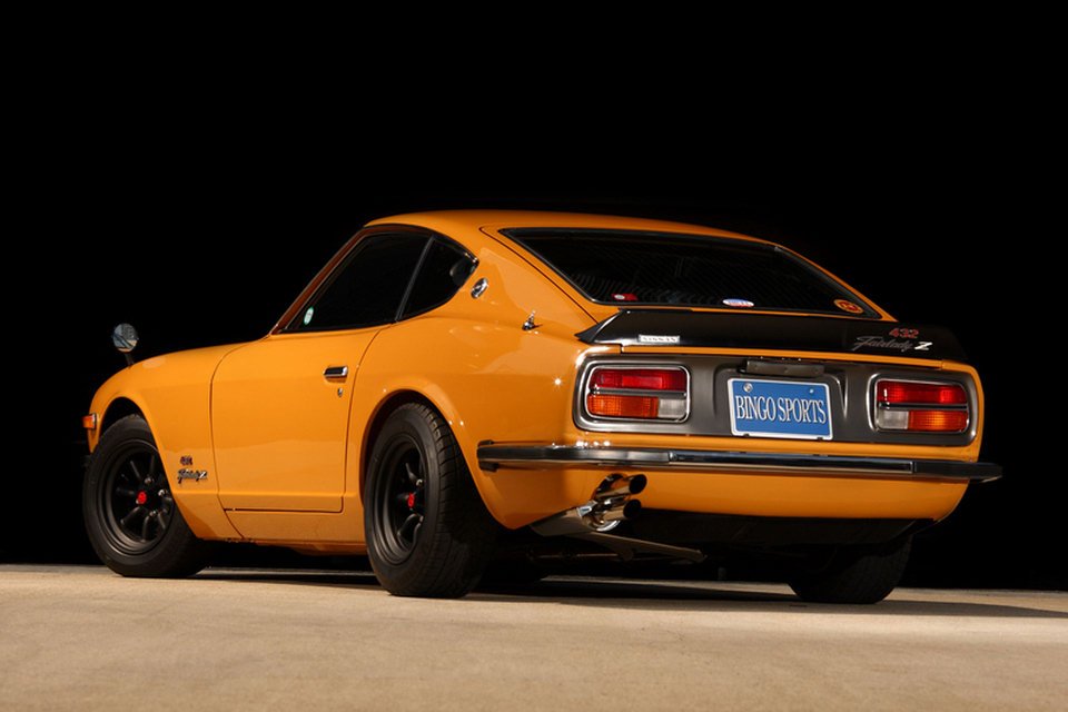

The pic you have there of the Z432 is 918 orange i reckon

As for colour of 432 not sure if 918 or 920 or something custom.
These is one of the 920 coloured 432 the rest are on my pc at work
Dat240z balls yeah maybe but more like Kato said don't get scared easily. Like a challenge. Plus this car has bit more sentimental value so couldn't cut it for parts. As long as i got time and motivation any tin can be repaired and improved. This z no different.
It will have all stock parts on it but will use different wheels and bre front spoiler and jdm chrome fender mirrors for personal touch.
The 'Bingo Sports' 432 that luvemfast posted pics of is 918 orange. The 432 from Nissan's collection and website is 920 Gold.
I painted my 432-R replica project in 920, and it's impossible to photograph. Never looks the same colour each time. Flash tends to bleach it right out too.
