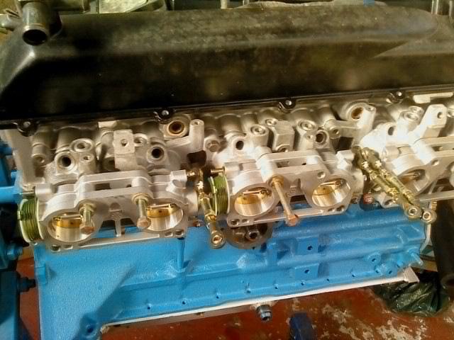

luvemfast Posted August 14, 2012 Posted August 14, 2012 hears one for you When are you getting back on the NC Peter? Quote
peter mc Posted August 14, 2012 Posted August 14, 2012 building a crank for it now Simon . 3.4 tc Quote
NZeder Posted August 14, 2012 Posted August 14, 2012 building a crank for it now Simon . 3.4 tc race gas only or pump gas? Quote
NZeder Posted August 14, 2012 Posted August 14, 2012 Nice and with the cc to go with it as we know you can get enough flow from an L6 head with work/mods so the RB26 heads have more than enough for under 2800cc in NA form so all that extra cc will help alot Quote
peter mc Posted August 14, 2012 Posted August 14, 2012 The reason you need to go big in engine size is because the Rb26 head is 63cc in the chamber and that means the comp would be so low , the head i have has been welded up by Les. so i have made it 53cc and with the 89mm stroke and 90 bore its a bit easyer to get the comp up with out having a silly bump in the piston Quote
