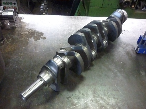

peter mc Posted July 27, 2012 Posted July 27, 2012 new 3.6 L stroker in the build with new levels of build , with all the latest water mods . Quote

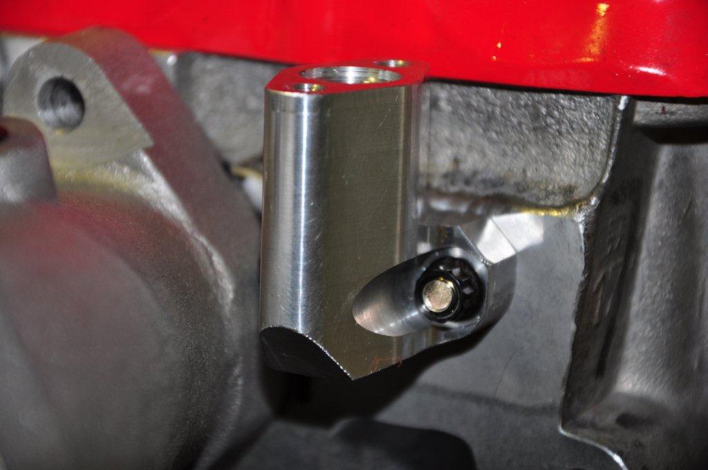

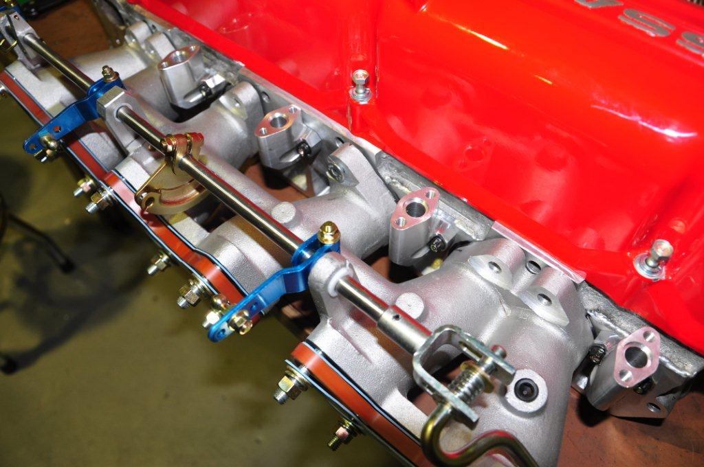

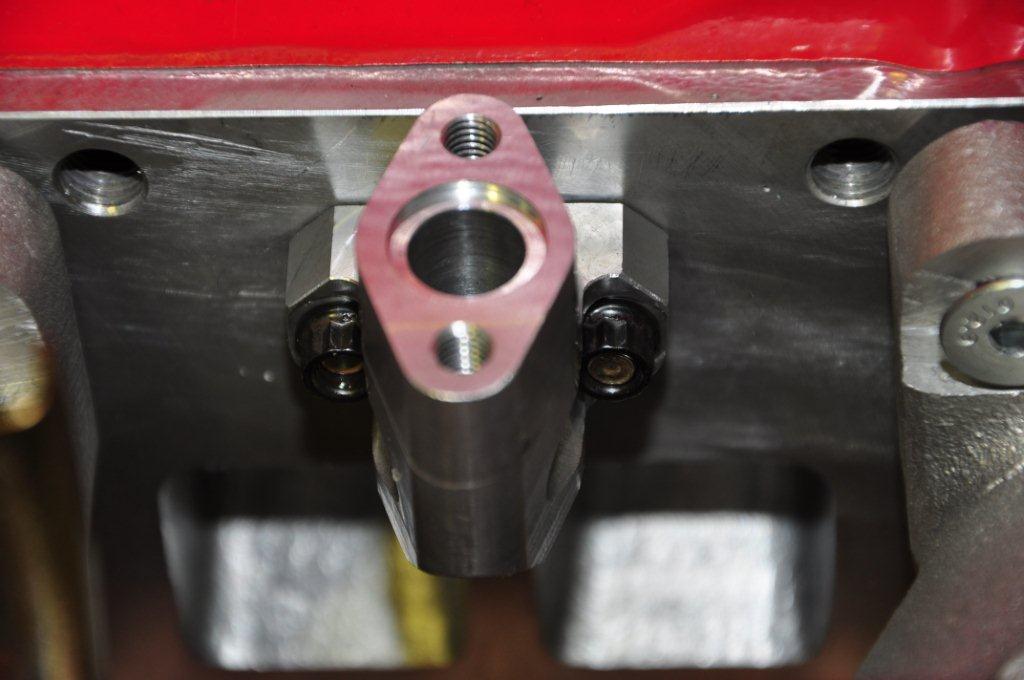

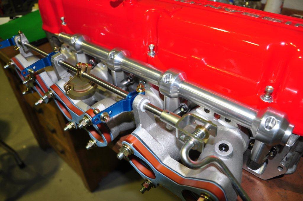

peter mc Posted July 27, 2012 Author Posted July 27, 2012 When we were tuning the 3.4 over 330 hp the plugs were hotter at the rear and it was very hard to tune we had 6 sets of jets in the engine to get the right fuel mix and cylinder 5 was just to hot so we drilled all the casting flashing from the inside of the head and then run a -6 water line from the top of no5 and we ran it up again and we got the tune back to where it would live . in this engine we went even more into the problem and built this water log to remove hot water from over the exhaust ports . all cylinders run the same temp and jeting and timing now =more power Quote
dazzed Posted July 27, 2012 Posted July 27, 2012 dont mean to be ignorant but what is the shaft in the pic you are holding up against the wall , just trying to figure where it fits in Quote
Administrators gav240z Posted July 27, 2012 Administrators Posted July 27, 2012 dont mean to be ignorant but what is the shaft in the pic you are holding up against the wall , just trying to figure where it fits in Look at the 2nd pic Quote
peter mc Posted July 27, 2012 Author Posted July 27, 2012 the shaft fits over the 3rd pic daz and the hot water over the exhaust ports runs thro it to the thermostat and on to the rad from there Quote

Riceburner Posted July 28, 2012 Posted July 28, 2012 Wow. Amazing stuff Pete, the attention to detail just blows me away Kinda reminds me of an FIA head........ Where do you go from the exit of the pipe, tstat ? Keep up the awesome work! Quote
peter mc Posted July 28, 2012 Author Posted July 28, 2012 it still runs a thermostat in the normal spot but we made a new housing with two hose ends all will be seen next week Quote
benny Posted July 28, 2012 Posted July 28, 2012 wow!! love the setup. Is the pipe done on a lathe then machined or is it all machined?? Quote

peter mc Posted July 28, 2012 Author Posted July 28, 2012 all the parts were CNC and LES did all the drafting work Quote

RB30X Posted July 29, 2012 Posted July 29, 2012 I see provisions for a throttle cable and the factory linkage from the rear? Quote
dazzed Posted July 29, 2012 Posted July 29, 2012 Look at the 2nd pic oh yeah i just thought that was the ballance tube it got it , like even water temp throughout the motor cooll Quote
