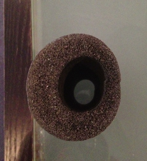

Riceburner Posted March 12, 2013 Posted March 12, 2013 So I guess the next question is, how do you know what type of padding it is. And the scrutineer will need to no as well. I got mine from brown Davis but there's no markings or tags to say what it is. It's much fatter on one side than the other. So I'm not sure how they will be able to tell, the pool spaghetti looks very similar. Quote

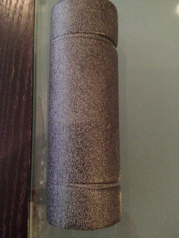

Riceburner Posted March 12, 2013 Posted March 12, 2013 the new padding looks nothing like the old stuff its a firm pad, i got my new stuff today Can you put a some pics of it Pete? Here's the stuff I got from brown davis. How do I know if it's going to pass? Quote

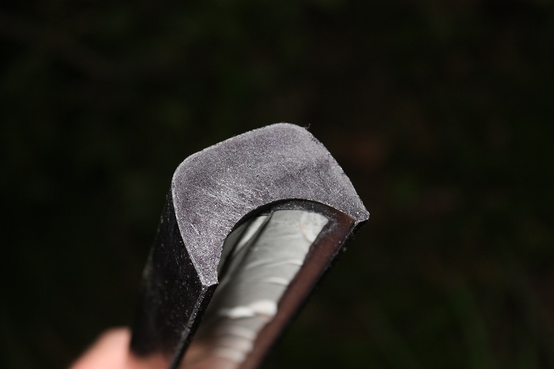

1600dave Posted March 12, 2013 Posted March 12, 2013 This is the stuff I used for the helmet space - very firm, not like foam at all. The one above with the offset centre is the one I used in non-helmet areas. SFI standard is embossed into the surface. Quote
Moderators Zedman240® Posted March 12, 2013 Moderators Posted March 12, 2013 Scrutineers will probably look for that stamp..I would! Quote

peter mc Posted March 12, 2013 Posted March 12, 2013 Thanks dave , i was taking a pic , thats the stuff Quote

Riceburner Posted March 12, 2013 Posted March 12, 2013 Just got more new padding, the new sfi45.1 stuff is rock hard! The only other difference is its fire rated and a rip off! I'd rather have the old padding, it's very hard compress with your hands but at least there's some give in it. Fire rated padding is just over the top, how many other parts of a 40yr old Datsun are fire rated? Not many. This new garbage doesn't even go all the way around the bar, so who's to say in a roll over it won't move enough that side of the bar closest to you/your head becomes exposed? What a load of crap this is!!! CAMS.... Making entry level motorsport more inaccessible to everyday people! Quote

Riceburner Posted March 13, 2013 Posted March 13, 2013 That's before GST! The other thing is this new 'padding' is super hard and my helmet goes close to the cage. I can see it getting scratched and marked very quickly, then I'll be told I need a new helmet Quote

Gordo Posted March 18, 2013 Posted March 18, 2013 Sorry to keep going on about the padding. But it is s#% t. Tried to bend it to follow the main hoop, from the drivers shoulder up and over the head, about 80%. Gave it a bit of heat as suggested and it clean snapped in half like a French bread stick. Bugger! Quote
