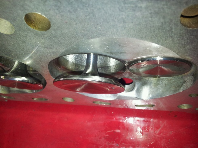

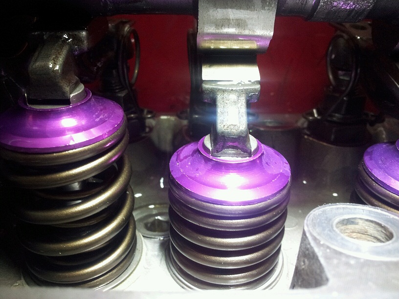

peter mc Posted March 27, 2012 Posted March 27, 2012 Here are some pics of a head I'm repairing for Gordon ('GL240GTR' on here). Basicly the only things that were kept was the head casting itself . New parts include: Reground cam, Valves, Valve guides, Springs, Lash Pads & Retainers, plus a little more porting work to the inlet and exhaust on the short turn, and cam towers , More pics later... Quote
C.A.R. Posted March 27, 2012 Posted March 27, 2012 Looking good Pete - better than when I last saw it! I would have thought you'd machine a little less seat on the valve though? Looks fairly wide from the photo...? Quote
peter mc Posted March 27, 2012 Author Posted March 27, 2012 i think the pics not very good there is 3 angles on the valve the seat 45 angle is 1mm all my heads will be done by hsd from now on there work is top shelf i don't think i have seen work like it for a long time all seats are exact i could not folt any thing they did . head stud dev in Melbourne if you wont good seat work Quote

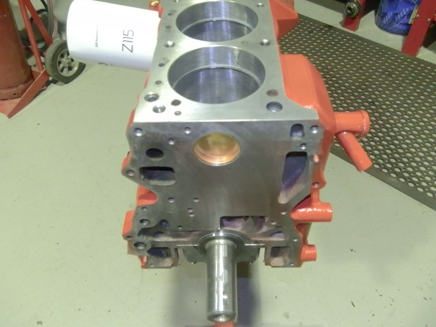

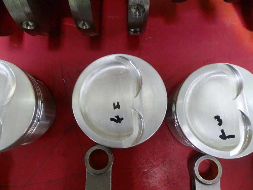

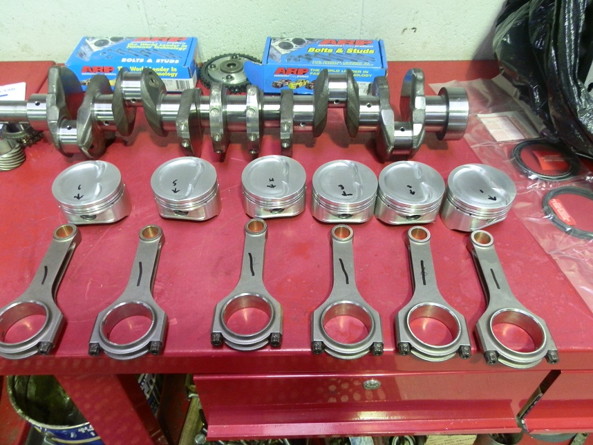

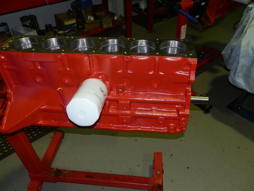

peter mc Posted May 7, 2012 Author Posted May 7, 2012 Some pics for gordo , its all go now new forged pistons 89mm new rods H beem 140mm new block and regrind on the crank arp studs head and mains and sump from arizona more pics tomorrow Quote
