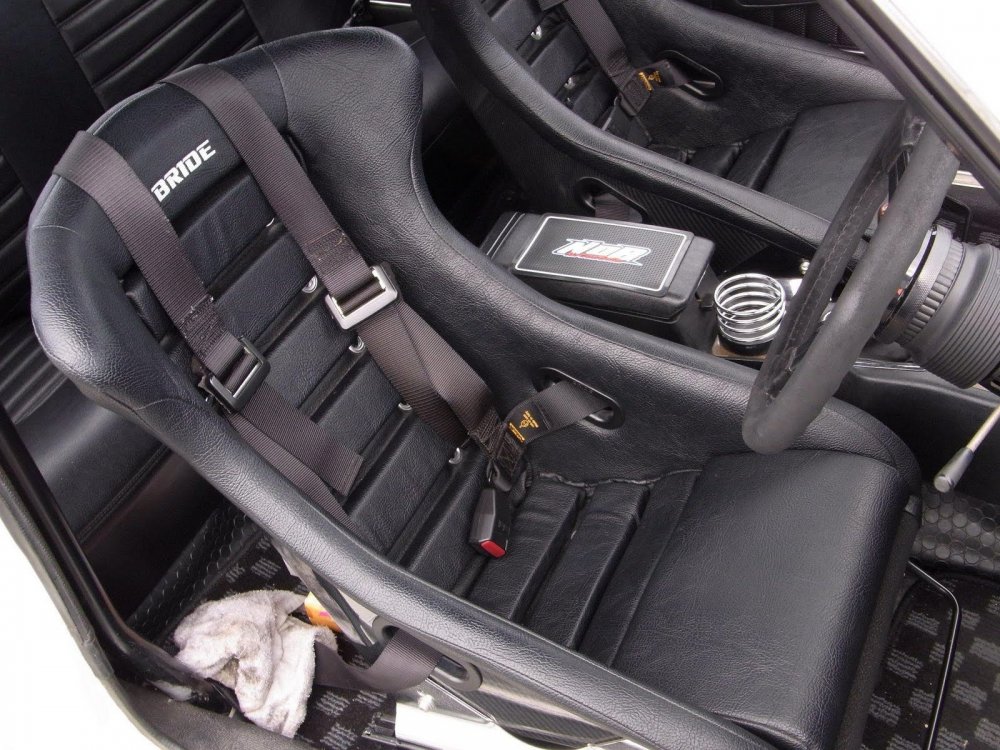

zedevan Posted January 12, 2012 Posted January 12, 2012 Bride histrix - although i believe they are rather expensive Quote
sexual_sushi Posted January 12, 2012 Posted January 12, 2012 Histrix are sex on umm rails about $2000-$2500 each. If I'm rich and build another 240z at some point I'll be getting these Quote

PZG302 Posted January 12, 2012 Posted January 12, 2012 If you use a harness the bride histrix will kill you!!!!!!!! When using a harness you need a propoer seat with well located harness holes.If it's to be used with standard lap sash belt then all OK. Quote
DTF260 Posted January 12, 2012 Author Posted January 12, 2012 Might be a stupid question but, what's wrong with the harness on the historic in that pic? Quote

PZG302 Posted January 12, 2012 Posted January 12, 2012 Might be a stupid question but, what's wrong with the harness on the historic in that pic? As it sits over the top of the seat it will move sideways and in a hit can/will slip off your shoulders, which won't give any protection. In my hit in July my harness stretched about 3-4 inches, as they are designed to do. If they weren't held in by the seat location holes who kknows where they or I would have ended up. The rear mounts for the shoulder straps are also critical, they must be attached at the appropriate angle, about a max of 30 deg from horizontal IIRC. Quote
