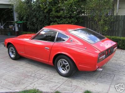

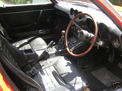

240Z_au Posted June 12, 2011 Posted June 12, 2011 Hello everyone. Thought to share with other Z owners my latest project. I have owned 240's since I was 17 y.o, I'm in my 40's now. I bough this car on ebay about 3.5 years ago. It was a site unseen from country Vic. owner who had the car stored in a shed for 5 years, this was after buying the car from a friend of his only a year earlier, the friend had it stored for 11 years prior. (combined 16 years in storage). In the last 3.5 years I drove my Z occasionally with group of Z owners here in Sydney and on some selected weekends. Late last year, I took the car on a 7000 km drive (in 6 days) in the outback. This was a very first drive of this kind for me in a very old car. The car is a 1973 build. For the last 3.5 years I slowly worked on what I though needed attention at the time, there was a small oil leak from the rear seal, which encouraged me to drop the entire gearbox and recondition all of the synchros and put a new clutch and a lightened fly wheel . I have also replaced shock absorbers (adjustable koni) as well as fuel pump, all of the engine seals and gaskets (still running original L24). Earlier this year I decided to tidy the interior up and bring it up to its original look. I've replaced all carpets, vinyls and re-trimmed seats. Everything on the car was in a reasonable condition, but I really wanted to have a very clean looking Z with as much of the original character of the car left over as possible (not looking for pure originality per say, just clean, tidy, period look with everything in great shape, working and without any obvious signs of things being worn out). I will post some pictures of my rebuild progress as I go along. This time I'm looking to change the color of the car (wont do the engine bay just yet as I know when I decide to pull the engine out it will be a mater of months before I get it back on the road and I will want to place a high level of detail, replacing or renewing all of the tired looking plastics, rubbers and coatings. On Friday I decided to get the car ready for the paint shop. As the panels have been removed, the condition of the car is nothing short of remarkable in terms of the metal panels and the lack of any rust. Having owned several 240Z's, I was aware of the usual trouble spots, but this car as can be seen below has literally no rust. Above, my 240Z getting stripped yesterday among some notable exotics, I've been hooked on 240's since my late teens and my very first car was a black 240Z, thinking going black again, but I know the pain of the dark colour, so haven't decided on the final colour yet. Quote

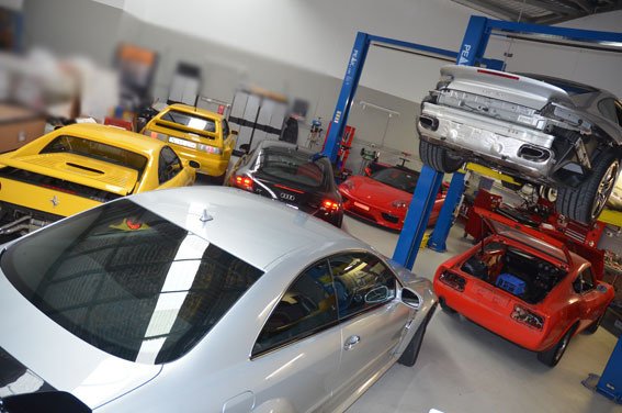

chris240 Posted June 12, 2011 Posted June 12, 2011 welcome. 1st question....whos workshop is that !!! you could buy 128 zeds for the price of those exotics Quote

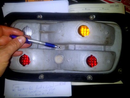

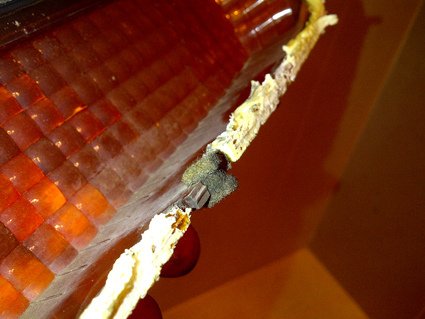

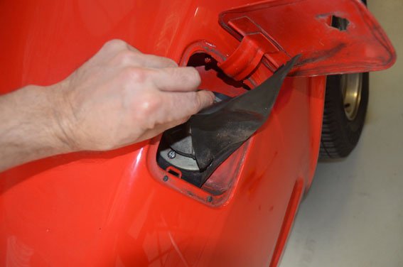

240Z_au Posted October 2, 2011 Author Posted October 2, 2011 OK, so I have not time, but I love my Z too much to just do a quick respray...SO...Yeah, I've swollen the restoration bug, again. I'm only limited to time again on what I will or will not do, but finally managed to spend some time in the garage yesterday and though to start on the rear end. Took one look at the rear lights and decided to bring them back to as new condition. Mud from my outback trip last year, slight exhaust residue on the left side reverse light (you know that side always looks darker) and 5 hours later, the lights are still not on, BUT!, they are like new again Will be detailing chrome, black paint in between lights and reassembling the lights etc this week. The rear light panels off to the paint shop. Not sure if to keep original colour or go black, we'll see. Quote
Agno Posted October 2, 2011 Posted October 2, 2011 Love your work! Do you have any hints or tricks about cleaning these lights? Did you take the lenses apart and then stick them back together? Cleaning the tail lights is on my to do list along with a few other things Quote
Brabham Posted October 2, 2011 Posted October 2, 2011 Hi, How did you clean the lenses? Cheers. Quote
Administrators gav240z Posted October 2, 2011 Administrators Posted October 2, 2011 Love your work! Do you have any hints or tricks about cleaning these lights? Did you take the lenses apart and then stick them back together? Cleaning the tail lights is on my to do list along with a few other things +1 would be good to get a tutorial on what you did. It's s small thing, but man it makes a difference to the rear of the car. Quote
240Z_au Posted October 3, 2011 Author Posted October 3, 2011 Yeah, the difference is HUGE!.. Well here I go. - Removal of rear lights is pretty straight forward. Once you remove the interior plastic panel and the surrounding exterior light surrounds (3 pieces, left, right and centre) the bulbs and the electric harness just come away from the light assembly. Old twist and pull bulb holders are nothing complex. - I have soaked the entire light assembly in very warm, slightly soapy water (Palmolive!) for few minutes. Just wanted to loosen up stubborn inside stains and the lens glue. I used a soft paint brush to then clan external rubber and plastics (grey plastic which holds the amber, red and white lens was full of red dust and layers of general dirt & grime. Pay attention to the reflector surrounds on the red brake part. The parameter of the reflector has a 1mm gap all around, if you want that perfect finish, get in there with your soft paint brush and remove years of grit build-up from all 4 sides of the reflector. - With the lights dried up, I proceeded to remove the back clip which protrudes through the grey casing. This is right in the middle of the rear of the light, you can see little plastic stump and a metal clip. Remove the clip with a modified screwdriver (2mm flat driver, slightly bent at the end, this is not easy, you can brake the stump as the clip fits tight and you have very little room to move. Few lights I have bought before have them broken already. Not a big deal as you can seal with silicone from the back if you break the stump head, but if you prefer things to remain the same even in the places you don’t see, do take your time and be patient. - Next, you need to pull away the lens from the grey body/casing. I was lucky here as one of the sides was little loose already, but I have previously warmed the light up in the over (150C, checking softness every minute or so) The lens is attached to the casing with a white, softish compound. It is NOT rock hard. If you place the light between knees and pull away both the casing and the lens, while someone else (yes a 3rd hand does help) pushes through the reverse light bulb entry with a rubber padded stick (I used my 20 y.o hand held valve seat grinder (wooden with rubber top), you should be able to break the white ‘silicon’ tension and pull away the corner of the light from the rest of the casing. - Clean the casing channel and the matching edge of the lens with “Desolve It”, an orange smelling stuff you spray on and leave for a few minutes, did not damage my light ( tested this on an old light first) and took all residue off easily and any other lens dirt with it. - I used AutoSol (yeah, I know it’s for metal, but works a treat on my lights also) and buffed the inner and outer lights. Watch out for original felt inserts in the bottom drain holes. If you don’t have them, I recommend you buy small scraps and make some up. I haven’t re assembled the lights as yet, but I plan to inject a small amount (1mm thin) of windscreen sealer (black) into the casing channel, which should do the job, being easy to clean up and remain flexible for future removals. While there, check your metal reflectors and the chrome divider (external part between the lower and upper section of the light). You can remove that also and give the part new black paint (between the chrome bars) and gently clean the plastic chrome. Have fun. I’m amazed I got sucked into this job, but it was like a disease I had to cure. I could not help myself with a new, clean paint job, new re trimmed interior, seats etc to just put these dirty old 240Z lights back on. Quote
