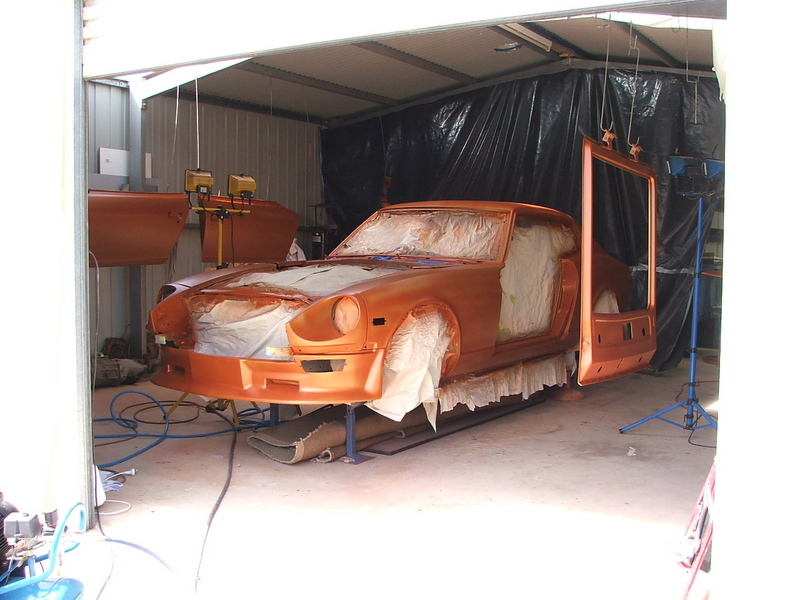

Linton Posted May 30, 2011 Posted May 30, 2011 well have been working in my car for a while wish I had more photo's I have repaired most of the rust but I will point out I am not a panel beater or spray painter just learnin as I go just learnt how to make the pictures small as well so here she is in the shed Quote
Linton Posted May 30, 2011 Author Posted May 30, 2011 on the home stretch now OH no How do I fix this :'( Quote

Linton Posted February 11, 2012 Author Posted February 11, 2012 thanks guys appreciate the support it looks even better close up, I have one little area of concern which I will fix today and its ready to rub back one last time, spoiler looks good to Gareth!! I have learn't alot on this build just hope I can manage the paint without stuffing it up there a first time for everything so I guess I am nearly a pro ha ha Joke!! Picky of me with my baby boy, (they grow em big down here) the donor car going to the tip such a shame Quote
Linton Posted March 9, 2012 Author Posted March 9, 2012 Well we have colour :D first base coat bit streaky gotta get on top of that I am putting on the final coat this arvo when it warms up a bit more Quote
Scoota G Posted March 9, 2012 Posted March 9, 2012 Great to see the progress made in 10 Months and how far she's come along. More pics tonite pllleeaaaseee Quote
RB30X Posted March 9, 2012 Posted March 9, 2012 If I learnt anything from my DIY paint job, its to put HEAPS of paint on so you've got some thickness there for when you wet sand to remove any orange peel etc. Any dont be dissapointed when the final coat dries and it doesnt look summernats quality, because a few hours wet sanding then using several grades of polish will have it looking a million dollars. Nice colour. Quote
Linton Posted March 9, 2012 Author Posted March 9, 2012 thanks guys had a great day I will sleep ok tonight. clear to go on tomorrow Quote
