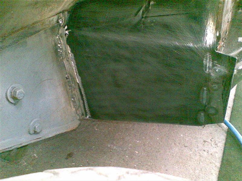

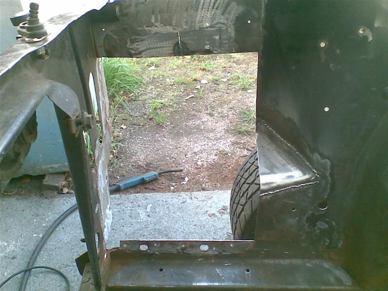

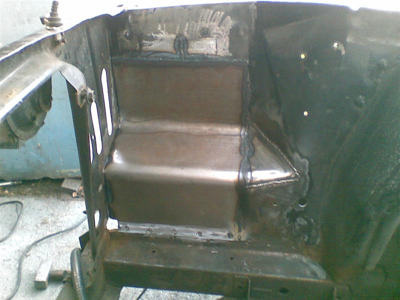

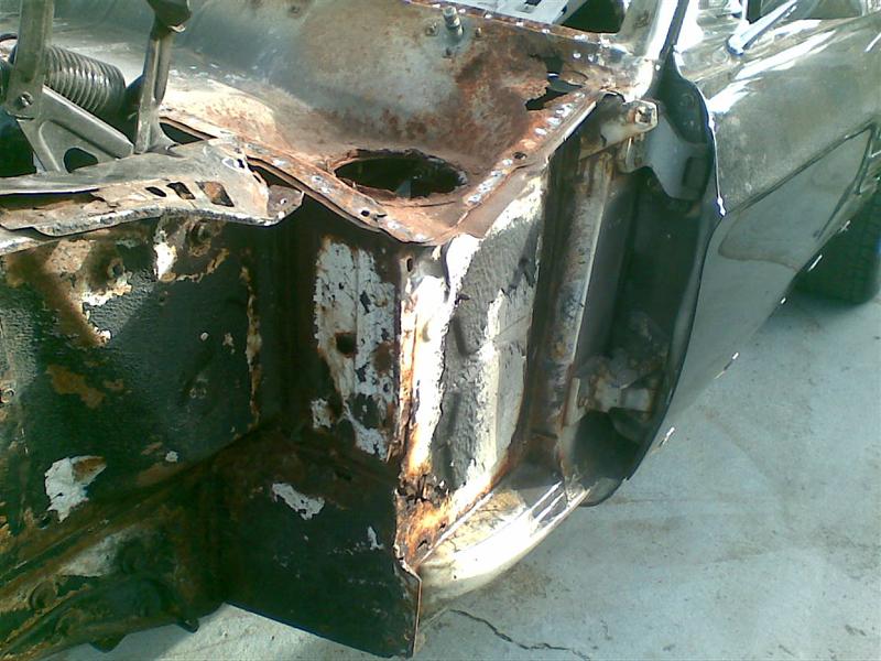

Scoota G Posted June 14, 2011 Author Posted June 14, 2011 The cowl is now back on and there was also repairs on both sides of the inner apron and fitting of two new apron extensions. One of the bigger jobs however was the battery tray area. Quote

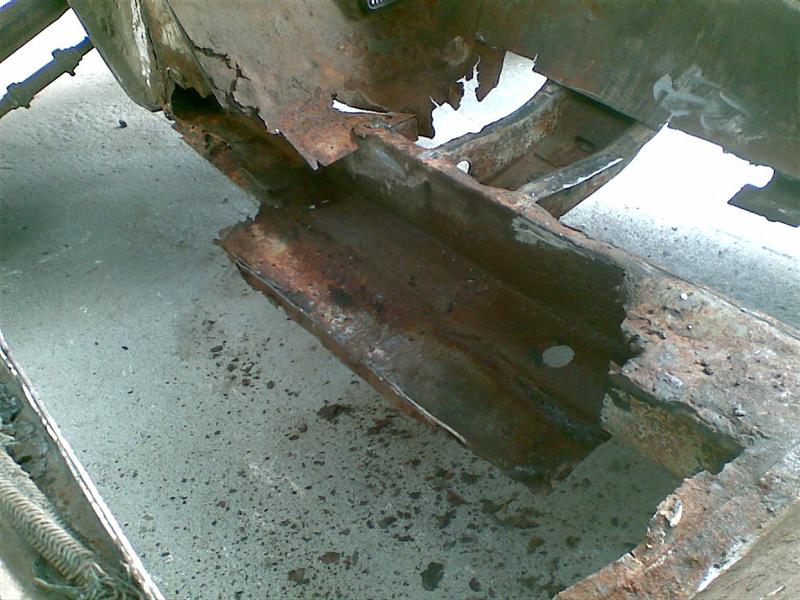

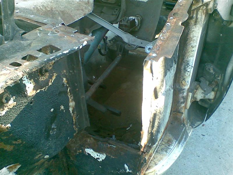

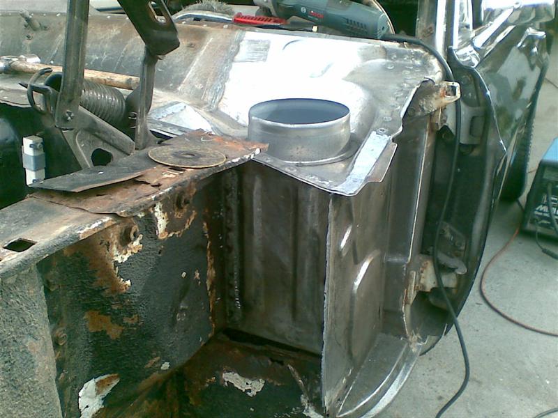

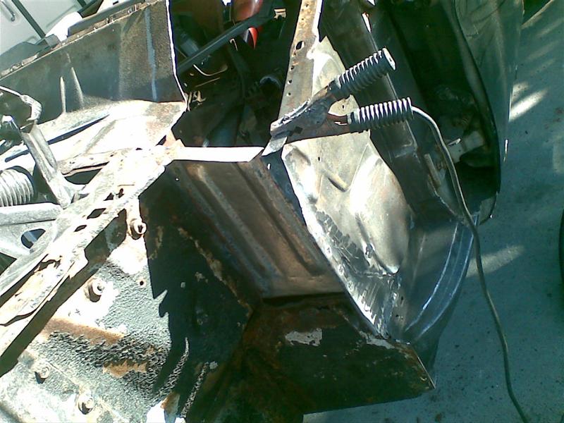

Scoota G Posted June 22, 2011 Author Posted June 22, 2011 With some repairs to the bumper mounts and a few other pieces it was time to move onto the Driver's Side Rail and Torque Box removal and replacement. At this stage i'm ready to refit the mechanicals and front panels. Quote

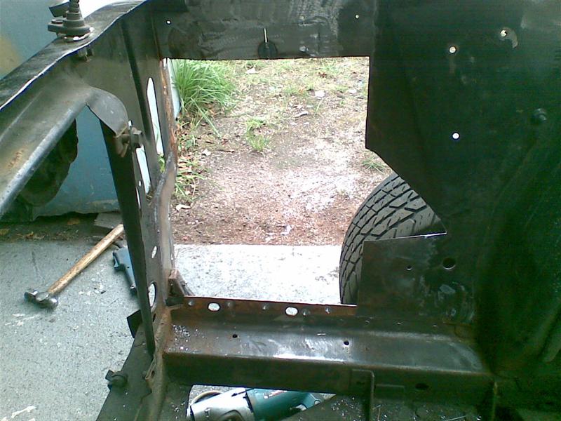

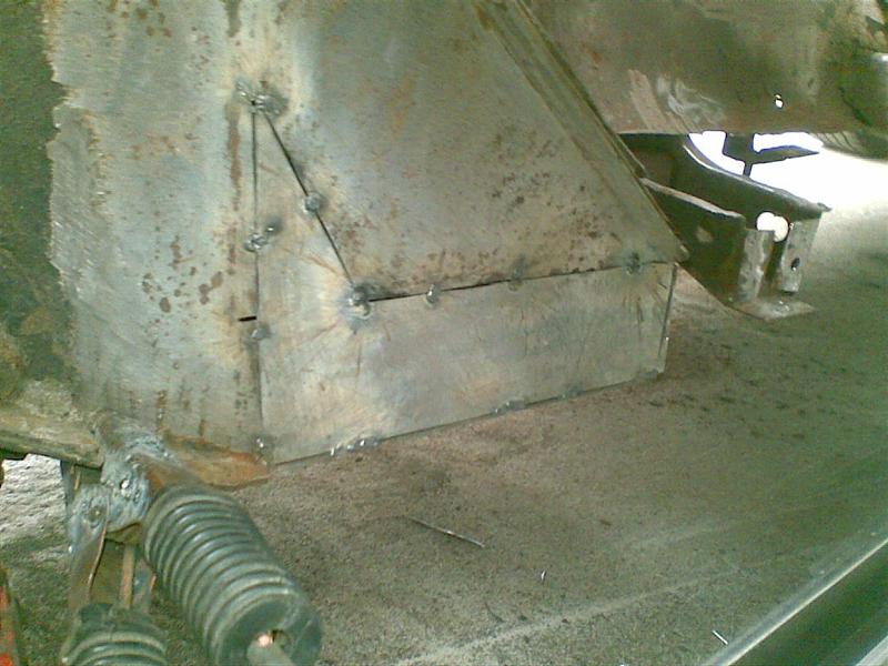

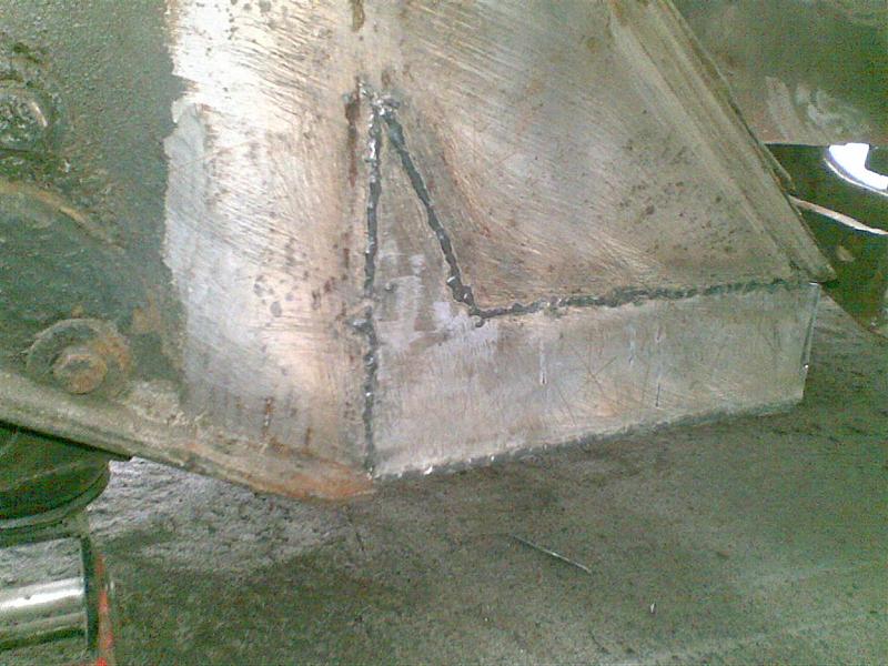

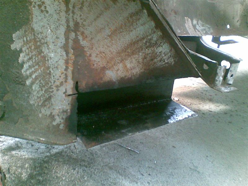

Scoota G Posted June 22, 2011 Author Posted June 22, 2011 Here's the repair to the rear of the front frame rail. This whole front clip was nearly junk but now . . . . Quote

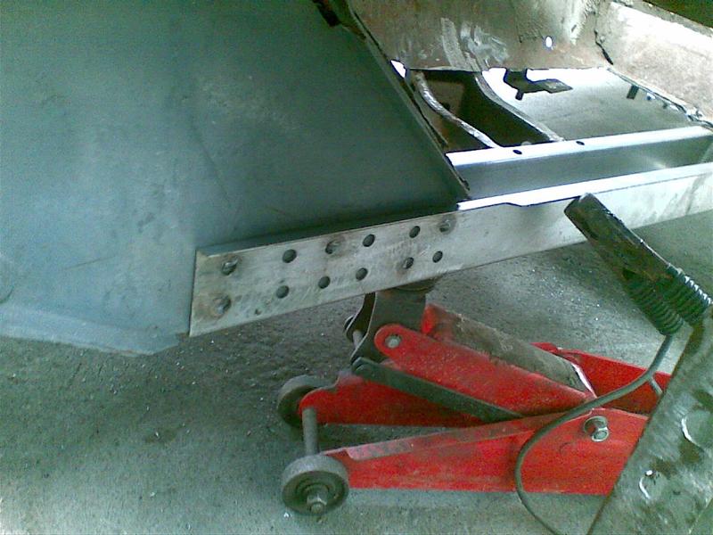

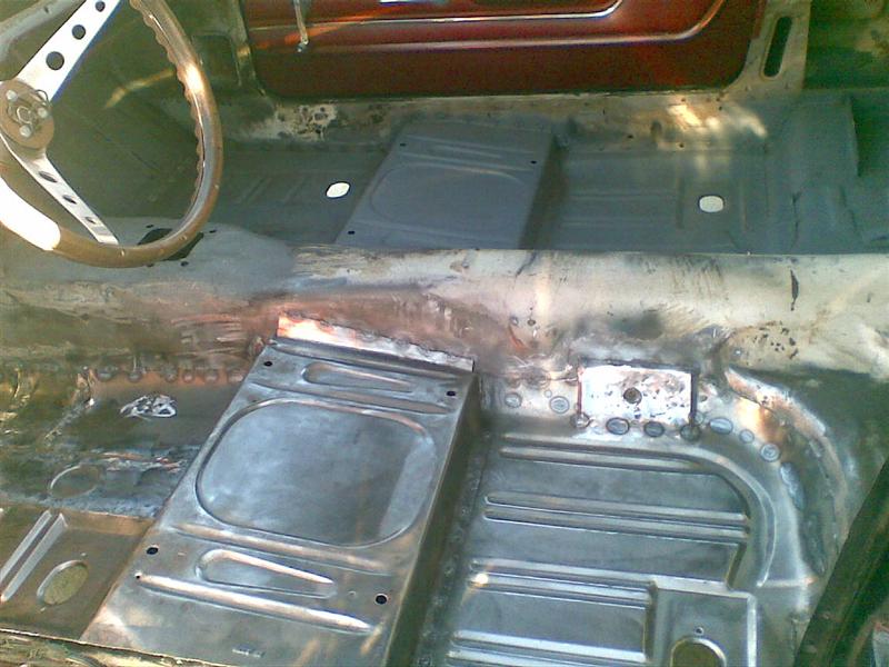

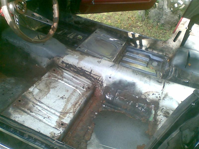

Scoota G Posted June 27, 2011 Author Posted June 27, 2011 If i ever get around to finishing my other 240z I know I've got you and Lurch to choose from I probably would prefer if you said Lurch or Scoota (to save me locking horns with the Bear ) but yea here we are and the Driver's side floorpan is fitted and i even got to use my special Aircraft Technology "cleco" panel holders which do work very well. Another day or two welding and i'll piece her back together, it's been fun sharing it with you guys and girl. Quote

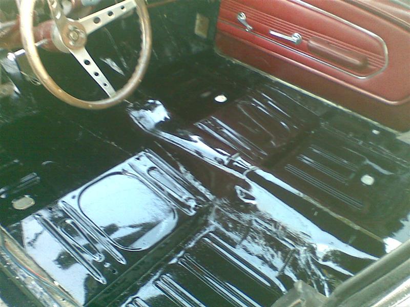

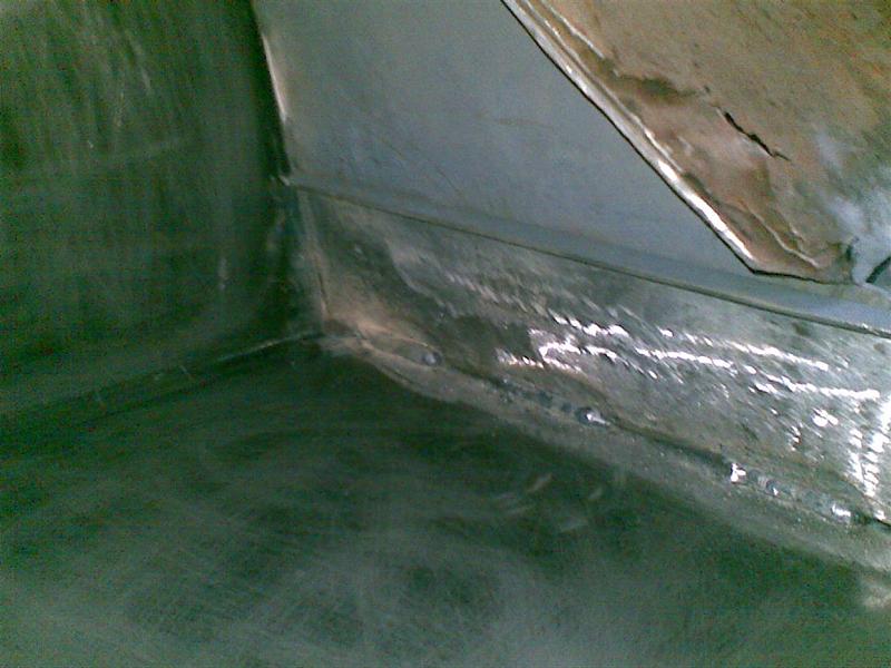

Scoota G Posted June 27, 2011 Author Posted June 27, 2011 much better then old signs!! Ahh yes the comparison shot. Quote

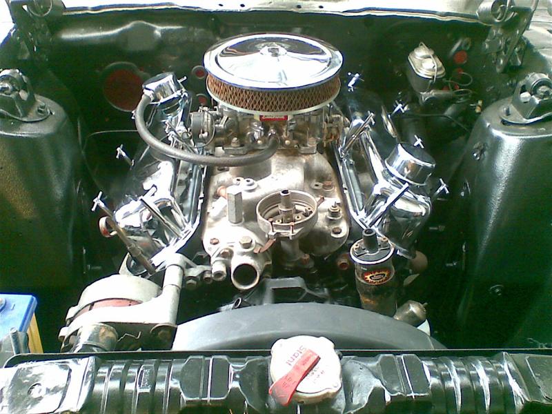

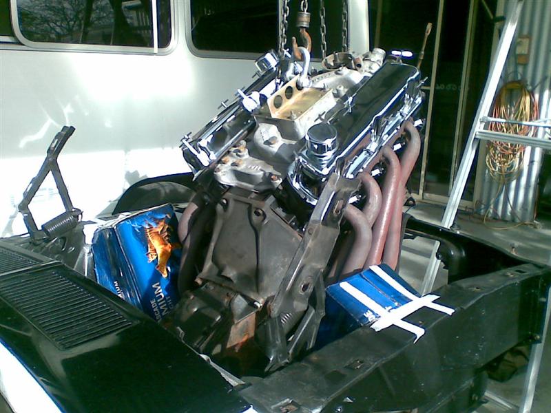

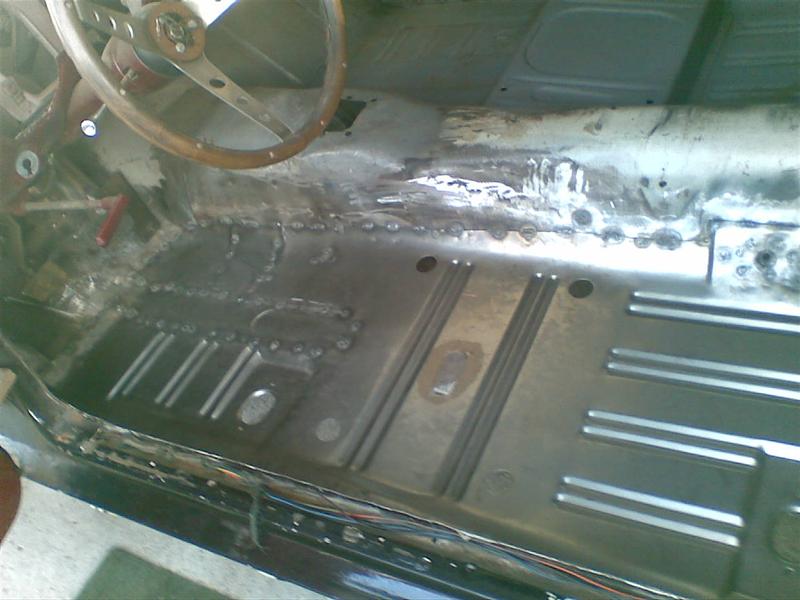

Scoota G Posted June 30, 2011 Author Posted June 30, 2011 Oh well time to reassemble this Ford!~! Quote
Bigfella Posted June 30, 2011 Posted June 30, 2011 Ahh yes the comparison shot. This may be a stupid question. Do you weld all the way along the seems or just leave them as welds every couple of inches Thanks Matt Quote
