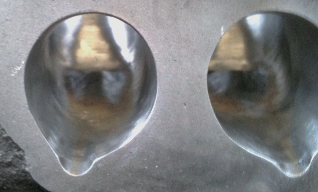

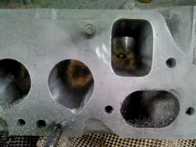

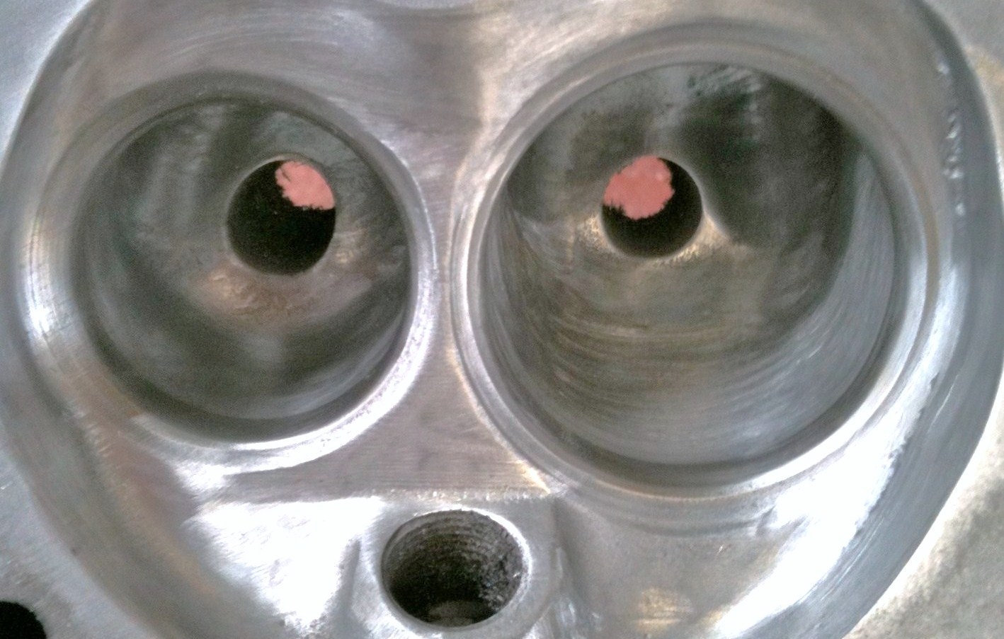

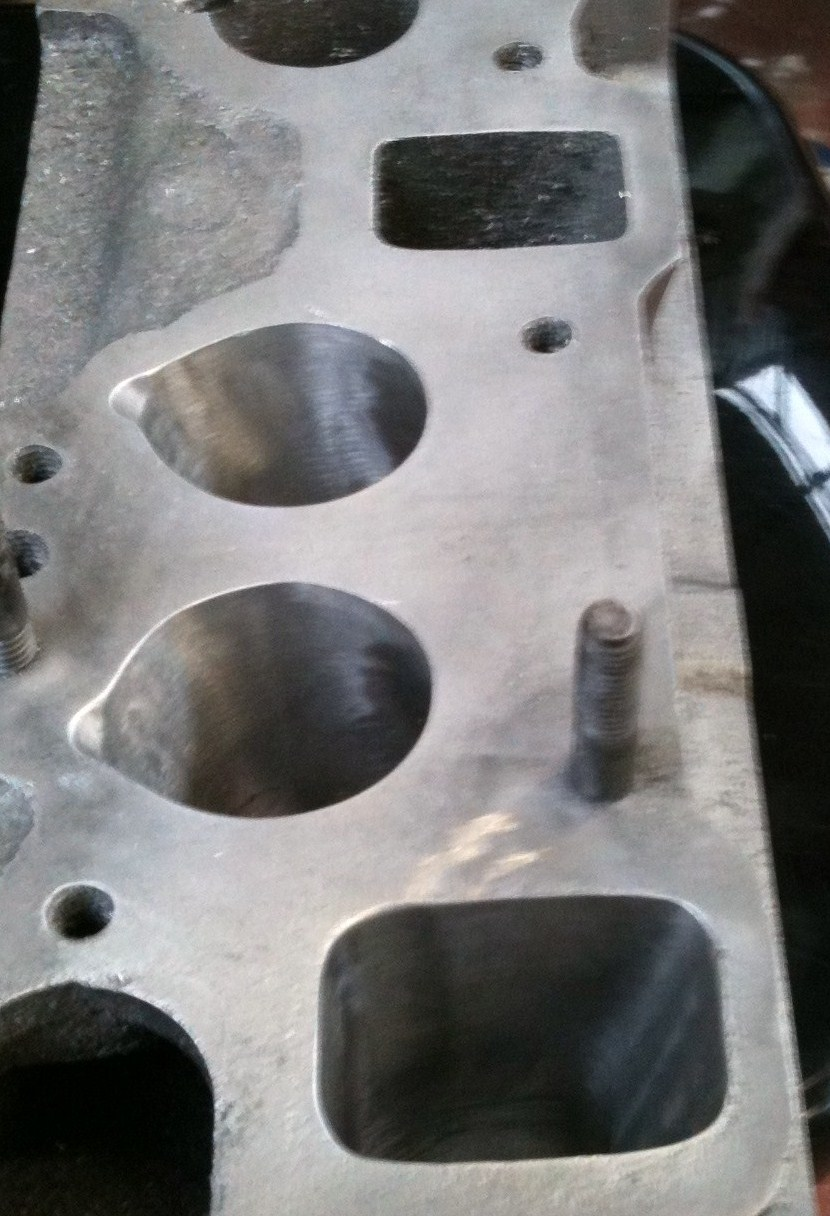

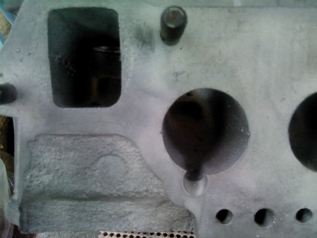

peter mc Posted December 19, 2010 Posted December 19, 2010 some head pics for the porters out there Quote
Bruce Posted December 19, 2010 Posted December 19, 2010 hi Pete, can you post a pic with a standard head to show the comparison? cheers Bruce Quote

peter mc Posted December 20, 2010 Author Posted December 20, 2010 this head is a p90 that i am doing for a auszcar member will post pics later Quote

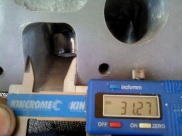

nat0_240_chevZ Posted December 20, 2010 Posted December 20, 2010 got any pics to show how far the guides stick out? Quote
kolonelklink Posted December 20, 2010 Posted December 20, 2010 NICE. thank you very much for the visuals on our earlier discussions about ex. porting -a true artist doesn't hide his gifts! those look fantastic. -pete Quote
peter mc Posted December 20, 2010 Author Posted December 20, 2010 will give full flo results in the new year. test on inlet port showed 230cfm at28' 550lift with stock valve and ex port 155cfm on the outer ports .it will be a grate head. these figures were with standard Gide's new ones are much nicer as they are 8mm shorter and tappered Quote
DatPilot Posted December 21, 2010 Posted December 21, 2010 What kind of $$$ would be reasnoable for such work? Quote
peter mc Posted December 21, 2010 Author Posted December 21, 2010 arrr this head will be the last datsun 6 head as they take me close to 40hours in the ports alone and then i have to set the springs and cam up the head will end up costing me more than i can charge.the same head from japan costs $5000 with cam and springs. Quote

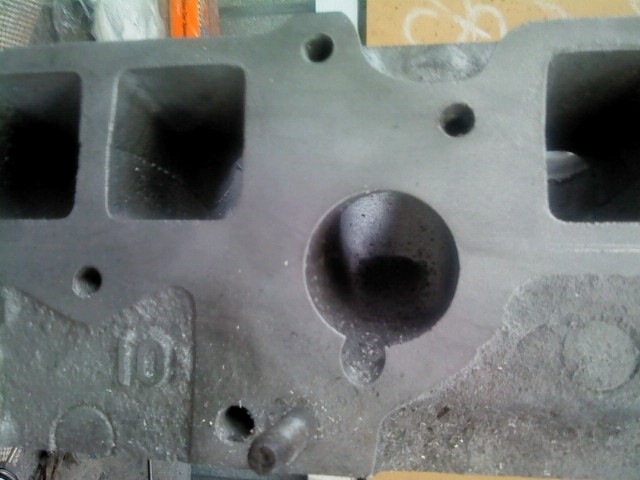

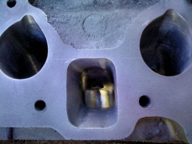

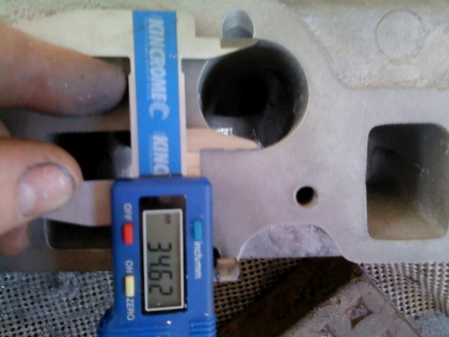

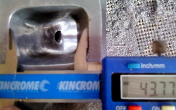

peter mc Posted December 28, 2010 Author Posted December 28, 2010 hope these can help the home porters Quote

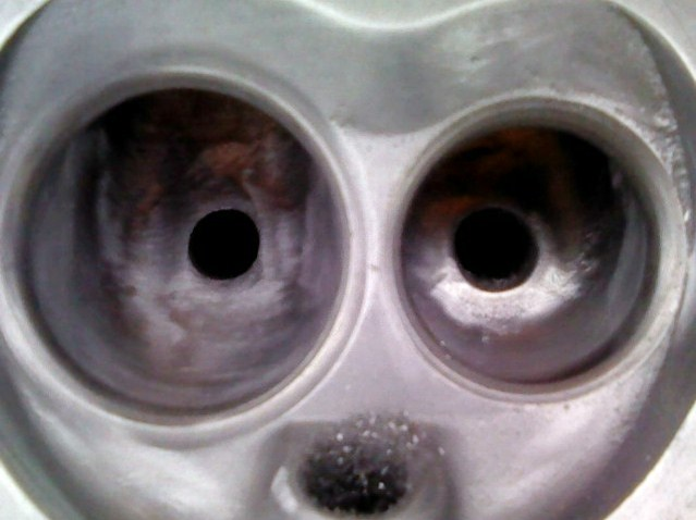

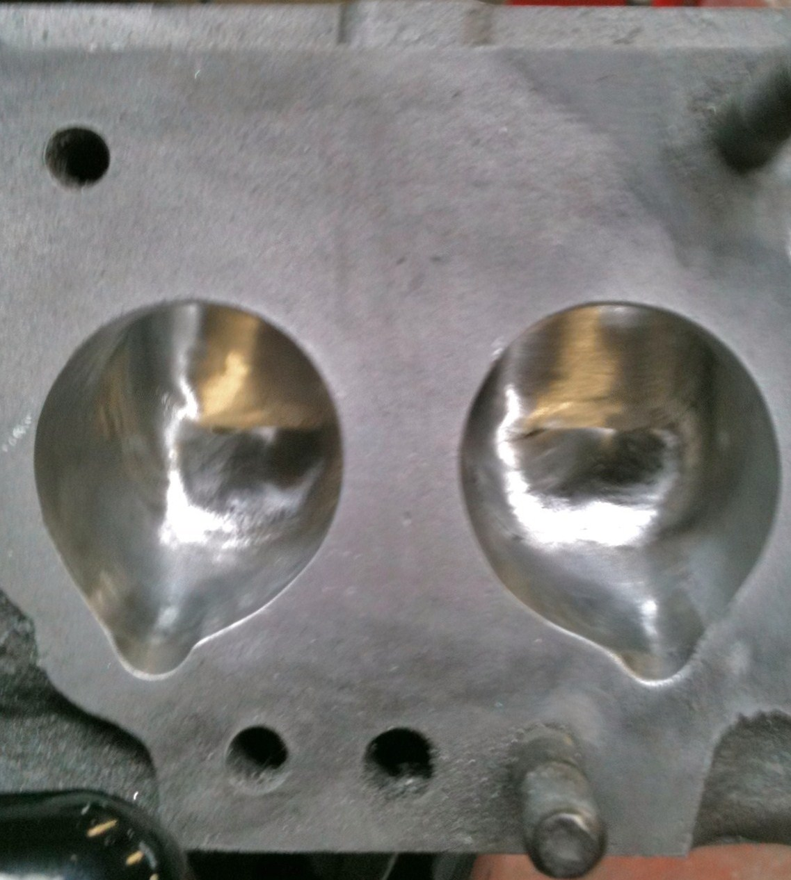

peter mc Posted January 9, 2011 Author Posted January 9, 2011 just a pic or to have made more mods to the port after testing ,just the chambers to do now and clean the ports up a bit after final air flo testing Quote

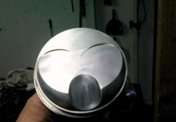

peter mc Posted January 10, 2011 Author Posted January 10, 2011 piston to go with the p90 . Brings the comp up to12.1 Quote

Riceburner Posted January 10, 2011 Posted January 10, 2011 My bottom end is assembled, still waiting on the headers I' running flat tops and they had to deck the block, so I have about .25mm positive deck height. Should be fine by the looks of those bad boys Peter Quote
