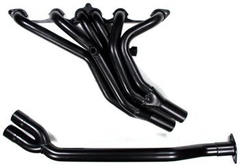

NZeder Posted July 17, 2010 Posted July 17, 2010 got the specs or a pic of the Zed Hurricane Header? Quote

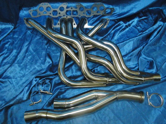

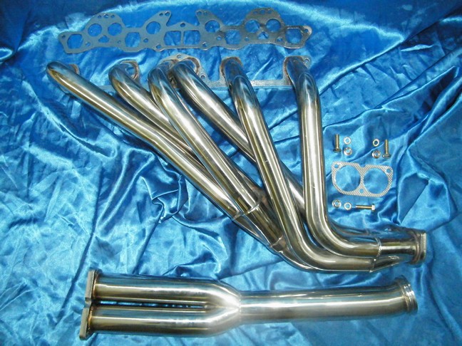

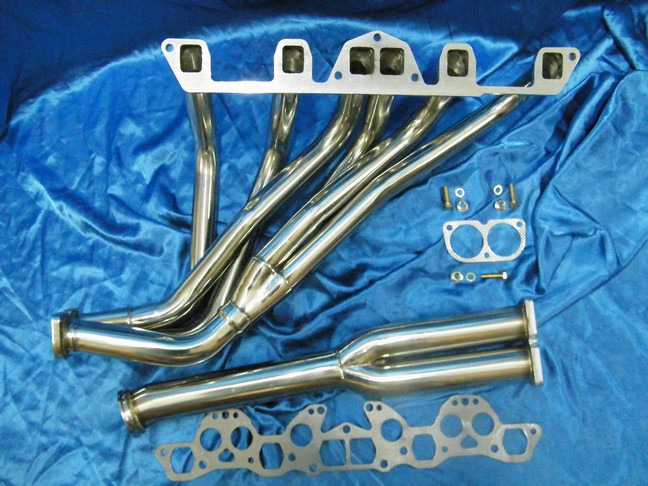

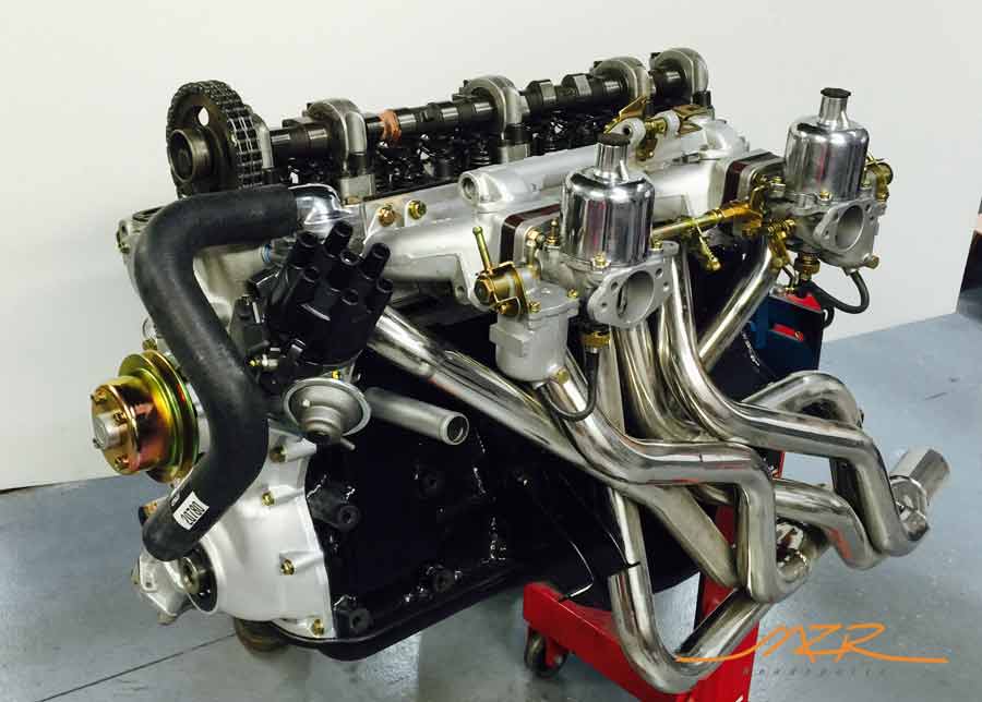

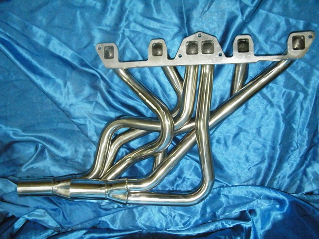

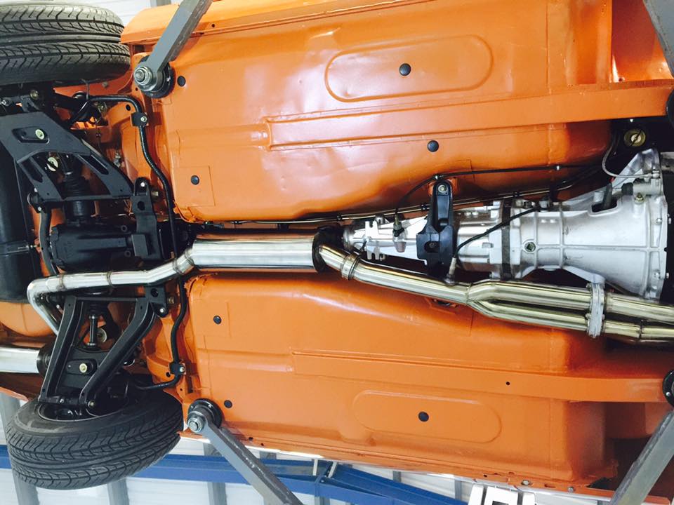

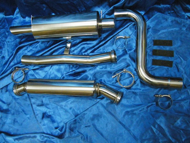

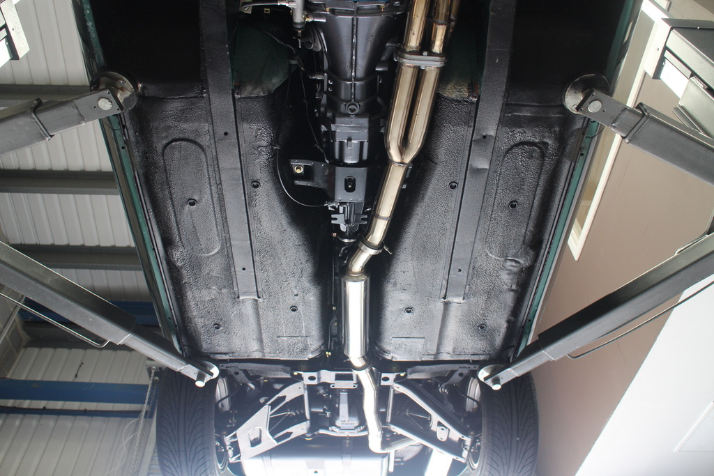

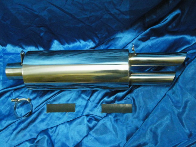

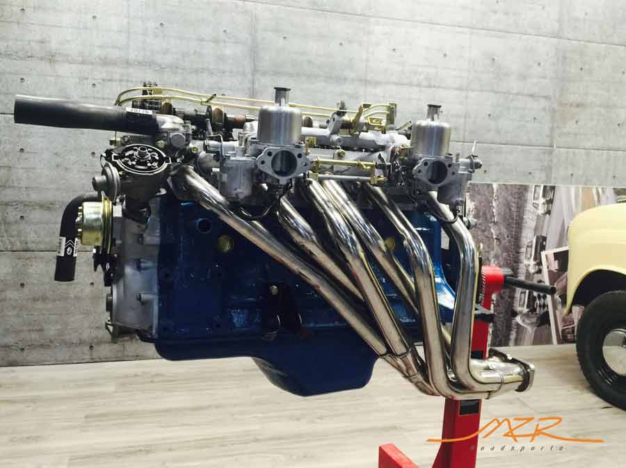

Sean Dezart Posted September 25, 2016 Posted September 25, 2016 Hi chaps. Knowing that this is a very old thread but never seemed to have a finish to the story, I'd like to suggest that some headers designed for LHD and RHD cars don't compromise. I offer 3x header versions, a single fit-all exhaust and a choice of mufflers. The exhaust'll fit 2x seaters and 2+2s and the whole kit is in stainless steel. So far, I've only sold a couple of JDM-style twin-pipe rear mufflers into Aus. so I'd be interested in working with anyone wanting to fit one of my entire systems. Quality-wise, I'll stick my neck out and say that they're comparable with those exported from Japan (except on price) and way above those exported from the States - Stahl were good but more expensive and no more. Obviously if you guys rely upon local exhaust shops, you might get better deals especially avoiding shipping and potentially customs duties. I merely wanted to point out another option to those mentioned above and an after-sales service including spare parts second to none : produced and sold by a genuine Z-fan ! ric240z and gMit 2 Quote
Administrators gav240z Posted September 26, 2016 Administrators Posted September 26, 2016 This really does look like a great fit and finish. I particularly like the twin exit exhaust, do you have any videos that capture the sound this system produces? gMit 1 Quote
Moderators PB260Z Posted October 22, 2016 Moderators Posted October 22, 2016 I too like the twin exhaust look, have been thinking of fitting one on the 2+2. Quote
