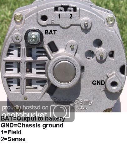

When the sparkie was working on the alternator, I asked "Has it been wired up properly" and was told, most certainly yes.
Well, it wasn't. The dash warning lamp circuit had not been wired it, so that was why the alternator was not self exciting and beginning to charge. At least now that is sorted out, not helped by an alternator with ZERO markings on it describing what pin is which.
For reference, looking at the back of the alternator, the sense is always the furthest from the battery, for all alternators.
Like so: (not my photo, I stole it)
