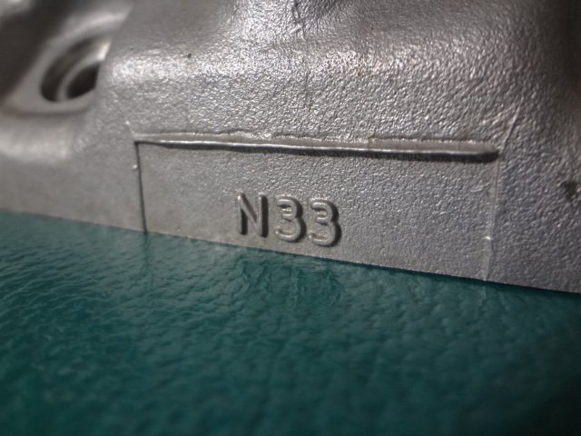

Administrators gav240z Posted July 4, 2016 Administrators Posted July 4, 2016 Just going to add some more info here regarding an N33 cylinder head to suit an L24 and possibly L26 also. I found mentions of it here: http://www.zcar.com/forum/10-70-83-tech-discussion-forum/37076-cylinder-head-differences.html http://www.classiczcars.com/forums/topic/7767-n33-head/ However I believe this is not shown on the head as a casting code. Instead it still says E88. The N33 refers to the part no. so therefore the L26 E88 could be called a P50 head. I haven't looked through other part manuals, but I suspect you could find different part no's to signify the difference with the MR30 Skyline L24 E88 EFI head. Refer attached image. Quote

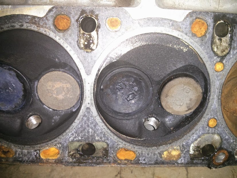

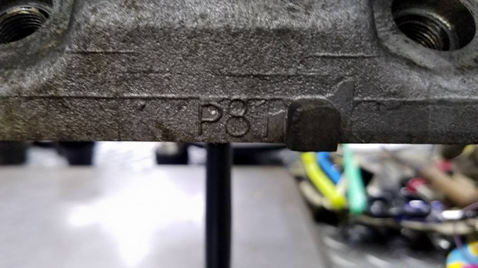

Administrators gav240z Posted May 31, 2017 Administrators Posted May 31, 2017 Added some photos of the rare elusive and mysterious P81 cylinder head. Riceburner and scott 2 Quote
