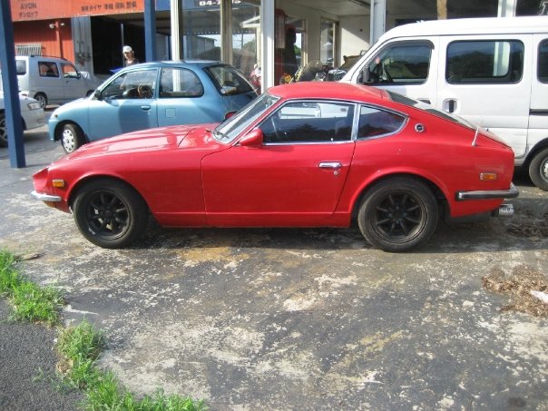

240zoom Posted June 19, 2009 Posted June 19, 2009 Hi all I posted a long time ago when I joined about a little S30 fairlady I bought in Japan. According to the owner it was used in Tokyo as a weekend track car. It wasn't fancy but I liked it. It wasn't even for sale. We saw it parked on the side of the road and stopped and chatted to the owner and he sold it along with a Datsun 1600 coupe racecar (fully done) and a 1800SSS Coupe stock standard that belonged to a Datsun test driver. I have attached a photo of the car in Japan and also when it arrived in fremantle. I managed to land it in Fremantle for around $8000.00 Quote

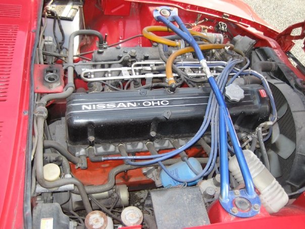

240zoom Posted June 19, 2009 Author Posted June 19, 2009 OK next was the engine and gearbox. the gearbox is fine. Happy for me it has been rebuilt and somebody chose to write the ratios on the box as follows: 3.321, 2.027, 1.308, 1.000, 0.864. this will do fine The motor is a L28. It's on a N42 block, has been bored/stroked to 3.1 litres (in round figures) and is fuel injected. took the rocker cover off and basically it was spot on. Even the oil in it was brand new so it had obviously been well maintained. the only thing I did was change out the valve springs from standard to Crow Cam heavy duty springs. the throttle body and rocker cover were stripped and polished and ceramic coated along with the extractors which were pretty much brand new. Cleaned and serviced the starter motor and Alternator to give it a nice look and was pretty happy with the results Quote

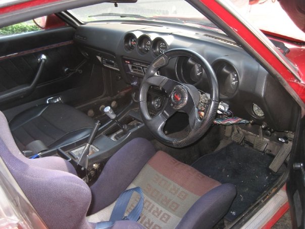

240zoom Posted June 19, 2009 Author Posted June 19, 2009 Started thinking about the interior whilst the painter (currently) is painting the baby Firstly I wanted to get the gauges calibrated, tested, repaired. Sent them off and they came back with a clean bill of health. All working and all perfect. So I got the faces painted and am pretty happy with the results. All up .... calibration, testing and painting was about 480.00 from Aisat Instruments in Perth. Quote
240zoom Posted June 19, 2009 Author Posted June 19, 2009 The centre consol and dash are still out being repaired in Perth due back this week. the door trims and hood lining are the same. I got the Watanabes painted and polished ready for boots. Came out ok Quote
