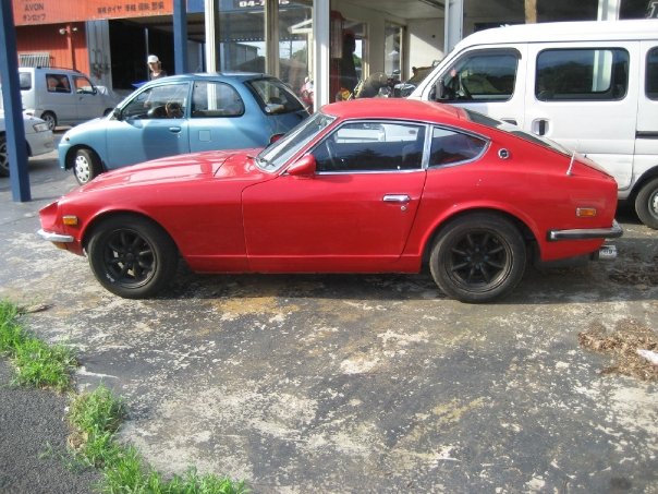

  18. Hi all I posted a long time ago when I joined about a little S30 fairlady I bought in Japan. According to the owner it was used in Tokyo as a weekend track car. It wasn't fancy but I liked it. It wasn't even for sale. We saw it parked on the side of the road and stopped and chatted to the owner and he sold it along with a Datsun 1600 coupe racecar (fully done) and a 1800SSS Coupe stock standard that belonged to a Datsun test driver. I have attached a photo of the car in Japan and also when it arrived in fremantle. I managed to land it in Fremantle for around $8000.00

  23. Here is a pic taken in Japan where it was parked. You can see the Watanabe's on it. the best part was there was another set in the boot so am setting the second set up with semi slicks as they are 2 x 14x7's and 2 x 14x7.5's Shame they weren't magnesium though
