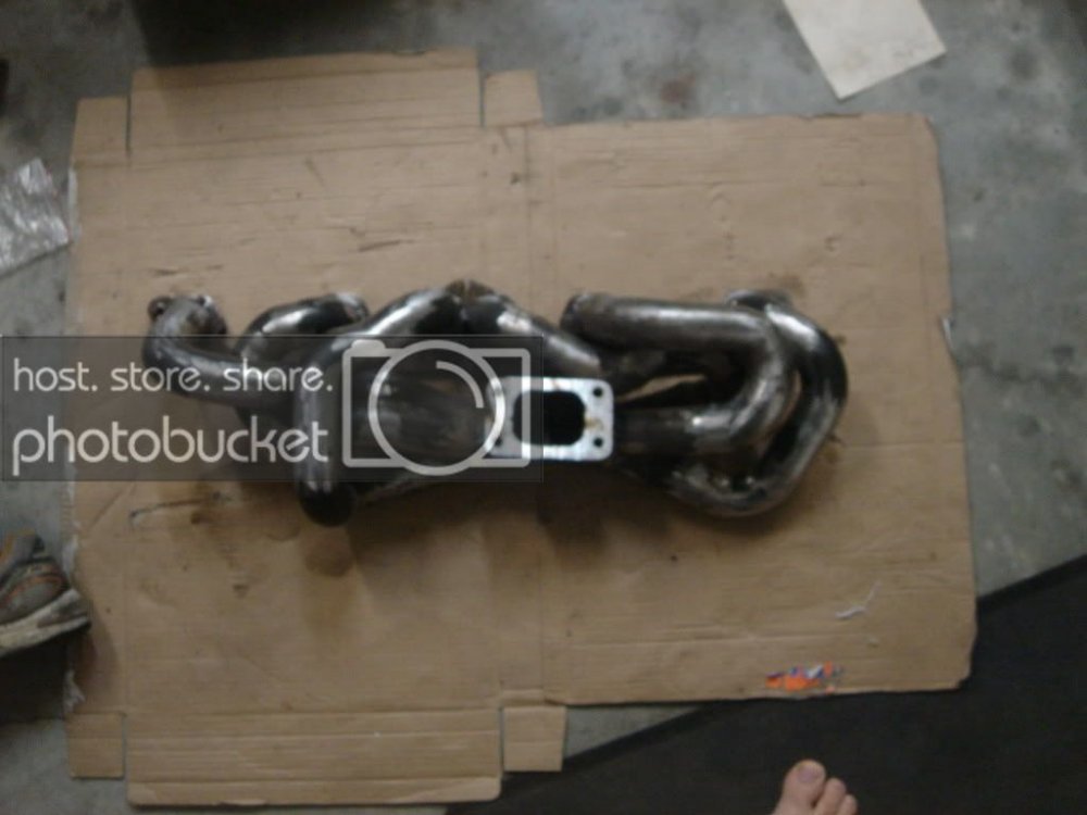

waxhead Posted June 18, 2009 Author Posted June 18, 2009 Well im going to bolt it hard to the head and weld it up . The with a furnace i will heat it up to normalise it and cool it slowly Im hoping this will be enough Quote
waxhead Posted June 19, 2009 Author Posted June 19, 2009 Well i welded up two of the pipes today some students wanted to help clean up the pipe and who am I to argue Quote
Moderators Zedman240® Posted June 19, 2009 Moderators Posted June 19, 2009 Nothing beats slave labour! Ha! Just curious, when assembling a manifold like that for a turbo, is there any special pattern or design you have to follow as in the pulses of exhaust in the firing order? Its hard to explain but like in a NA setup, in a book I've read, it says to keep exhausting cylinders away from intaking cylinders in the same group. That's why you see extractors for L series engines with 1 to 3 and 4 to 6 in two groups with long secondaries; pulses or pressure waves from the first group of the first three have to travel a fair distance to reach the back group of 3 cylinders. Quote

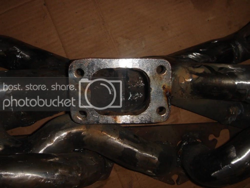

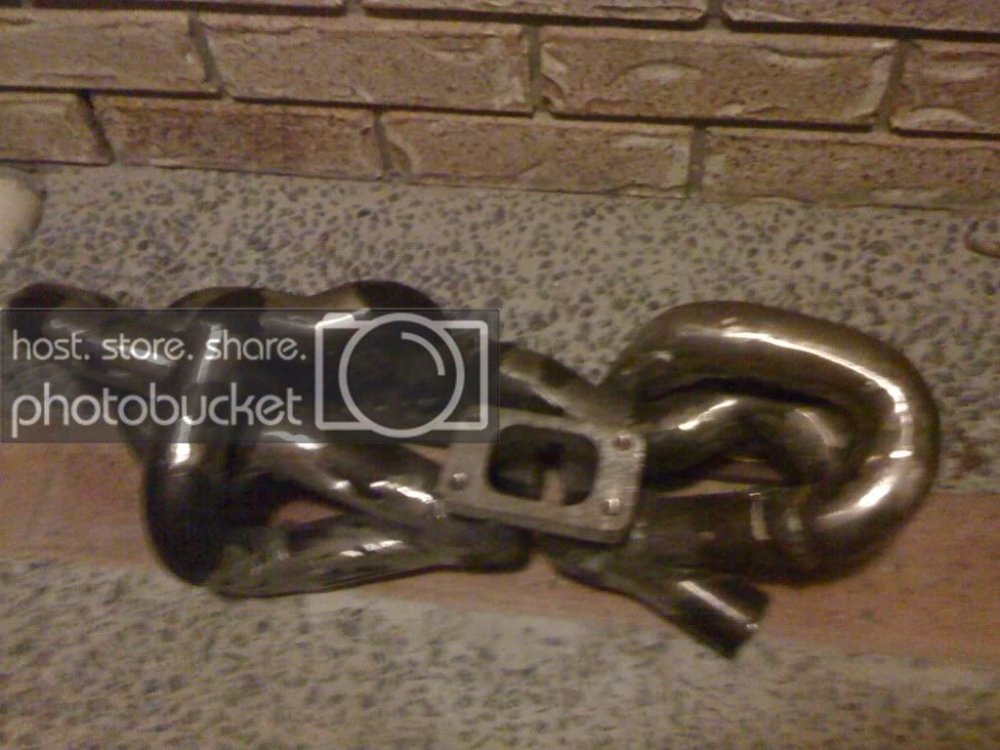

waxhead Posted June 30, 2009 Author Posted June 30, 2009 Bit of an update have finished all but one pf the pipes The next thing is to finish the collector at the turbo I will build a bridge as i want to run a twin entry turbo Then bore a hole in the bottom for the waste gate get it coated and all done Lots of cleaning up work as well This was friggin complex building this manifold its awesome and i really like the manifold but i am not sure i would do it again , heck yes i would but i wouldnt look forward to it sorry about the low quality pics but it was taken by my iphone at night Quote

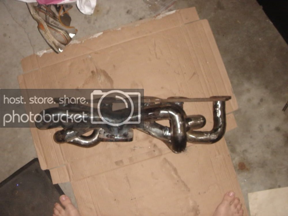

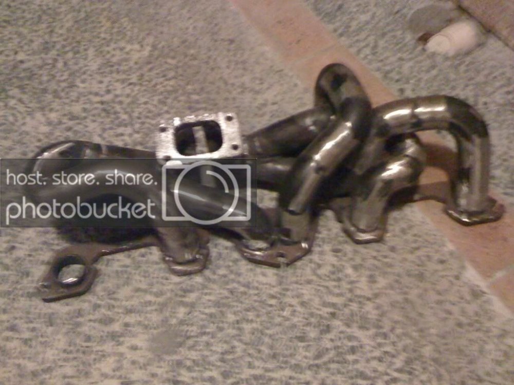

waxhead Posted July 1, 2009 Author Posted July 1, 2009 Well the manifold is almost ready to be machined now Actually there is 5 mins of cleaning up top be done but i will wait until its machined first then clean it up and off to the coaters let me know what you think im stoked with it Quote
waxhead Posted July 1, 2009 Author Posted July 1, 2009 Yeah pipes every where Hard on a non cross flow engine as you cant go up only down and out Quote
xa1973 Posted July 1, 2009 Posted July 1, 2009 And no socks, but I see an old runner on the sidelines.............change of pace Quote
waxhead Posted July 1, 2009 Author Posted July 1, 2009 Yeah a pair of socks was killed in the making of these pipes I didnt want them to look all the same i actually wanted them every where makes it look more complex Quote
