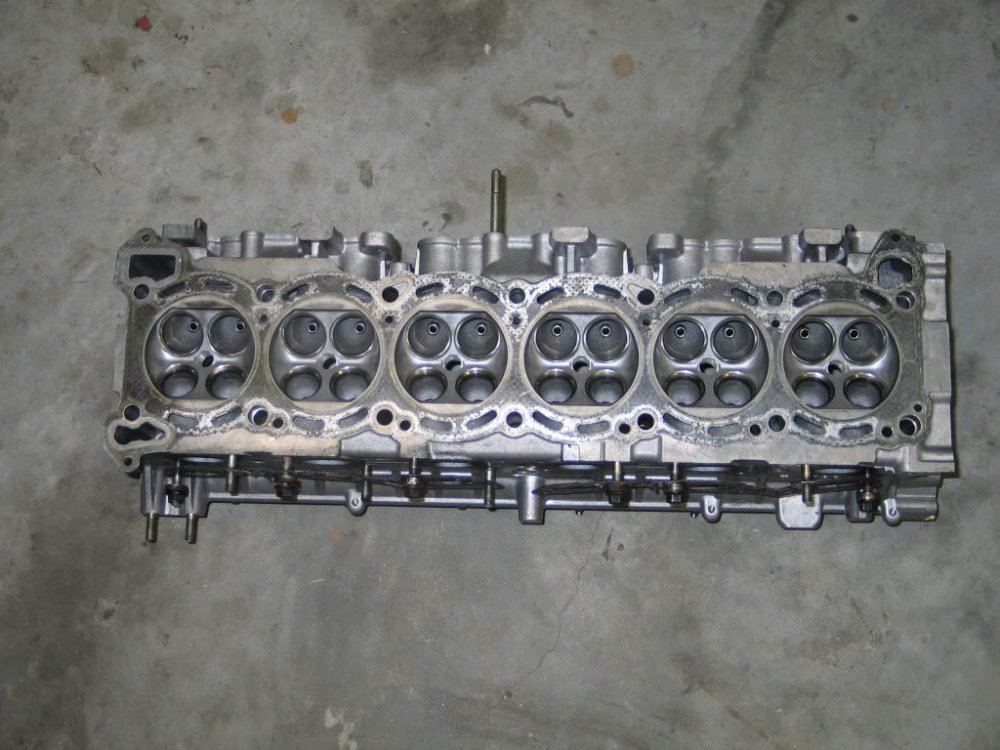

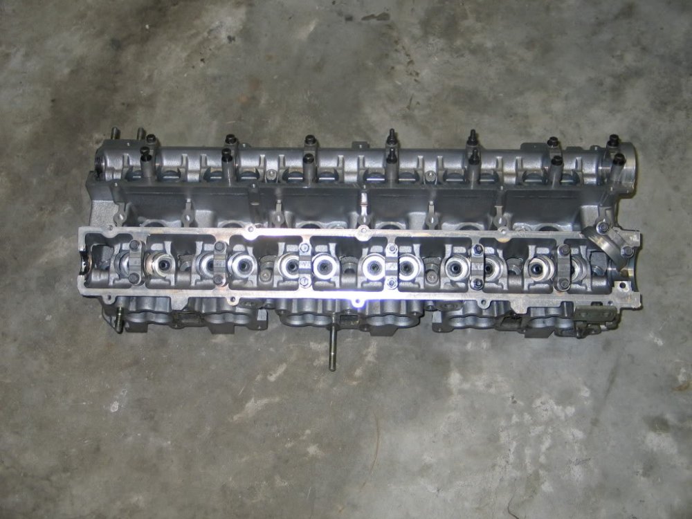

waxhead Posted September 7, 2009 Author Posted September 7, 2009 Well got the head back from the hot tank today Came out great Also picked up my fd mazda seats which I will be fitting soon, i will make new mounts for them at work so I can sit them just how I like, then paint them in so they look factory and will go through compliance easy Quote

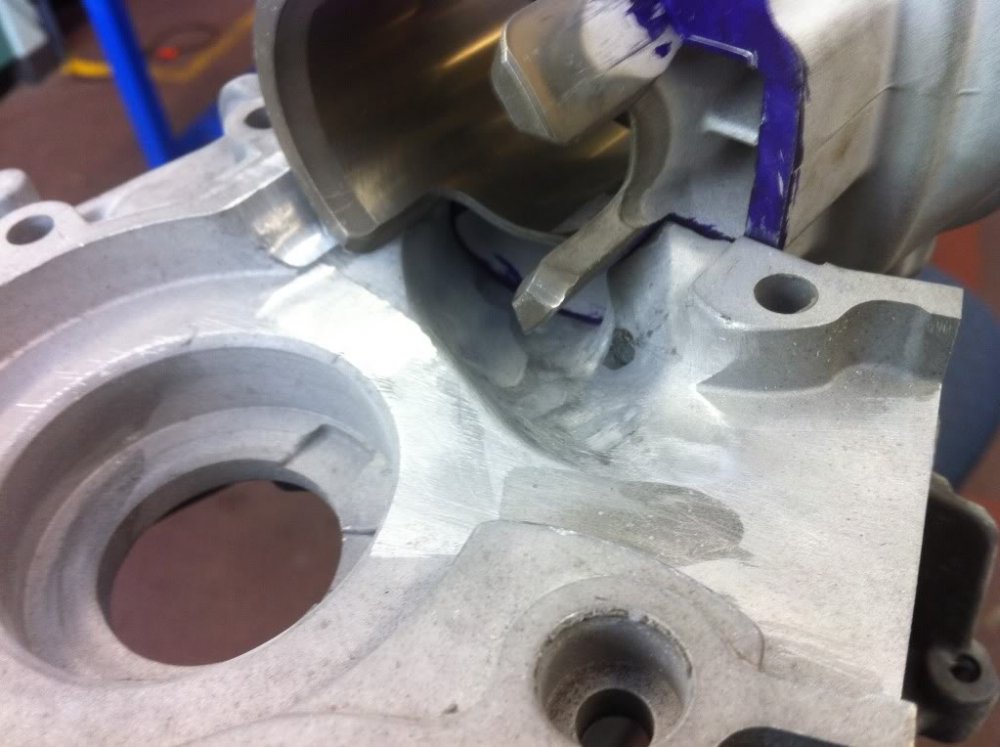

waxhead Posted September 10, 2009 Author Posted September 10, 2009 Well here is the modified sump all done Pickup is next i guess i shoudl have done that first but i was all excited to get the sump finished I used a lump of 30mm ply to hold it flat and just screwed it down It holds 4.8 litres before it comes over the windage tray With the oil cooler that will be alot more and should be good Now i just have to do the modification for the rb26 oil pickup Quote

waxhead Posted September 10, 2009 Author Posted September 10, 2009 After speaking to a few people on the web as well as on the phone that have done the rb26 conversion they all seem to be having issues with sump modifcation. not the depth issue but more the pickup as the rb26 block isnt drilled or cast as far down in the oil gallery. So the logical and easiest option is to use the rb30 block and make an rb30dett. The blocks are about $200 for more capacity as well easier to convert. What was i thinking. So its rb26dett block up for sale and 26 head on the rb30. Gee i hope it has enough power Lucky I have already secured the rb25det gearbox. Quote
