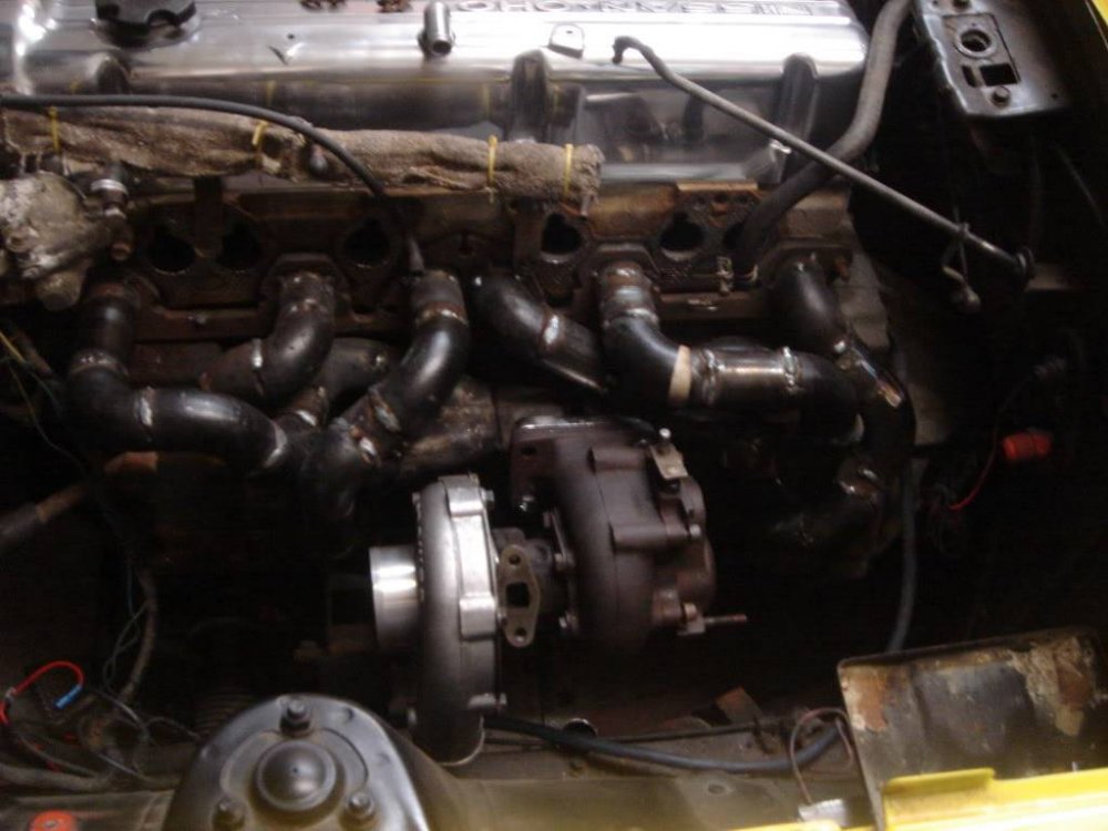

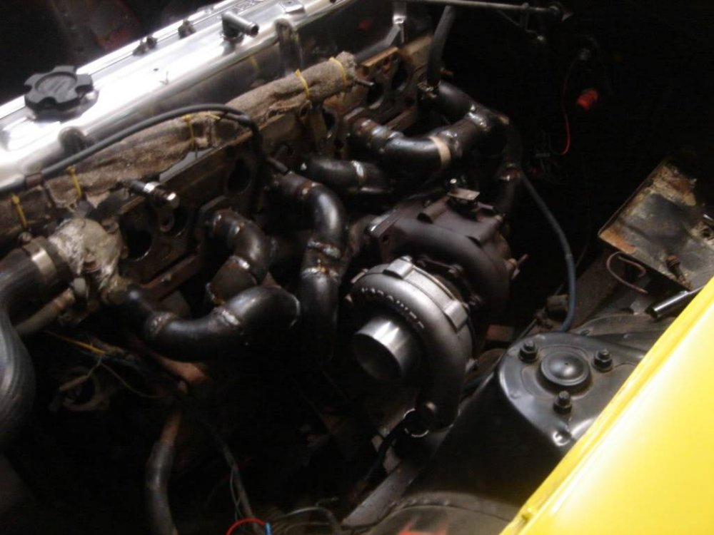

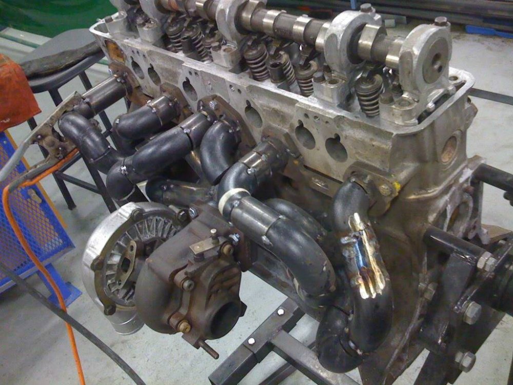

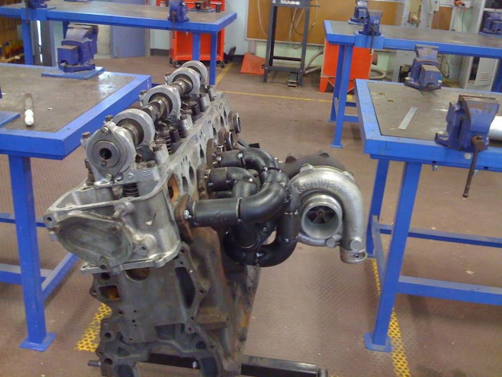

waxhead Posted June 15, 2009 Author Posted June 15, 2009 Ok progress pics I have done the front pipes and hopefully will get the rest done tomorrow or at least this week. Then its time to remove them and weld them all solid and put them back on. Im reasonablly happy with how its turning out its no monzter style thing but its even length and held close to engine and out of the way. Quote
garvice Posted June 15, 2009 Posted June 15, 2009 Impressive. The turbo looks off centre a bit. Are you still going to be able to get the same length pipes for the back three cylinders? Quote
waxhead Posted June 15, 2009 Author Posted June 15, 2009 Yes the turbo sits further back , its done that way to try and clear the engine mount. The rear pipes will look different from the front. However they will be the same length , just some of the bends may be tighter Quote

xa1973 Posted June 15, 2009 Posted June 15, 2009 Looking good Mate, time well spent........ With all that extra weight on one side, will this affect your engine mounts? Have you given any thought since youve Turbo'd, those pipes will get mighty HOT and stay hot for a long time and transfer a lot of heat to your newly designed manifold Quote
waxhead Posted June 15, 2009 Author Posted June 15, 2009 It doesnt weigh as much as it looks. I will weigh it when i am finshed, the issue i think with the mounts will be the twisting it gets from the extra torque the motor develops Quote

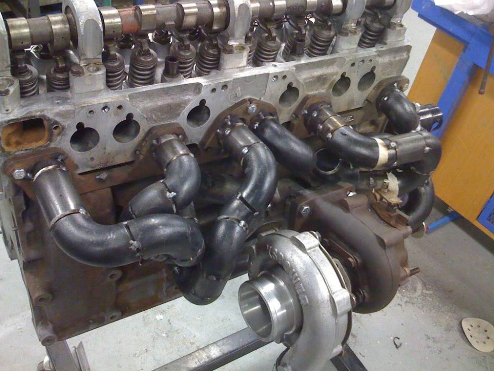

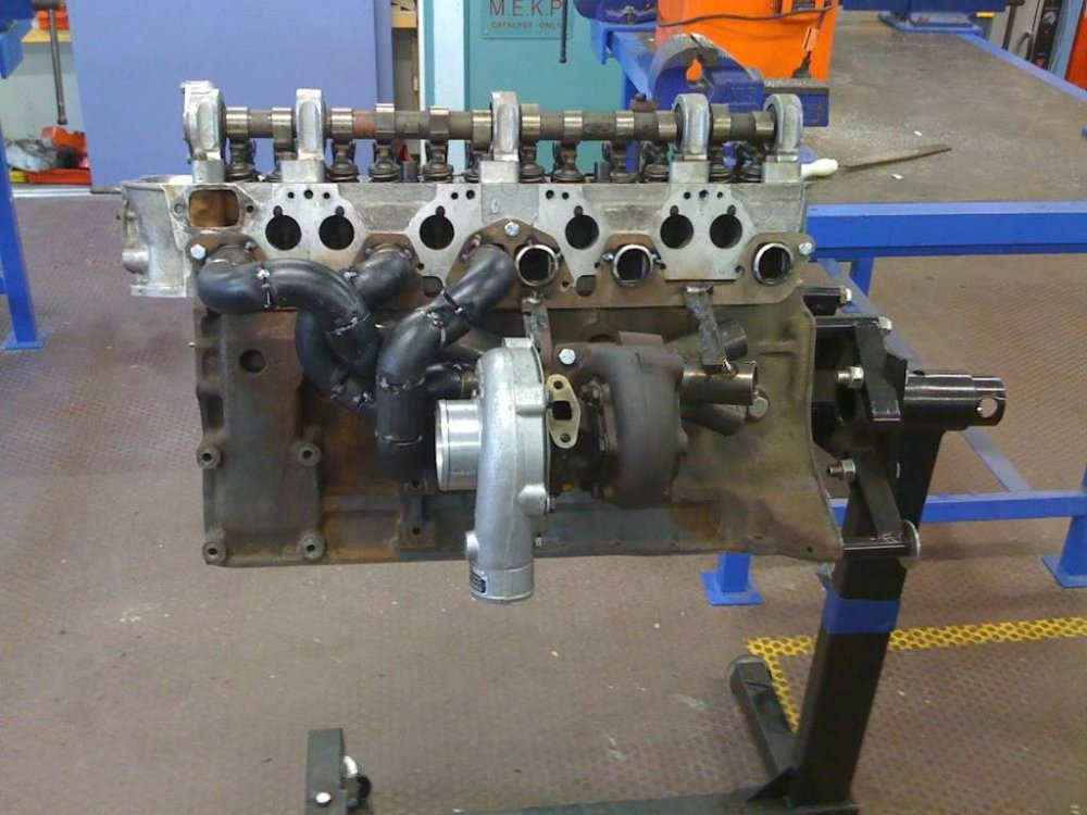

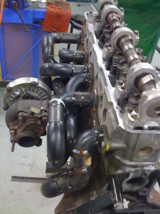

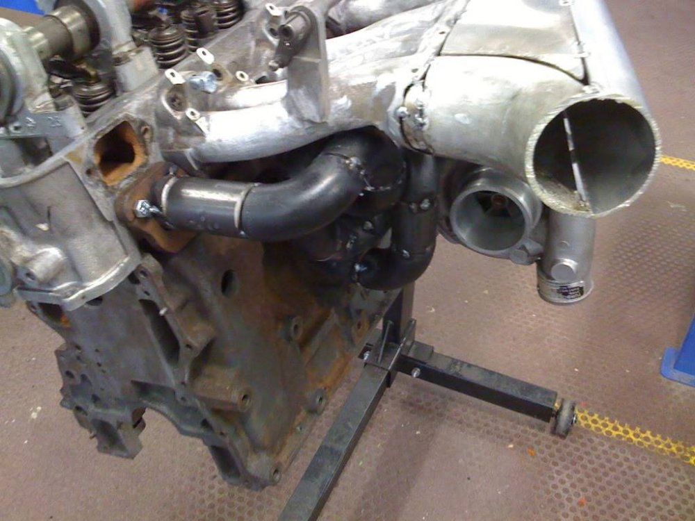

waxhead Posted June 16, 2009 Author Posted June 16, 2009 OK well did some more work on it today. of course i didnt have enough bends i was one short I will go get some more tomorrow and do some work on it thursday The intake manifold is just sitting on there at the moment so dont think its going to be running and touching the header at the same time I have redone number 6 as i was not happy with the angles in it ,you can see the redone one in the first pic After its welded and ground up i will hit it with the emery tape and smooth it all out before welding together Quote

RB30X Posted June 17, 2009 Posted June 17, 2009 I hope with all the effort you're putting in you arn't going to use that awfully restrcitive dump pipe flange. External or internal wastegate?? Quote
waxhead Posted June 17, 2009 Author Posted June 17, 2009 Nah thats not the turbo i am running its just a turbo to help me sizing it all up I will be running an external to get the correct boost control i am after Quote

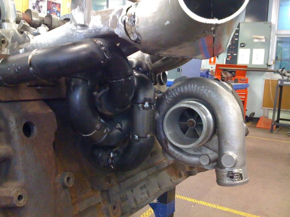

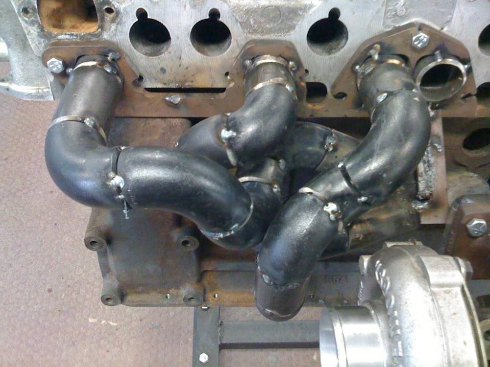

waxhead Posted June 17, 2009 Author Posted June 17, 2009 Ok well its finished pretty much Just have to weld it all solid now please excuse the mess in my car this is all pre my doing Quote

Scoota G Posted June 17, 2009 Posted June 17, 2009 Ok well its finished pretty much Just have to weld it all solid now please excuse the mess in my car this is all pre my doing Have you figured out a sequence to weld them up to minimize distortion, or does the thickness and bends cancel that out? Quote
