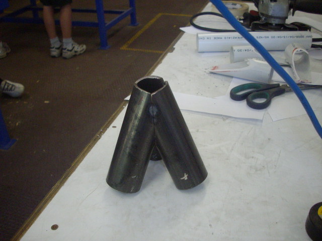

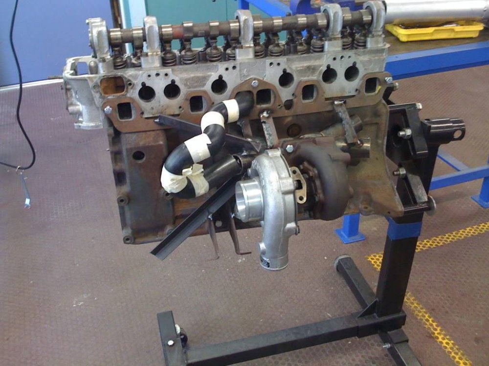

waxhead Posted June 12, 2009 Author Posted June 12, 2009 Im not going to big bore it as i dont see the need when you can just give it another pound of boost Im looking for some forged pistons and rods Rods are only 700 so thats not bad pistons go a bit higher. I would like to be able to rev this thing hard if i feel the need and not so sure about the cast pistonbs at that higher rpm (8000 is the figure i have in mind) Im working hard at the moment and have just made the two merge collectors for the exhaust today. I have decided to put the turbo in the middle of the engine instead of up the front , will be better supported and will also look better in my op Quote

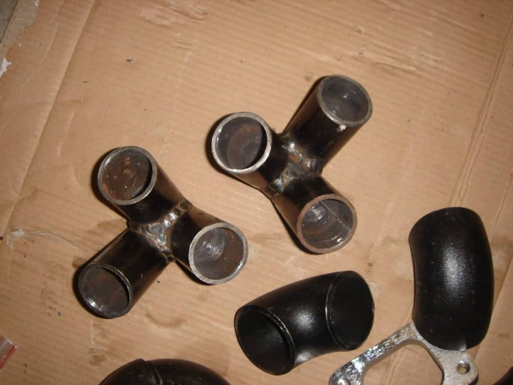

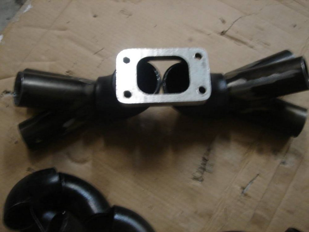

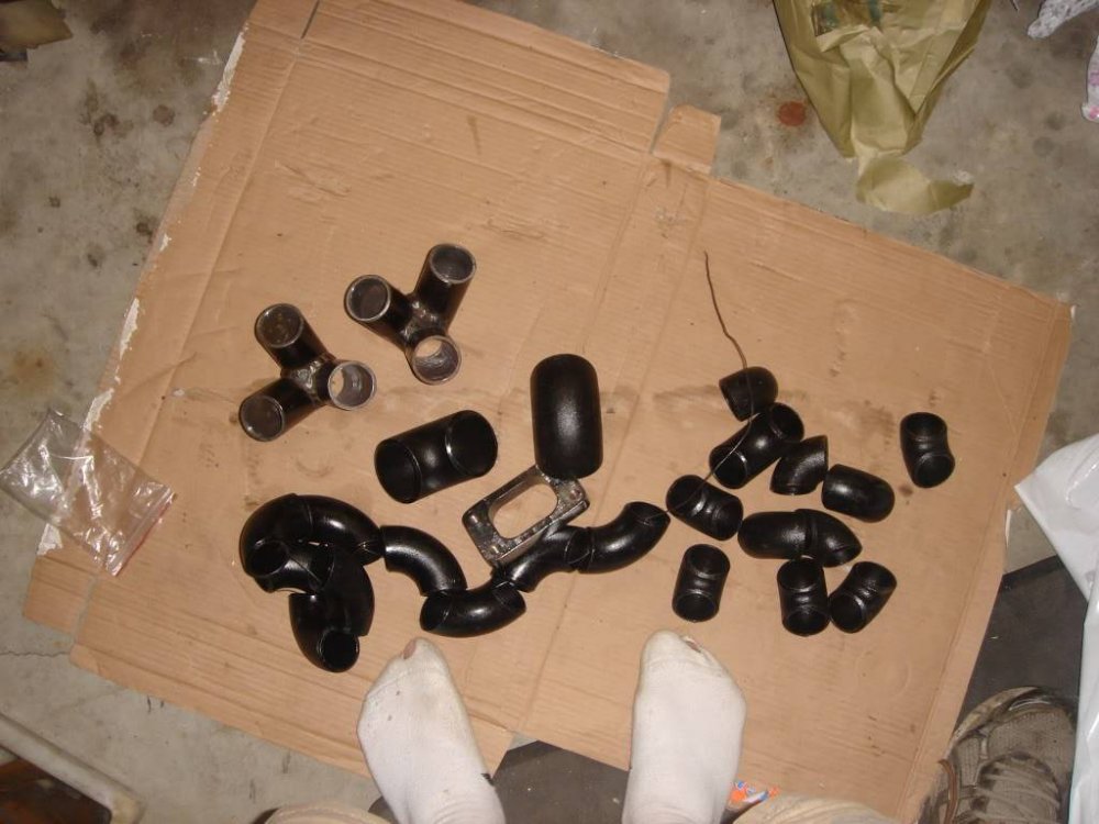

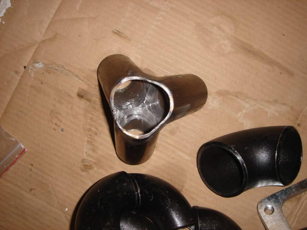

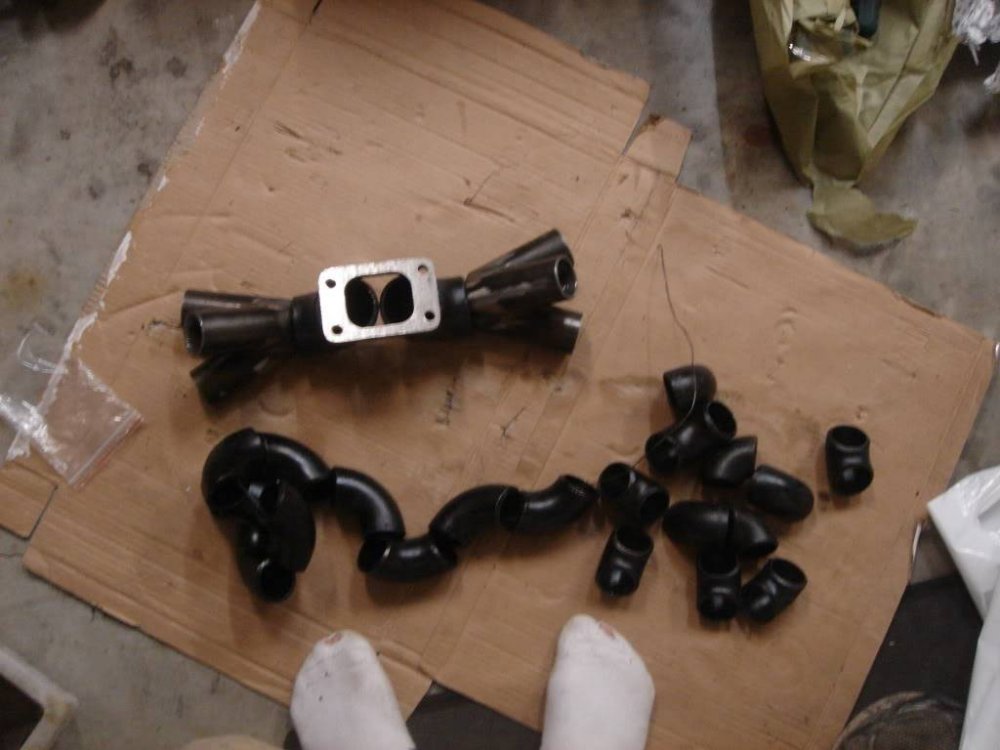

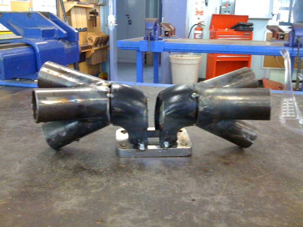

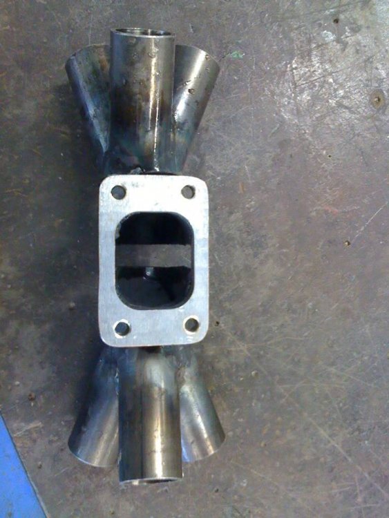

waxhead Posted June 12, 2009 Author Posted June 12, 2009 well finished the merge collector Here is a pic of my manifold sitting on the floor. I put my socks on to keep every one happy Tomorrow i will start to join the pieces together to make a manifold out of it Quote

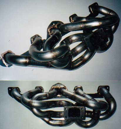

waxhead Posted June 12, 2009 Author Posted June 12, 2009 This is what i have in mind for my manifold to look like Quote
garvice Posted June 12, 2009 Posted June 12, 2009 So, you are making two of everything aren't you? Quote
xa1973 Posted June 12, 2009 Posted June 12, 2009 Looks good There will be a bit of weight in that there setup.......what have you made them out of black steel? Quote
xa1973 Posted June 12, 2009 Posted June 12, 2009 nice holes in them socks. Aircon on the run........ Quote

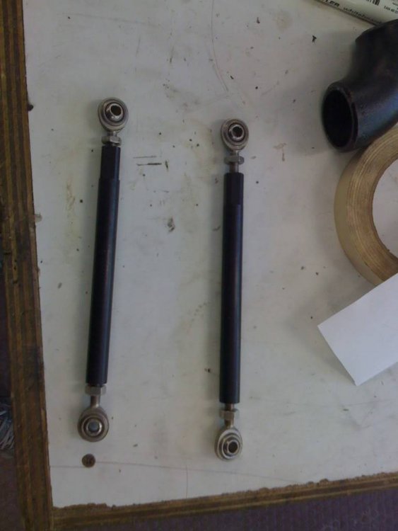

waxhead Posted June 12, 2009 Author Posted June 12, 2009 Yeah this is my work socks Yup i have used black steel weld bends It will be heavy so i will run a brace for the turbo to help it stay in place Im thinking to run it off the engine mount and use two rose joints so it has some room for expansion if it needs it My goal is to put this on and not have to remove it , Im going to pick up a dummy turbo tomorrow to help me work out the placement correctly Quote

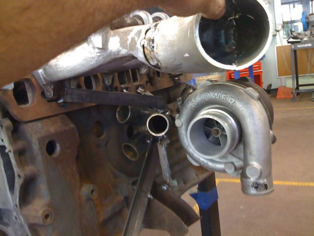

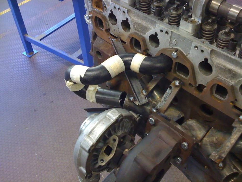

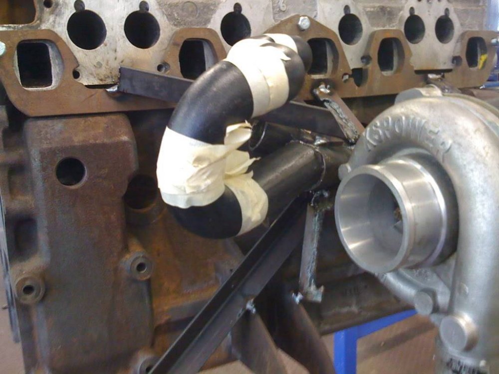

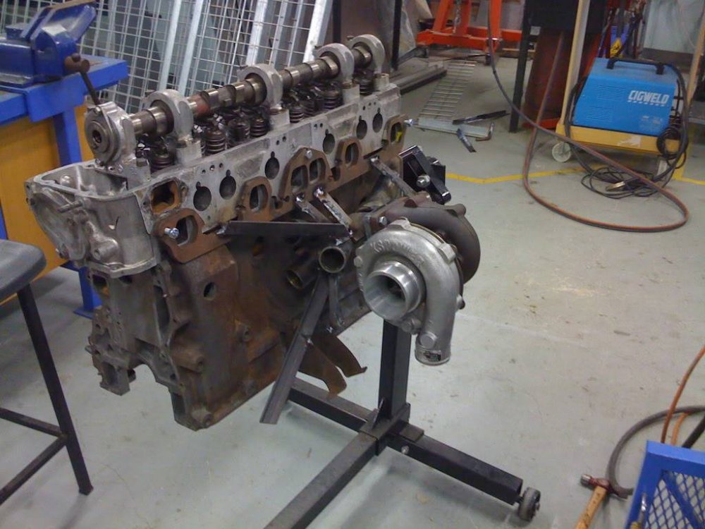

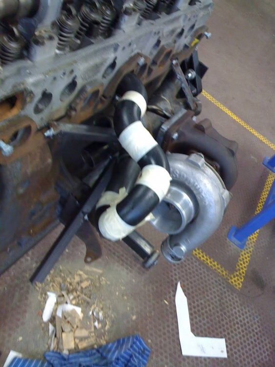

waxhead Posted June 13, 2009 Author Posted June 13, 2009 I went into work today and did some more work on my Exhaust manifold. Its comimg along nicely, of course its all just tacked together and has to be fully welded once all the pipes are sorted Thats not where the header pipe will end up it was just a play to see what it would look like And to suport the manifold when its finished Quote
