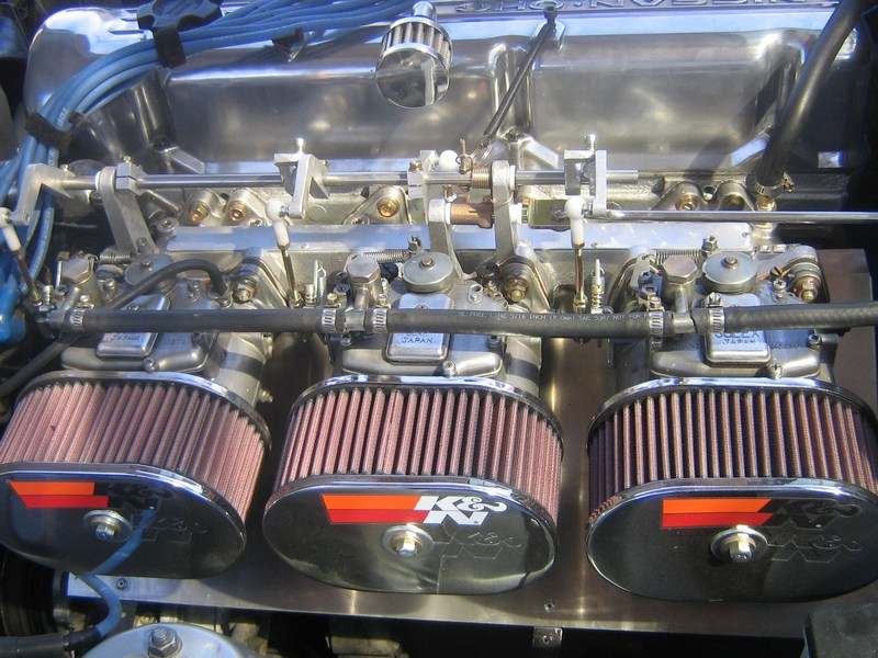

reverendzed Posted November 6, 2008 Author Posted November 6, 2008 Well after fitting the triples some time ago and then finding out that the manifold and linkage system wasn't the best setup for the Zed, I purchase a brand new OEM manifold that is the 'business' (thanks BenZed). Things were running heaps better but still with problems of running rich with a flat spot on quick acceleration and after a tune before the recent vic cruise, they still had a 'flat' spot also in high revs under load. (the guys from the cruise may remember me lamenting about this!) But with some great advise from Daniel Moore I purchased and installed some smaller (140) main jets (was running 155) and just took it for a spin and WOW! my thinking was that there was so much fuel being dumped that it was flooding I could always smell it! I know that the 'nose' isn't the most valid of tuning tools however as soon as I run the carbs with these new main jets it no longer had the heavy fuel smell that normally accompanied heavy acceleration. Probably still needs a little more tinkering however i think I'm finally getting somewhere! Quote
warrenz Posted November 6, 2008 Posted November 6, 2008 One thing I learnt when I had Mauceri Motors sort out my Dellorto problem was the importance of having all 3 accelerator pumps synchronised. If one of the carbys is early or late in squirting the fuel into the venturi when you step on the gas you will get a hesitation. The variation may be in the linkage or the pump jet accuating arm. Are mikuni jets interchageable with Dellorto's? If so between Sulio, Scootag and myself we have a fair range of jets for plug and play Warren Quote
Toecutter Posted November 6, 2008 Posted November 6, 2008 Rev, Well one thing that really helps me in the fine tuning of my carbs is my a/f gauge. Rev, get yourself a $40 VT oxygen sensor and have it mounted in the common pipe of your headers or exhaust. Buy a narrow band afr gauge for $30 mark and you'll see where it's going lean or rich. It's pretty cool as you get an instant readings, ie the gauge goes to lean on acceleration you get a small pop at the carbs so it just confirms your thoughts and you go a little richer on you accel jets etc etc. You can check mine out on the 19th of Nov at our meeting if you like or sooner if your in the Clayton area in the coming days!? Sulio Quote
Administrators gav240z Posted November 6, 2008 Administrators Posted November 6, 2008 You have become quite the expert on Triples Sulio, I'm impressed. Will have to bring my Mikuni's around to you when I get around to fitting them. Can't wait really, I'm sure I'll love the sound of Triples in the morning . Quote
Glen Posted November 6, 2008 Posted November 6, 2008 Well after fitting the triples some time ago and then finding out that the manifold and linkage system wasn't the best setup for the Zed, I purchase a brand new OEM manifold that is the 'business' (thanks BenZed). Things were running heaps better but still with problems of running rich with a flat spot on quick acceleration and after a tune before the recent vic cruise, they still had a 'flat' spot also in high revs under load. (the guys from the cruise may remember me lamenting about this!) But with some great advise from Daniel Moore I purchased and installed some smaller (140) main jets (was running 155) and just took it for a spin and WOW! my thinking was that there was so much fuel being dumped that it was flooding I could always smell it! I know that the 'nose' isn't the most valid of tuning tools however as soon as I run the carbs with these new main jets it no longer had the heavy fuel smell that normally accompanied heavy acceleration. Probably still needs a little more tinkering however i think I'm finally getting somewhere! when you get the carbs sorted you should really get your dizy matched (torque curve) to your cam, that along with correct jetting is quite critical. Quote
Toecutter Posted November 6, 2008 Posted November 6, 2008 You have become quite the expert on Triples Sulio, I'm impressed. Will have to bring my Mikuni's around to you when I get around to fitting them. Can't wait really, I'm sure I'll love the sound of Triples in the morning The hard part is getting access to all the various jets. The good think about the Dellorto's is between myself Michael in Sydeny, Warren and Scoota I had access to all the jets I needed without having to buy them. I'm pretty happy with em know, have'nt touched the dizzy as will wait til new motor goes in. Sulio Quote

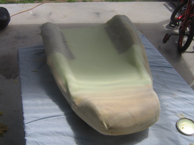

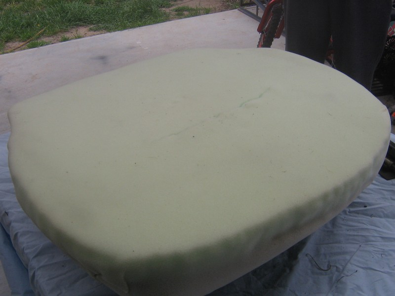

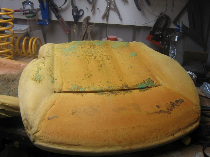

reverendzed Posted November 7, 2008 Author Posted November 7, 2008 Man the dollar sux! I was all ready to buy new foam inserts for my seats when......the bottom fell out of the global economy. So as always necessity is the mother of zed ingenuity! A trip to Clark rubber, some high density foam and a sharp knife and I'm an instant DIY upholsterer and I am really pleased with the results. Only the drivers chair done at the moment but the passenger is on its way! Quote
Mr240z Posted November 7, 2008 Posted November 7, 2008 Hey REV you are a dead set freak of nature Mate if a send down some postage money can you post yourself to me for a couple of weeks Got some odd jobs for you pauly REV THE ZED CAR BUILDER CAN HE FIX IT "YES HE CAN" Quote
reverendzed Posted November 7, 2008 Author Posted November 7, 2008 Thanks pauly, That's a great compliment, if I could do this everyday.......well back to reality! Quote

reverendzed Posted December 2, 2008 Author Posted December 2, 2008 Time for a quick update! I'm on cloud 9 right now because my triple miki's are now doing what they're meant to be doing! Had the car into Daniel Moore who gave them a thorough going through, fixing the accelerator pumps that were not working on one carb and adjusting the float levels and tuning etc put that together with the installation off the 3.9 diff (out with the 3.5) and now I think I'm armed and dangerous. Took it for a good 'blat' and I'm still smiling! the only problem now is I keep smelling burning rubber not sure what that is!!! Now all I need is to fix or find another gearbox and I'm about set in the engine/transmission room of the rebuild. Wooohoooooo! Quote
