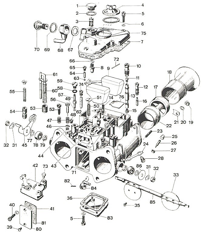

Scoota G Posted February 12, 2009 Author Posted February 12, 2009 We need the data from your Carbies ie: Emulsion tubes, Main Jets, Idle jets ...Blah blah blah and then go from there. Oh and does the Exhaust pop, do you get backfiring through the carbs and the colour of the Tailpipe and plugs. Quote
Mr240z Posted February 12, 2009 Posted February 12, 2009 Get it sorted, Where do I start When i put my foot down i can see a cloud of unburnt fuel out the back (grey to black smoke) I take it to a weber specialist (so he says) what would you say is the problem. Just read your post scootag and yes i do get alot for backfire and the plugs do fouled up alot Quote
Scoota G Posted February 12, 2009 Author Posted February 12, 2009 Without a doubt it the jets , emulsion tubes but probably not the idles. Do you have the Des Hamill "How to tune" book? Maybe we also need a guide/ spreadsheet for webers. If any other members are running webers and have their stats could you please post. Pauly could you please post all your other equipment you run ... From spark plug type and anything else you run Quote
Mr240z Posted February 12, 2009 Posted February 12, 2009 Can i pull the main jets, emulsion tubes out without detuning the weber not that its tuned to start with. Mark i,ll try to check out the internals tomorrow if i can work it out. When i brought these Weber's about 10 years ago, I went though about 3 sets of everything jets, tubes etc and a shit load of johnny cash. And the fuel economy has allways been the same (shit house) If I sit on the motorway and plant my foot I can see the fuel gauge needle moving downwards. Does this mean I,m not getting the best performance out of my motor. And when i sort this out can i fit these to my L28 motor that i,m building from a L24 without going though this again. p.s I,m running BP6E NGK V-grove plugs with 10mm top gun leads Quote
