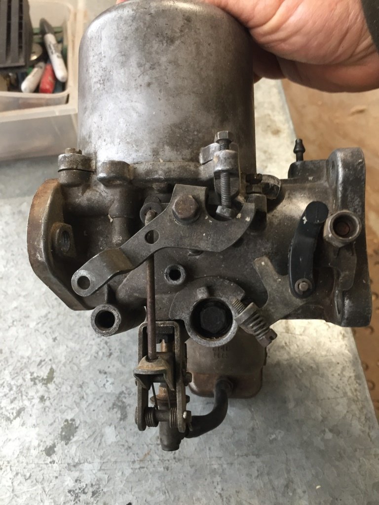

Hi All,

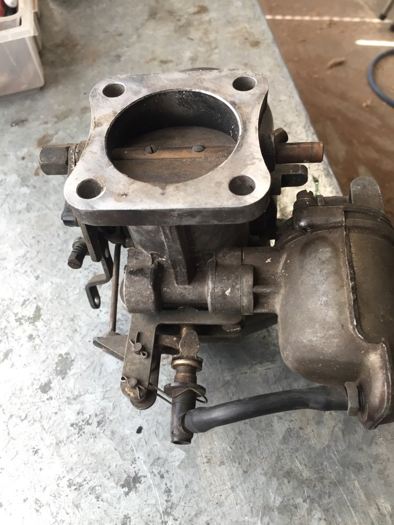

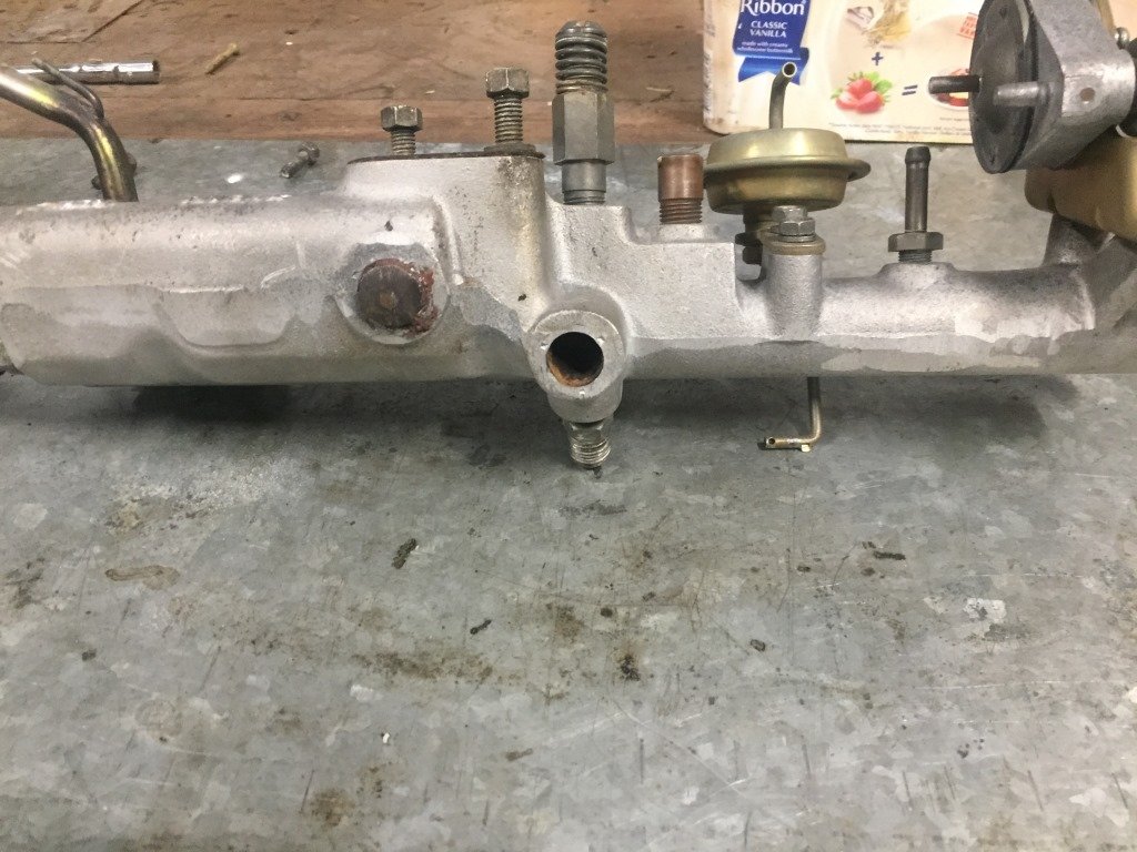

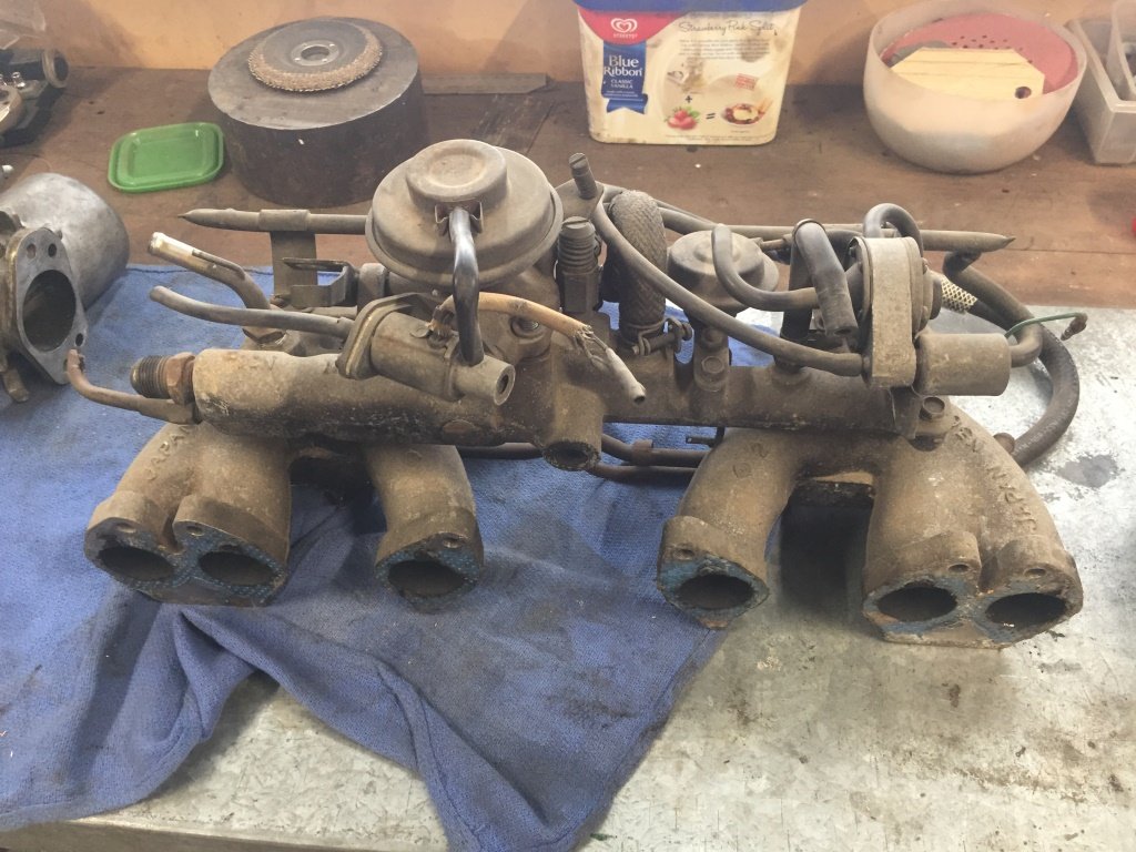

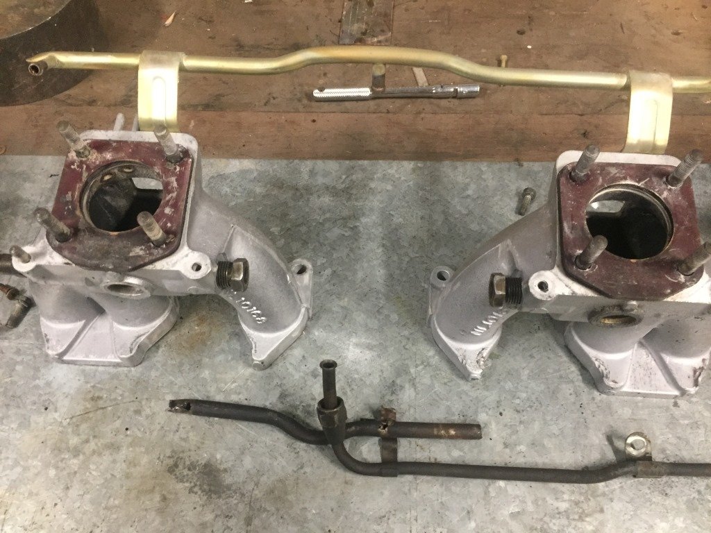

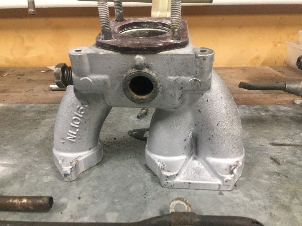

Have been doing a bit of work on my SU's and manifolds, zinc plating and passivating various bits and in the process have discovered the connecting pipe which runs between both carbies is rusted out, as is one of the inlet pipes and two core plugs - one in the inlet manifold and one in the emissions manifold (yes, she's a 77 GSR30 2+2, complete with all the emissions gear). The pictures below show the story.
I have a couple of questions:
I read in a recent post (which I can't for the life of me find again) in which someone was querying where things went on the same carby setup as mine. In one of the responses, there was reference to the fact that "noone uses the water connections to the manifold". You can see in the pics below that the water inlet pipe on the right has rusted out in the Inlet Manifold Before pic and if it is not required, I would prefer just to plug it up. Same with the joiner tube between the left and right manifolds as shown in the Carby Manifold and Joiner Tube pic below. I think I read somewhere the purpose of running water through these was to assist with warming of the manifolds, which in Oz isn't really an issue and certainly not in Perth - is that correct?
Secondly, does anyone know where I can get the core plugs in the carby and emissions manifolds. I realise if I'm not running any water, then they probably aren't necessary, but would prefer to block them off if I can.

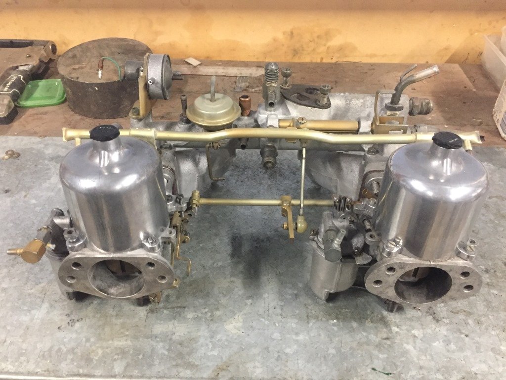

As a matter of interest, carby and manifold cleanup was done using soda in the sand blasting cabinet and the zinc plating and gold passivating was done after about 2 months of trial and error with my home plating setup. Will be rerunning a couple of the bits and have some more to do to finish these off, but getting there.

hmmm, , to my limited knowledge the 260 had hitachi carbies not SU as for the rest no need to run water. if your car hasn't got all the emission connections on it i would get rid of all that as well,  or better still source another tube without all the pollution stuff on it
Posted (edited)
Nice work. Looks like you have SU-style round-tops transplanting the original flat-top carbs (good!), but retaining the 260Z intake manifolds with the emissions gear.
Ditto what Linton says above. You don't really need water circulating through the inlet manifolds and the emissions gear can be dispensed with. It's just more to go wrong with all the extra connections. And you don't need to plug the holes through the manifolds unless you think it looks prettier. Just change the heater hoses to by-pass the circuit round through the carbs and you're good.
On my RS30 early on I had one of the small hoses burst just on Xmas, so I disconnected the water circulation circuit to keep the car mobile and later removed it all completely. The metal pipes were rusty inside on mine too so had to go. No noticeable difference or ill effects and I used to drive my car in all sorts of conditions in NZ, away for winter sports etc. Later I ditched the flat-tops in favour of the 240Z round-tops and better running, although I also used the 240Z manifolds which look a bit 'cleaner' IMO.
So unless you're going concours-d'elegance then keep it simple. (And if you are going concours-d'elegance then you have the wrong carbs for a 260Z anyway and good luck finding the correct Nissan braided hoses and other bits. ;D )

It's interesting about the carbs. The car has had a few owners in its lifetime, mainly in Qld, so I would say they were swapped over there at some point. The id tag on the right side carby is AUD330R, which appears to come from a 69-71 Rover 2000 TC. Will need to check the jetting to make sure it is correct. Good new is the flat tops have gone and the SU's hopefully will be a bit simpler to manage and the performance a bit better.

I suppose if the WA inspectors start comparing your set-up to pictures of what the car would have been sold with originally then you could have a problem, unless you can get some kind of dispensation based on the 240Z round-tops set-up perhaps even though your car is a few years newer. But fingers crossed they won't be that picky! You wouldn't want to have to fit a set of flat-tops along with the matching air cleaner and all the connections just to get the car registered.....
PS. if you can get hold of a 240Z balance tube it's a whole lot 'cleaner' than the 260Z one with all its lumps and bumps and drilled bosses for all the emissions add-ons.
