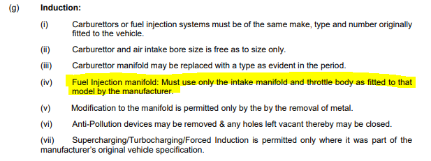

Administrators gav240z Posted March 14, 2019 Administrators Posted March 14, 2019 1 hour ago, Brett240 said: yeah its the S30 shell. I think triple webers would still be better than the fuel injection, though thats against the rules anyway. suspect the FI is better than the dual carbies on 240/260s. I'm guessing you're restricted to the factory ECU? No aftermarket ECU's? Quote
Brett240 Posted March 14, 2019 Posted March 14, 2019 9 minutes ago, gav240z said: I'm guessing you're restricted to the factory ECU? No aftermarket ECU's? yes, Bosch jetronic i think ( someone correct me if im wrong ) which is functional , though the nissan throttle body and intake is not as good as a triple weber setup. it still punches out good power, though we are short on most of the 3 litre Porsches, especially at 2.8 litres. the top 4-5 porsches have significantly more grunt, after that its a little more even. Quote
OdinZ Posted March 15, 2019 Posted March 15, 2019 18 hours ago, Brett240 said: speaking of.... race 5 view from the datto, you can see the advantage the vette's and panteras have on open circuits ( especially over us ).... Bathurst/PI they have it over the top porsches. I think the porches will still clean up at eastern creek and any smaller track. Great start! Damn that Porsche was so skiddish.....I assume that is the same one that spun out too Quote
PZG302 Posted March 15, 2019 Posted March 15, 2019 17 hours ago, Brett240 said: yes, Bosch jetronic i think ( someone correct me if im wrong ) which is functional , though the nissan throttle body and intake is not as good as a triple weber setup. it still punches out good power, though we are short on most of the 3 litre Porsches, especially at 2.8 litres. the top 4-5 porsches have significantly more grunt, after that its a little more even. Yes but there are few tweaks that can be done and there are a few different throttle bodies that can be used and also inlet manifolds. My green car ran a standard jetronic computer for a couple of seasons before changing over to the Haltech F9 when it was the gun computer. The guys that played with mine discovered a way to double pulse the injectors so it thought it was running teh V12 XJS Jag that that computer was also used on. There a few other ways to get more fuel out of the jetronic computer, such as dropping resistors, that I have no idea about, but those smarter than me do. The throttle body I used was from a L20 turbo I believe, all I know is it was a period Datsun throttle body and only a couple of mm shy of the XF throttle body size that was the popular swap back in the day. The inlet manifold I used was an N47, IIRC, very different in shape the ADM L28 manifolds in the runners and also the overall casting was very different. I have only seen my manifold and one other in my travels, but it still seemed to be a better thing than what could be done within the rules to the standard manifold. gav240z 1 Quote
