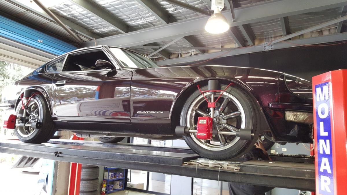

my_mad_z Posted February 29, 2016 Share Posted February 29, 2016 Gents, while I appreciated the advice, I couldn't let this go. I managed to score three new Rota RB's for $350 - long story short, the guy didn't have the 4th wheel. I ordered a pair from Rota and received a phone call two days later saying they had no stock.... was trying to get it all ready for Classic Japan last year but that didn't work out. After doing a lot of measuring and having a lot of doubts from the replies I got, I decided to bite the bullet anyway and order the RBR's - I'm glad I did! I ended up doing a staggered fitment; 17 x 7.5 +20 for the front (and a spare) and 17 x 8.5 +4 for the rear... and they fit. These will definitely not fit on a standard 240Z; with the changes I've made to my suspension, they just fit. My car is lowered (not as low as it use to be prior to getting a canary) and the rear doesn't rub. I had to redo my suspension after getting the canary for the turbo setup not being engineered, so I thought I'd tuck it in as much as possible since I was going for an engineers certificate anyway. I haven't had to roll the lip on the rear, it is extremely close with a 225 tyre - if I went to a 235/245, would more than likely rub. Will try a 235 on the rear for the next set of tyres and see how it goes. I know not everyone is a fan of the Rota's and I can live with that; I'm happy with them Marc. Andrew_L26 1 Quote Link to comment Share on other sites More sharing options...

my_mad_z Posted February 29, 2016 Share Posted February 29, 2016 I agree with you, these won't fit on a standard 240Z, the original question wasn't mine. I supplied measurements/clearances in my post that I took from my car and was asking if the 8.5 +4 would fit based on my measurements/calculations. I did weld in 2nd hand wheel arches at the time I was doing rust repair - supplied by Waz from Z Works in Mordialloc; this was close to 14 years ago - not sure what they came off, could have been a 2 seater 260Z??? I think the fronts sit just right with the 7.5 +20's - they could come out another 5-10mm but seems to tuck in quite nice and fills the guard. I haven't tried the 8.5 on the front, happy with the way it is. Quote Link to comment Share on other sites More sharing options...

my_mad_z Posted February 29, 2016 Share Posted February 29, 2016 I think you're right Gavin; from memory, I only needed to replace the driver's side wheel arch and Waz gave me one, without telling me it was different. After tacking it in place, I stood behind the car and noticed that the wheel arch he gave me stuck out about half an inch more than the passenger side... I didn't have any other choice but to change the passenger side as Waz didn't have anything else to give me. I was so upset at the time having to cut out a wheel arch that had nothing wrong with it; worked out well all these years later I guess! I really can't recall but I don't think I told him the wrong side? There is a clear difference between the two d3coy! Quote Link to comment Share on other sites More sharing options...

my_mad_z Posted February 29, 2016 Share Posted February 29, 2016 Marc, your cars looking great. What colour is that?? Thanks dat240z.The colour is black cherry mica, off the VS HSV Senator. The cherry really pops in the sun; this is the only pic I could find on the PC I'm using but it shows a bit more of the cherry. mother240 1 Quote Link to comment Share on other sites More sharing options...
