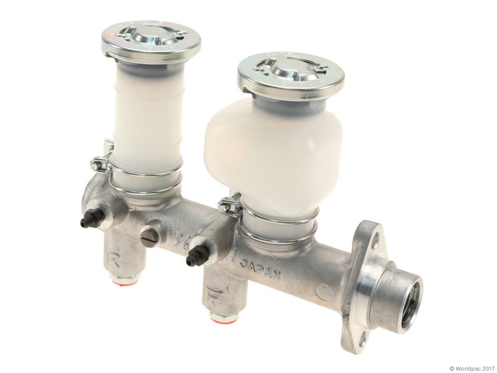

Linus Posted May 3, 2018 Posted May 3, 2018 Hey I've read that bleeding the brakes on a 260z can be a bit of a hassle. I have put a brand new master cylinder on and some new hard lines but it does not want to bleed out of the master cylinder? No fluid comes out the bleed nipples on master at all? Quote

Agno Posted May 4, 2018 Posted May 4, 2018 Instead of using your fingers I've done this in the past with good results: 1. Put two plastic tubes into the fluid reservoirs 2. Connect them to the bleed nipples on the side of the master (black nipples in top below photo) 2. Bolt master cylinder to booster, connect brake lines to master 3. Fill reservoirs 4. SLOWLY stroke the brake pedal until all the bubbles goes away (helpful to have a spotter here) 5. Bleed the rest of the system working from LR, RR, LF, RF (furthest brake to the nearest) PB260Z 1 Quote
