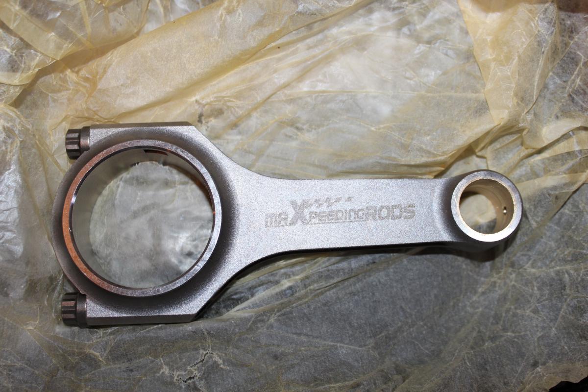

mossy Posted January 11, 2018 Posted January 11, 2018 (edited) New Maxspeeding L28 rods SOLD Edited April 24, 2018 by mossy Quote

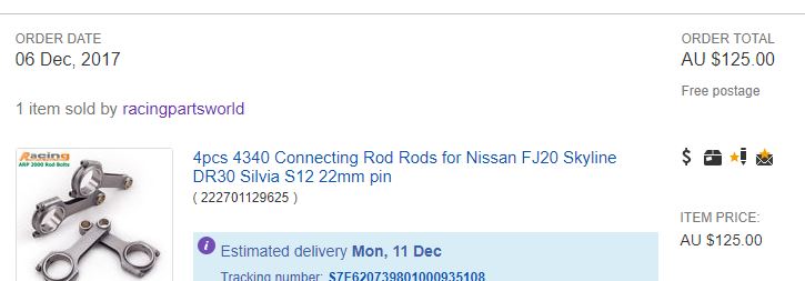

1600dave Posted January 17, 2018 Posted January 17, 2018 (edited) 140mm. Little end is 22mm rather than 21mm for L-series. And if you're really lucky, you may find a seller that will accept an epic lowball offer....... Edited January 17, 2018 by 1600dave gav240z 1 Quote
C.A.R. Posted January 17, 2018 Posted January 17, 2018 140mm. Little end is 22mm rather than 21mm for L-series. And if you're really lucky, you may find a seller that will accept an epic lowball offer..... LOL Dave! I bet you were surprised when they excepted! I hope the quality was OK...? FWIW the gudgeon pin size isn't an issue, as you'd just have the forged pistons made to suit. Quote
1600dave Posted January 17, 2018 Posted January 17, 2018 (edited) Surprised and then concerned that they were either dodgy rods or a dodgy seller. When they arrived, they turned out to be Maxspeeding rods, look quite good, weigh within half a gram of each other. And yep, they'll be teamed with custom pistons for a KA24DE headed L18 (or maybe L20) Edited January 17, 2018 by 1600dave Quote
240ZR Posted January 17, 2018 Posted January 17, 2018 I've tried FJ20 rods, they're too long which places the piston pin too high (good luck finding a piston that works) & too chunky around the journals, the block needs to be recessed quite a bit to allow the crank to turn. Quote
