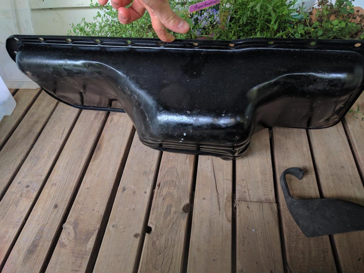

Andrew_L26 Posted May 28, 2017 Posted May 28, 2017 (edited) Do you mean a spare one? The only oil sump pickup I have is in the engine that is currently running in my car (Which is definitely not front, most likely rear, however it looks just a little forward of the rear). Yeah, I'm just after a pickup for the rear sump oil pans. Here is the "front sump" oil pan And here is the one that I want a pickup for (from an L20ET) Let me know if you decide to tear down the motor and don't need your rear sump pickup anymore haha Cheers, Andrew Edited May 28, 2017 by Andrew_L26 Quote
