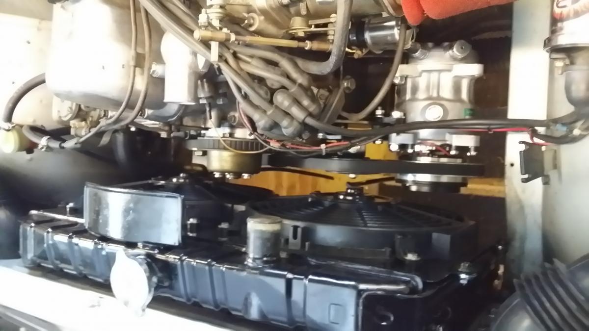

Gtv240z Posted May 3, 2017 Posted May 3, 2017 (edited) Hi Lance , I kitted my 240 out with AC a couple of summers ago. which compressor do you have, Diesel Kiki, Hitachi or something else? i think realistically you would have to throw away the whole bracket and pulley setup and get a new one from the USA or a later model L series powered car. The US companies mention fitting a Sanden Style compressor which is just a chinese version of a quality Japanese compressor. The chinese one would probably be ok but by the time you ship a cheap compressor from the US you may as well buy the best. I think i paid $450 for a Sanden compressor from Ashdown Ingram. The bracket i acquired randomly bolted to the L series engine but didn't have any pulley system so I welded up some bits and pieces to get it to work. If i was to do it again and didn't stumble across the random bracket i found . I think i would buy the bracket only from the US, get it here and source the rest locally . the US bracket has adjustment in it already. the Sanden Compressor is a SD7H15 these can run a cool room on a catering truck , are compact and look the part. I have attached a pic of mine Edited December 21, 2019 by Gtv240z Quote

lance240 Posted May 4, 2017 Author Posted May 4, 2017 Thanks for the advice guys. Car is in with auto electrician at the moment so I don't have brand of compressor that's coming out. He has sourced a Sanden style compressor but is chasing up contacts to have a bracket made up to fit. CraigZ - I liked the pic of yours. Do you know where your bracket came from (supplier/model)? I have an L28 in my engine bay cheers Quote
Gtv240z Posted May 4, 2017 Posted May 4, 2017 i noticed a 1980s bluebird at a wreckers once that was much simpler ,that would be my guess . al the other factory ones have these heavy cast things that are aweful. i have got plenty of those even an NOS one 280zx could be a possibility .... Quote
