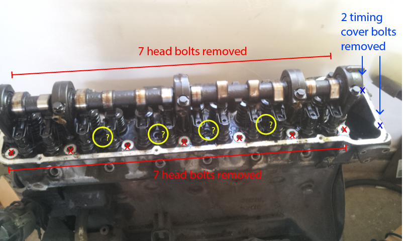

theremm Posted April 23, 2017 Author Posted April 23, 2017 Thanks Gav, Also double-check you've got all fasteners . So have I got everything? I grabbed this pic off the net however this is exactly as my head looks currently and my markup shows what I have removed. Not quite sure what the 4 hex bolts in the centre of the head are? Quote
600Z Posted April 23, 2017 Posted April 23, 2017 The four down the centre you have marked are just to block of galleries during the manufacturing. Quote

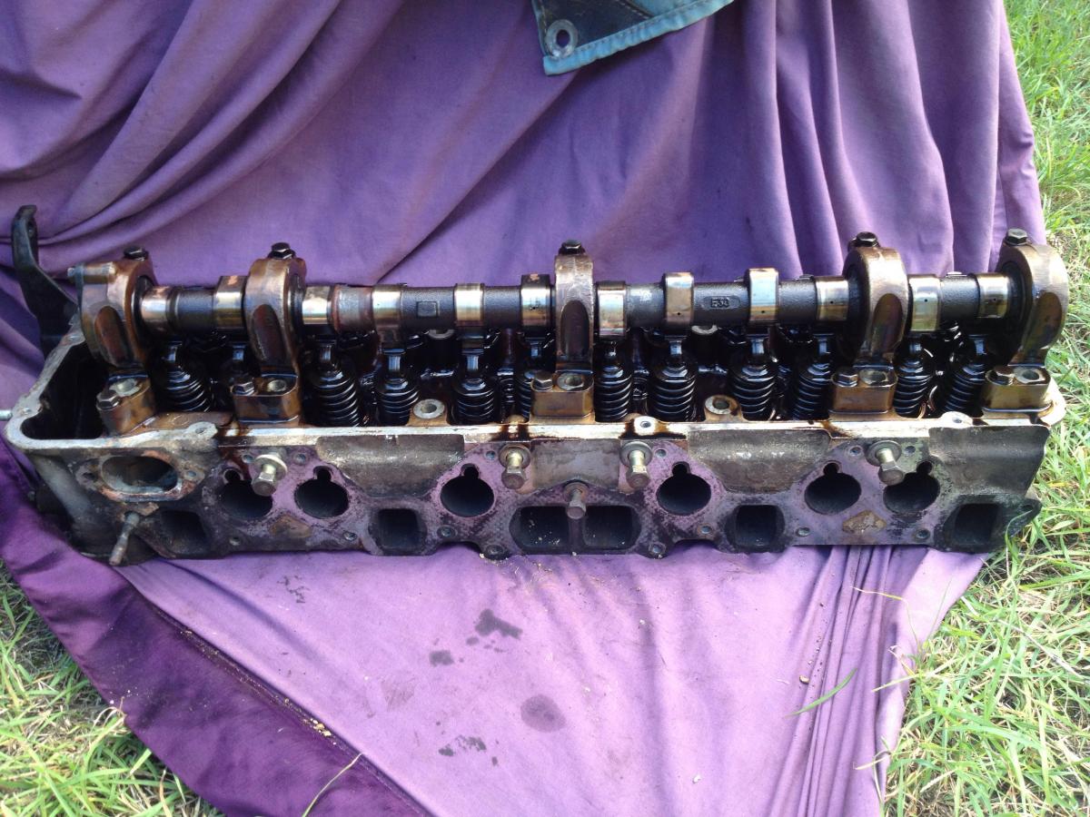

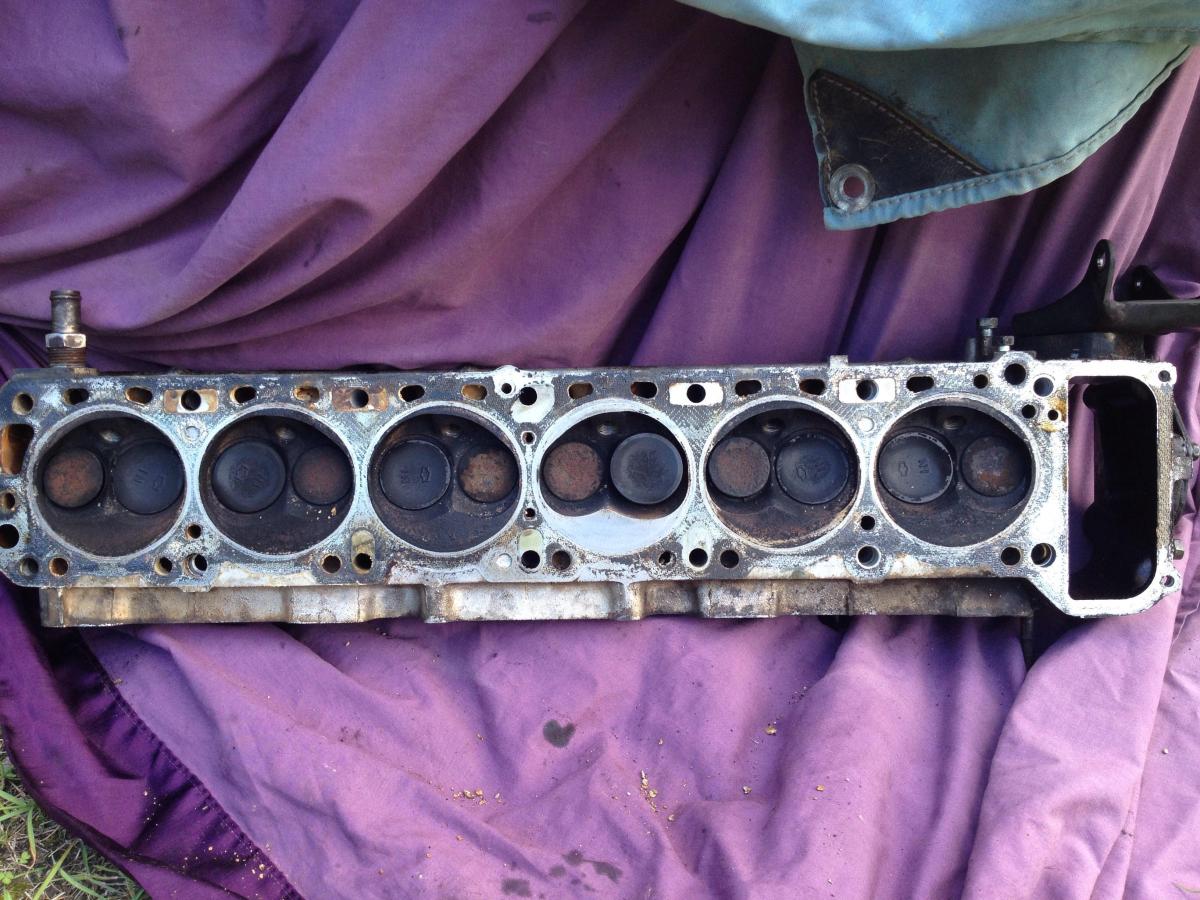

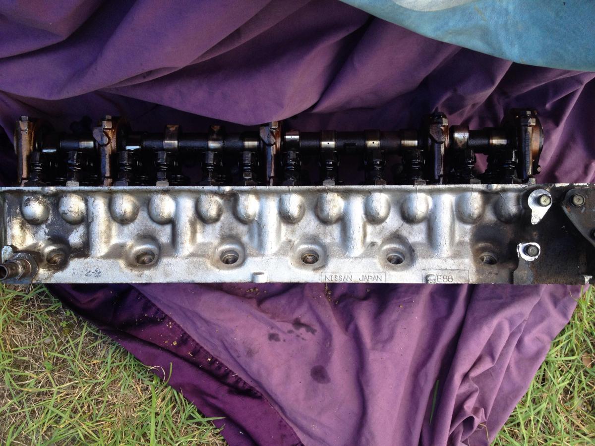

theremm Posted April 23, 2017 Author Posted April 23, 2017 Thanks everyone for all the help! A little more persistence with the rubber mallet at various points did the trick A special surprise underneath... E88 EFI head, woooot Wiped down chamber number 3 to show the shape nicely! gav240z 1 Quote
Administrators gav240z Posted April 23, 2017 Administrators Posted April 23, 2017 Lucky you, I would like 1 of these also for my 72 240z (to retain the original E88 code) but very hard to find now. Quote
