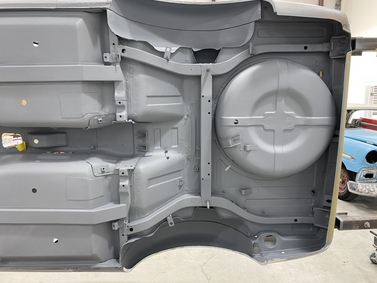

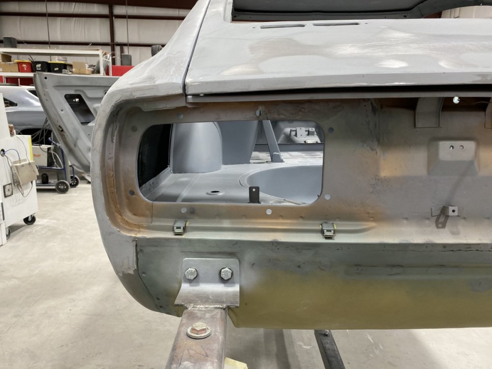

CBR Jeff Posted August 2, 2020 Posted August 2, 2020 The angle is to box in the end of the extended rail and support it onto the cross sub frame. Basically attempting to replace what has to be cut out without fouling the sway bar. Not to support the sway bar in anyway. Jeff Quote
dom Posted August 2, 2020 Author Posted August 2, 2020 The shop will be correcting based on the photo you shared, thanks Jeff. CBR Jeff 1 Quote

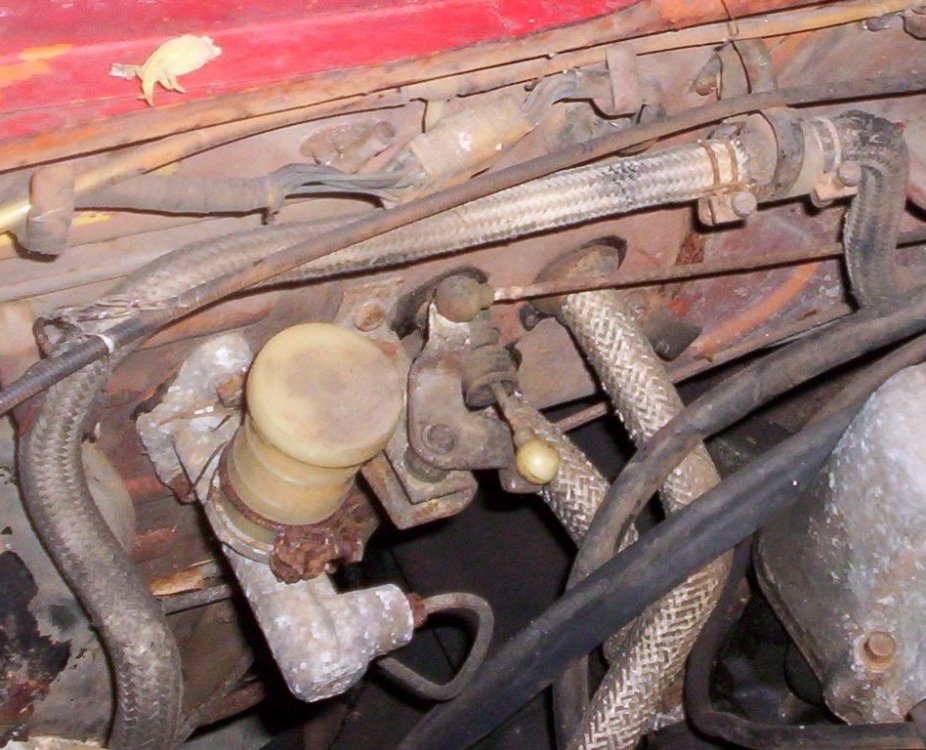

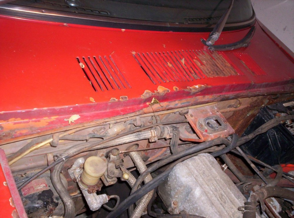

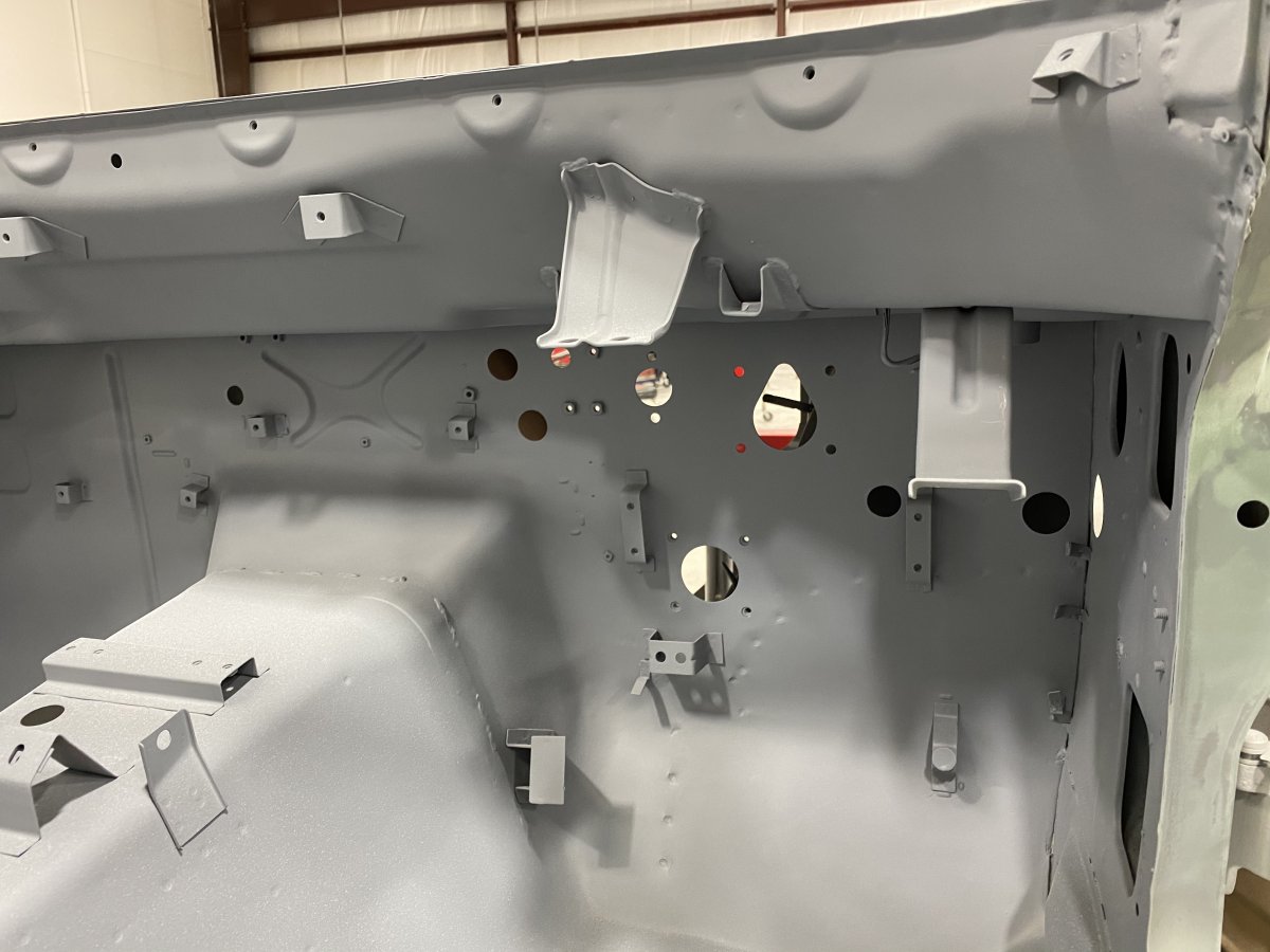

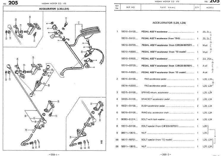

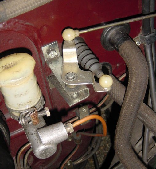

dom Posted August 3, 2020 Author Posted August 3, 2020 Thanks guys, I'm trying to do right by this car. In regards to the rear sway bar, should I be surprised to see rear brackets on an early S30? My understanding is those brackets started showing up on 73s but even those didn't always have a rear sway bar installed from the factory. Of course, a previous owner could have modified the car, but looking at some other Zs on Tea Valley's I noticed a 70 with the brackets in the same position as my car. One of my most pressing items to figure out is how the accelerator bracket mounts to the firewall. My car did not have one when I acquired it, I searched for a long while and finally came across one in Japan. I see the three mounting holes, but in all the photos I see of these brackets they don't appear to be bolted on, rather they seem to be spot welded? I'd like that detail to appear as factory as possible, so if anyone has insight on the correct way to handle that bracket I would be grateful. Reference photo from Tea Valley: Quote
HS30-H Posted August 3, 2020 Posted August 3, 2020 30 minutes ago, dom said: Thanks guys, I'm trying to do right by this car. In regards to the rear sway bar, should I be surprised to see rear brackets on an early S30? My understanding is those brackets started showing up on 73s but even those didn't always have a rear sway bar installed from the factory. Of course, a previous owner could have modified the car, but looking at some other Zs on Tea Valley's I noticed a 70 with the brackets in the same position as my car. One of my most pressing items to figure out is how the accelerator bracket mounts to the firewall. My car did not have one when I acquired it, I searched for a long while and finally came across one in Japan. I see the three mounting holes, but in all the photos I see of these brackets they don't appear to be bolted on, rather they seem to be spot welded? I'd like that detail to appear as factory as possible, so if anyone has insight on the correct way to handle that bracket I would be grateful. Reference photo from Tea Valley: Two points here: First of all, your car is a 'Fairlady Z-L' model. Nissan called it a 'Deluxe' model and in their internal shorthand for parts reference a 'ZDx' and/or just 'ZL'. This model had the rear anti roll bar as stock equipment from the beginning of production in 1969, so the mounts on your car are correct. Second point: Please take care when looking at references. Yes, your car is a Fairlady Z-L so it already has some unique features not seen on RHD Export models, but equally importantly it is EARLY production, and that means it has some quirks peculiar to early production. The above photo is an example of misleading reference material. Its a much later car than yours. I'll see if I can find a better reference photo for the bolt-on accelerator linkage pivot that your car should have. Stand by. CBR Jeff and gilltech 2 Quote
HS30-H Posted August 3, 2020 Posted August 3, 2020 Just now, HS30-H said: I'll see if I can find a better reference photo for the bolt-on accelerator linkage pivot that your car should have. Stand by. CBR Jeff and gilltech 2 Quote

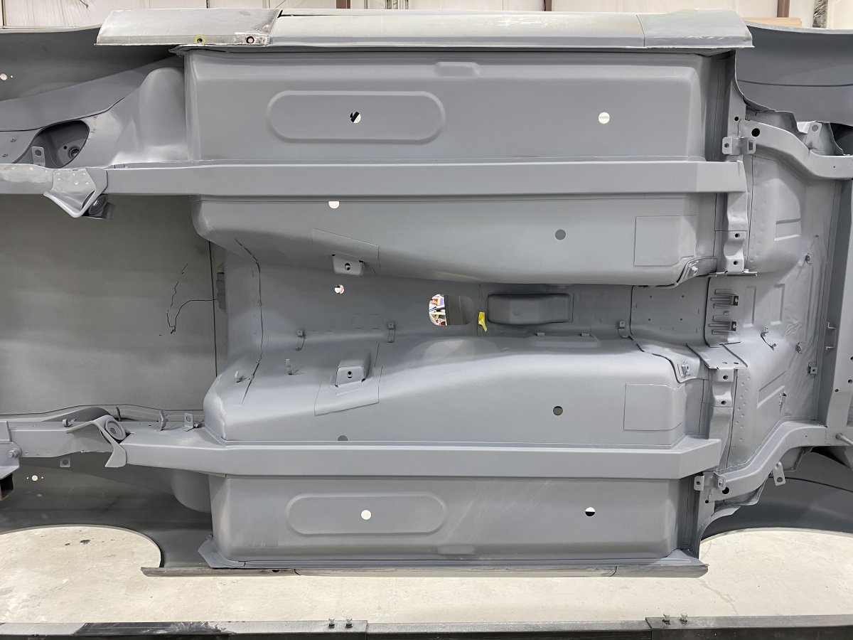

HS30-H Posted August 3, 2020 Posted August 3, 2020 20 minutes ago, dom said: Some photos of the progress: Are the original floor pan sections still at hand? Reason I ask is that they might have had the passenger foot rest doubler mounts spotwelded to the passenger floor. Being an early production car it might not have had them (initially they were an extra cost showroom option) but it is worth checking if they might have been missed. Quote
dom Posted August 3, 2020 Author Posted August 3, 2020 Wow, great tip on the accelerator bracket, the version I found in Japan has the bolt holes so maybe I got super lucky there? I'll send some shots of it a little later, struggling to find photos at the moment. Unfortunately the floors were in very rough shape when I got the car, it kills me that the footrest indentations/holes weren't there to save. I'm looking to find the factory location for where the footrest mounts. I do have one (somewhere in the garage) but I'm not 100% sure it came with my car, it's also in quite poor shape so I'll need to find another one most likely. Quote
dom Posted August 4, 2020 Author Posted August 4, 2020 (edited) I asked the shop to take a photo of the bracket, here’s the back: I’m missing most of the linkage components and a lot of the pedal assembly parts as well. Not the end of the world, but certainly an additional hurdle. Edited August 4, 2020 by dom Quote

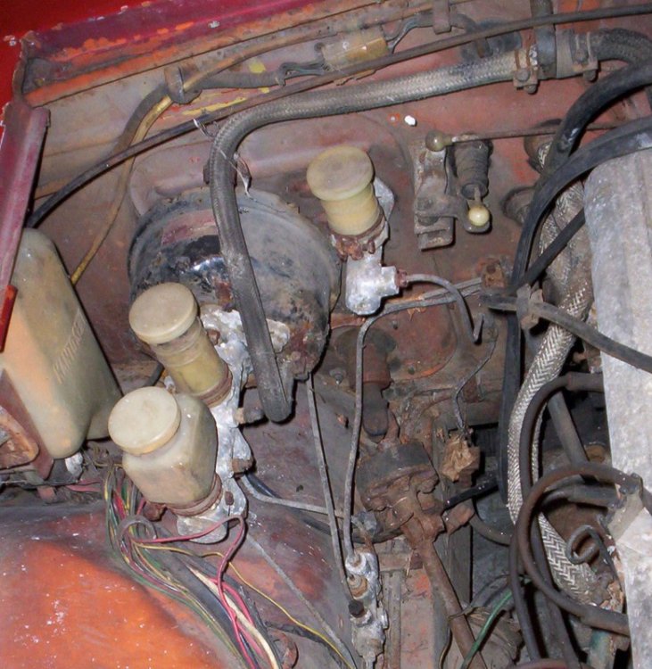

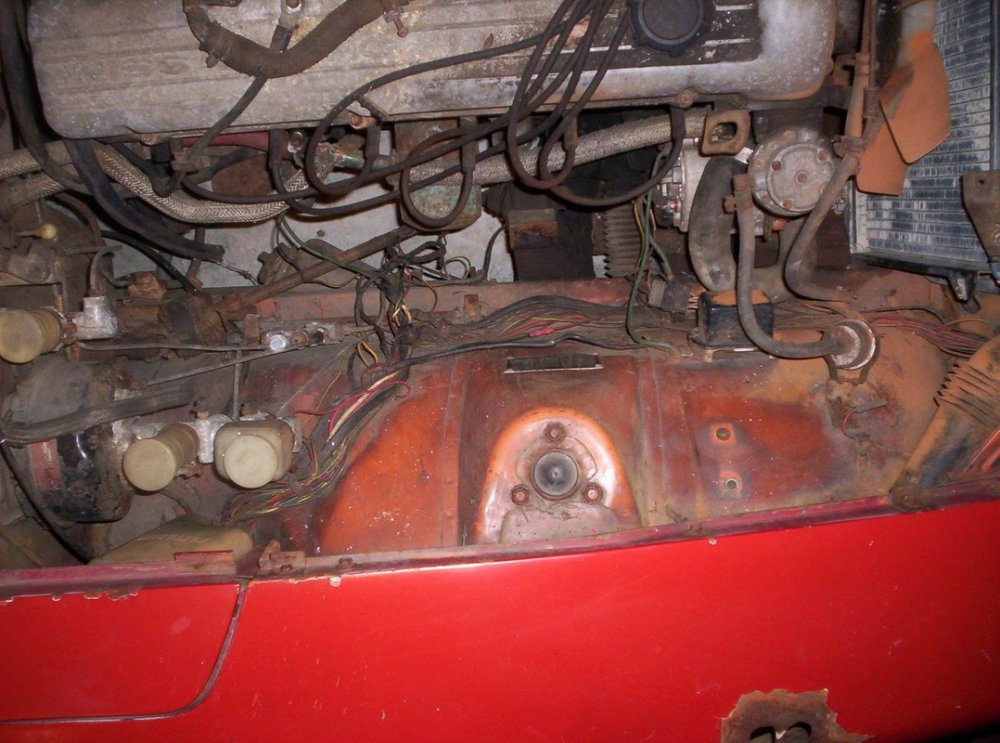

Bleach Posted August 4, 2020 Posted August 4, 2020 I don't know if this is needed, but I have some pictures of the car from the early days before the orange paint job. Quote
dom Posted August 4, 2020 Author Posted August 4, 2020 8 hours ago, Bleach said: I don't know if this is needed, but I have some pictures of the car from the early days before the orange paint job. This is great, thanks Bleach. When you disassembled the car, do you recall what happened to the many bits like the original throttle bracket? Did those items go with the car when you sold it? Quote
Bleach Posted August 4, 2020 Posted August 4, 2020 Sadly I left the engine removal and throttle cable removal to my body and paint guy. He did rust repair to the extent he was able to (and I could afford) and also the orange paint job. I received all the parts in boxes so it is very likely he just lost items and I had no idea they were gone. I never put the engine back in, and I included all the parts I had when I sold the car. I even included those brand new fender mirrors I bought from Nissan back in 2003. I was trying to be nice but now I wish I had kept them! Quote

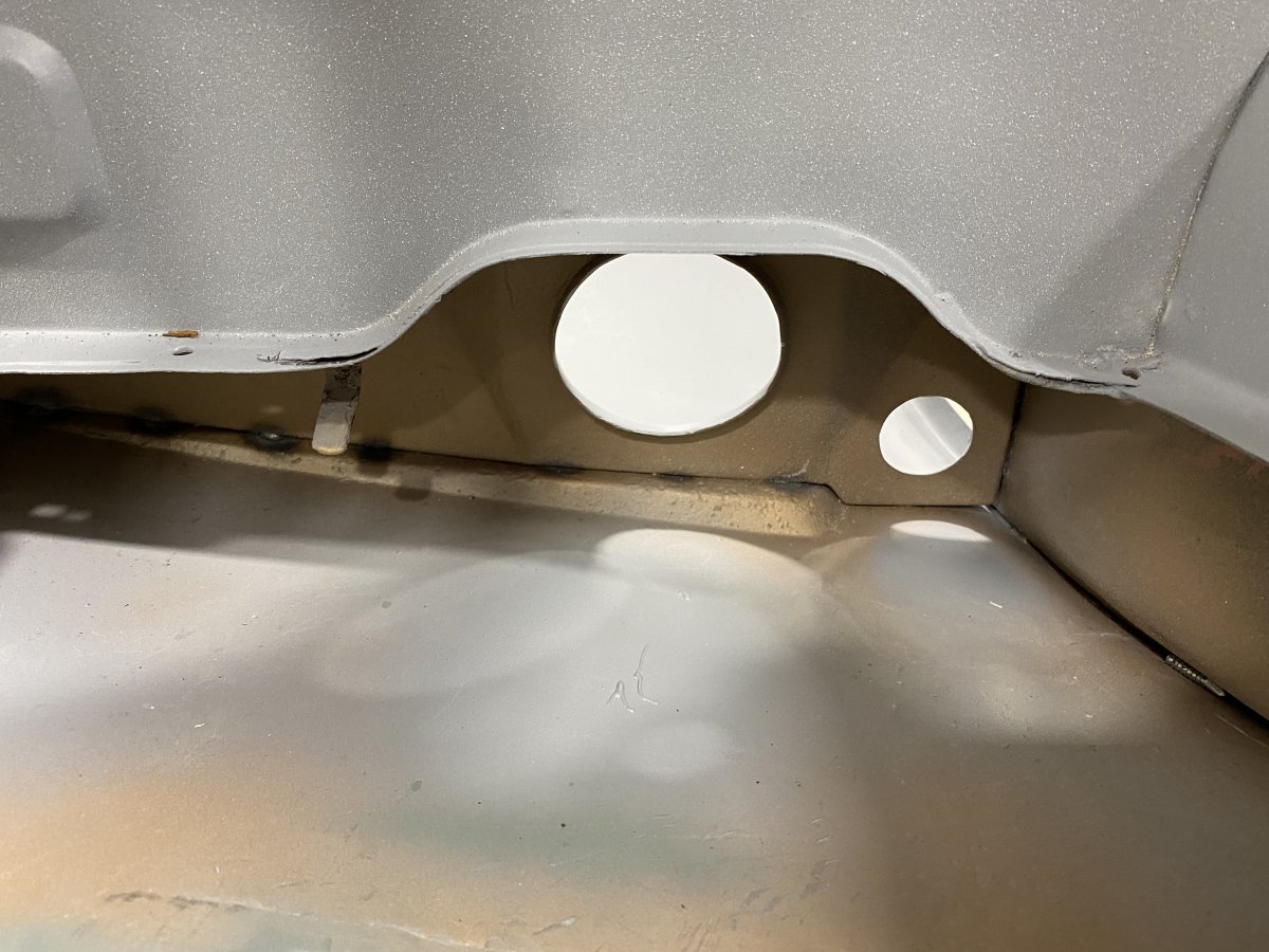

dom Posted August 28, 2020 Author Posted August 28, 2020 Work continues. Spoiler mounted and frame rails adjusted to make room for sway bar. Next up is figuring out the exact locations for where to drill on the rear inner deck lid panel, for mounting the taillight panel and license plate lamp. I don’t suppose anyone is aware of measurements/templates for that. Trying to be as close to factory as I can. Ponyo240z and CBR Jeff 2 Quote

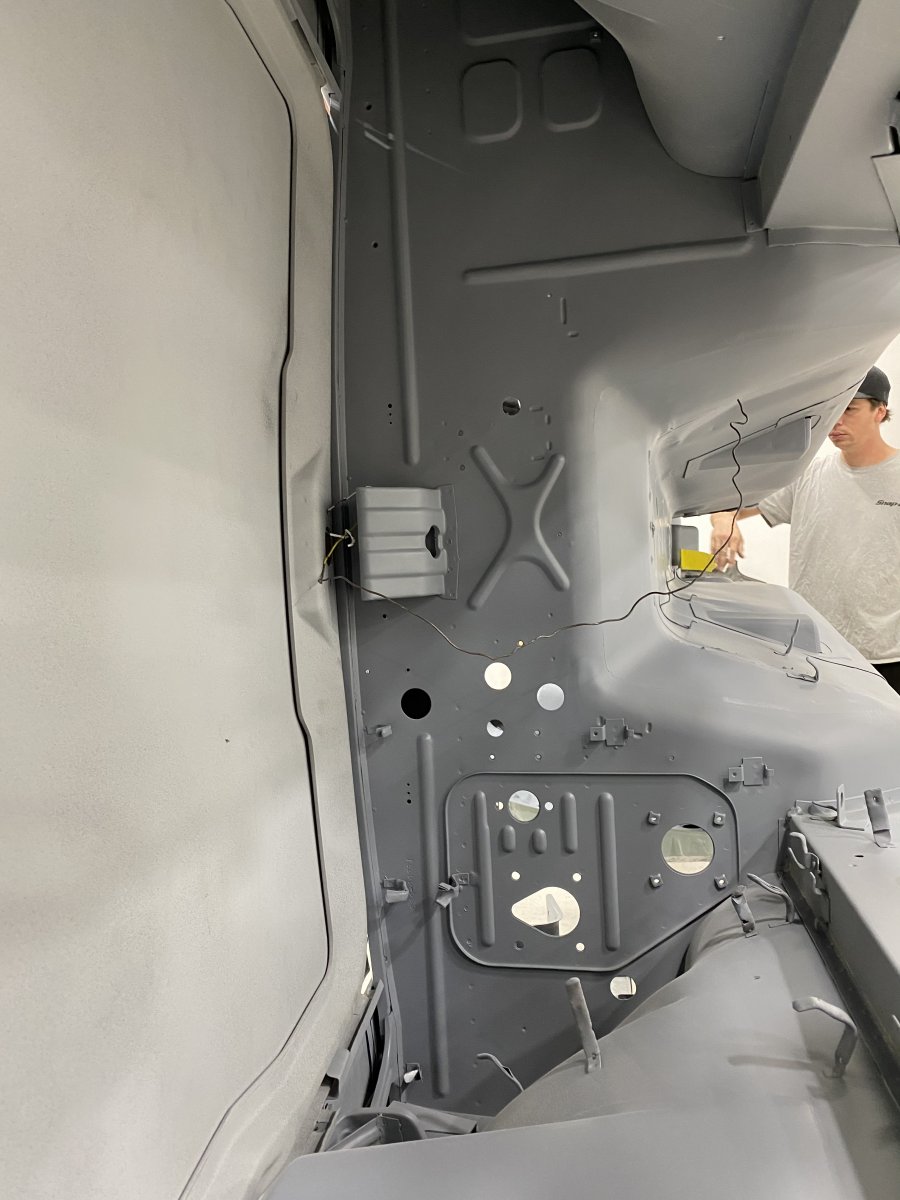

dom Posted January 27, 2021 Author Posted January 27, 2021 (edited) Nearing primer, but a spare piece of the body (perhaps?) remains and I'm not sure where it belongs, if at all. Does this look familiar to anyone? EDIT - Looks like this is for mounting the washer reservoir, which my car at one point had two (as pointed out by Alan previously) and that has since been addressed, so this piece most likely came from the left side mount that was removed. Edited January 27, 2021 by dom Quote
HS30-H Posted January 27, 2021 Posted January 27, 2021 That's the windscreen washer bottle mount. Location is under the inspection flap on the opposite side to the battery. Quote
