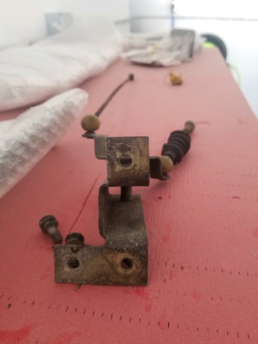

I asked the shop to take a photo of the bracket, here’s the back: I’m missing most of the linkage components and a lot of the pedal assembly parts as well. Not the end of the world, but certainly an additional hurdle. -

Wow, great tip on the accelerator bracket, the version I found in Japan has the bolt holes so maybe I got super lucky there? I'll send some shots of it a little later, struggling to find photos at the moment. Unfortunately the floors were in very rough shape when I got the car, it kills me that the footrest indentations/holes weren't there to save. I'm looking to find the factory location for where the footrest mounts. I do have one (somewhere in the garage) but I'm not 100% sure it came with my car, it's also in quite poor shape so I'll need to find another one most likely. -

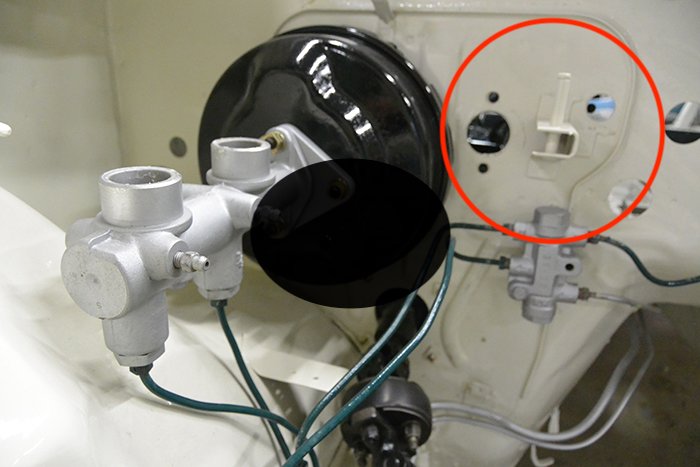

Ha, great catch, you described it exactly. The top left wing panel was pretty rotted out, don’t know how I didn’t catch the washer bottle mount. I’m going to see the car in person tomorrow morning, if it’s ok with you I would love to get your eyes on some details before it gets primer applied. I have so many questions/details to figure out, I’m doing my reading but I hope I won’t be a bother asking some questions here pretty soon. As always Alan, your insight and knowledge is unequaled, thank you for catching what could have been an expensive headache. -
Hello From California, Early S30 Restore
dom replied to dom's topic in Introductions and Forum Etiquette
Thanks Alan, is there anything I should be concerned about? I’ve noticed other cars don’t have those exposed sections on the top (in your red boxes) is this something unique to earlier cars, or does it need to be corrected?
