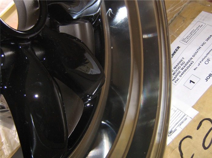

Just thought I might get you guys to celebrate with me! My wheels arrived today from the U.S and now I'm busting to get them on.  Any recommendations you guys might have for tyres would be a bonus as this is my first job come Monday morning!  The best thing is I'll have them on for the P.I cruise.

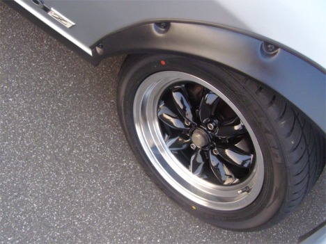

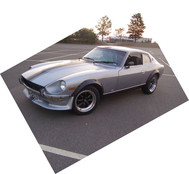

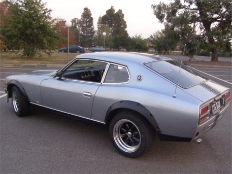

Hi Guys, well they're on! and they're awesome, not only am I happy with the look but it feels like I've got way better handling, can't wait to give it a good run on the P.I cruise.  Next week it goes in to have lowered king springs fitted which will help fill her out a bit more.
