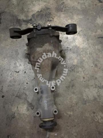

locklock Posted July 2, 2016 Posted July 2, 2016 Found one wrx sti v8.5 differential for sale. But seller doesnt know the specs and only know it came out from a wrx sti 2.0 6 gears. I did a search on that particular car, doesnt have any info on the differential ratio or lsd. Does all wrx sti comes with stock lsd? And will this differential works for a 240z since it was for 6mt? Will attach some pictures. Quote
d3c0y Posted July 2, 2016 Posted July 2, 2016 Just pull the hat off and the ratio is stamped on the crown wheel. Also you can see what sort of LSD is in the diff by looking at the carrier. All STi rear diffs are LSD but there are three different types. I would be guessing it's a 3.9 with a suretrak centre (torque sensing). locklock 1 Quote
Cozza Posted July 2, 2016 Posted July 2, 2016 How can you tell what type of centre it has, how do they look different? Quote
locklock Posted July 2, 2016 Posted July 2, 2016 (edited) Thanks decoy, so which type of lsd is best and how to differenciate? Suretec or torsen? I think this diff is 4.11, as the seller told me was taken from ej20 engine car. And this is what i found on a subaru forum. Edited July 2, 2016 by locklock Quote
Mike260LW Posted July 2, 2016 Posted July 2, 2016 Subaru sti diff 3.9 lsd fits right into a 240z body? Or need modification? The Stewart Wilkins Motorsport modded stubby shafts for the Subaru diff don't have the Datsun R180 half shaft centre bolt fitting so you have to source R200 half shafts or another pair of R180 half shafts and change the inboard Uni flange for the outboard ones i.e. Outboard flanges both ends. I would steer clear of the viscous Subaru diffs and plump for a Torsen or clutch pack type; the latter being harder to find. locklock 1 Quote
