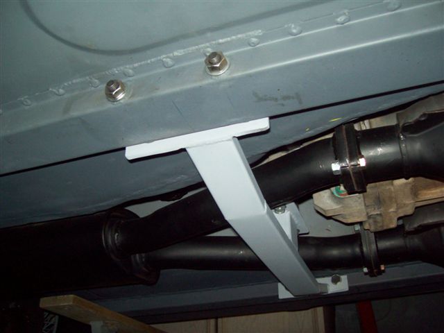

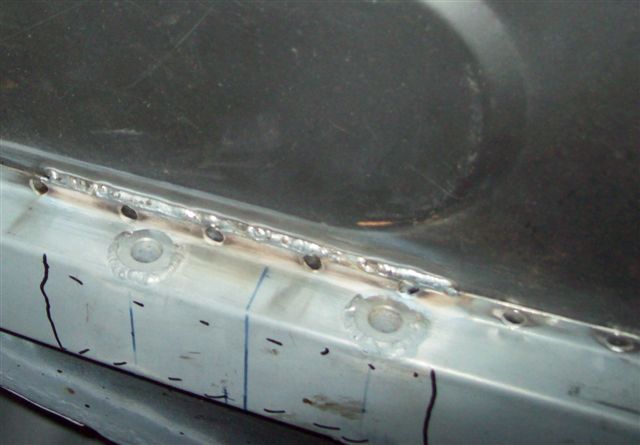

PeterAllen Posted May 27, 2016 Posted May 27, 2016 I don't know how you plan to fit the gearbox mount for the Rb26 but here is something I did for my LS1 install. Rather than use the common 'bolts through the floor' technique, I fitted some sleeves to the rails prior to their installation and have mounted the gearbox mount/cross-member off them. Quote
260DET Posted May 27, 2016 Posted May 27, 2016 Like that Peter, structurally ties the two rails together too, one piece that does two jobs is good engineering in my amateur book. Quote
mspecr Posted May 27, 2016 Author Posted May 27, 2016 Peter you where reading my mind , I just started brain wrenching on how I am going to tackle this and currently I have the following : 1 : McKinney Motorsports - Bolt in kit ( engine and gearbox ) link http://www.mckinneymotorsports.com/prod_240+260+280Z+parts 2 : CXracing - Bolt in kit ( engine, engine sump and gearbox ) link http://www.cxracing.com/mm5/merchant.mvc?Screen=PROD&Store_Code=CXR&Product_Code=ESK-OP-RB26-240Z&Category_Code=240Z 3 : Castlemain RodShop - Bolt in kit (engine and gearbox ) link http://www.rodshop.com.au/index.php/datsun/240z-260z/em081-nissan-engine-mounts.html 4 : Custom - Just like your brilliant example, I do like how your able to keep your twin pipes tucked well up in that tunnel. 5 : Custom v2 - Moving the original internal mounting frame, cut a section out and place it lower down the tunnel, mod the normal Rb / skyline to suit new location. Idea i found came from here. link http://www.zcar.com/forum/10-70-83-tech-discussion-forum/343874-my-260z-project-awaiting-rb25-2.html Comments i have thus so far on each of them. 1 . + Bolt on kit +/- Mild steel / power coated construction. +/- The have a sump to suit the RB on that same link, tailshafts, intercooler ect ect - Seen other threads of engine mounts failing, they look small to me. - I don't like how the Rb box is on more of a counter lever instead of being directly supported under it. 2 . + Bolt on kit plus sump ! + Loving that massive sump flange to keep the engine rigid, also this man Adam Hutchin made a good decent review on this sump with his thoughts and opinions https://www.youtube.com/watch?v=szlPTCeMrus +/- Most reviews I have read say there quite good with a few odd saying no.. +/- They sell other bits as well intercoolers, turbo kits exausts.. ect ect + Stainless Steel construction for engine mounts and gearbox. + Uses OEM RB gearbox mounts - Same as above with the McKinney, the gear box is counter levered, this seams to be the norm for a bolt in job thou by the looks of it, it is however a thick bent plate designed to take OEM mounts. 3 . + Bolt on kit +/- Don't have the Rb25 gearbox a ( FS5R30A ) listed on there website but can contact them about it. +/- Ha vent really found anything stating " how good / well " this particular kit is, Im sure some one has use them ?, feel free to chime in. 4. Looks easy and straight forward, supports directly under the gearbox where it needs to be and same time braces the inside chassis rail via crush tubes, what more can you ask for , The only question that comes to mind would be, the consulting engineer.. ( yet to find one ) would he /she accept this method ?. Reason being as i didn't list any body modifications in my application to DPI.. 5. Similar to question 4. body mod and DPI. Overall all of them need some sort of mod to fix / adjust / tune, just haven't decided yet. 260DET 1 Quote
260DET Posted May 27, 2016 Posted May 27, 2016 Using crush tubes to mount something big and solid is pretty common OE eg front X member to the chassis rails, S chassis diff mount. Can't see an engineer knocking that method of attachment back. Quote
