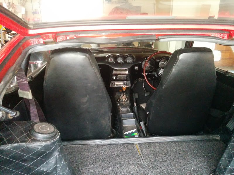

My 240z has been left in the sun and the dashboard was done before the year 2000 (previous owner had it done). I generally like to put a screen in the front window to protect from the sun if left parked outside and the car has been garaged for the past 7 years anyway, but the repair seems very good to me.
Any chance to show off my dash haha.
