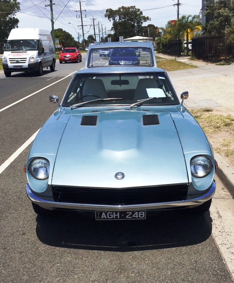

Iceberg Posted February 24, 2016 Author Posted February 24, 2016 Hi All, I though i put in a well deserved reply. Much appreciate everyone input. I have been postponing the replies as i hoped to restart the project without luck. I am so close to finishing it. The update is that she is registered and have been parked in the garage for 3 months now. Very sad but i am saving for a wedding and a bathroom renovation + nursery. Work is very bust and i am trying to get fit again. At least she looks reasonably good now and has plates. Do not know what to do to be honest. My daily also broke down yesterday on 40 degree day so i spent 4 hours by the side of the road waiting for RACV tow truck, money i had saved for the head repair went to the silly RACV sign up fee and towing and now there is not much left. I think i need to find a good head for her and just get her back on the road rather than fixing my daily. Anyone got one sitting around i sure would appreciate it for a fair price. Quote
